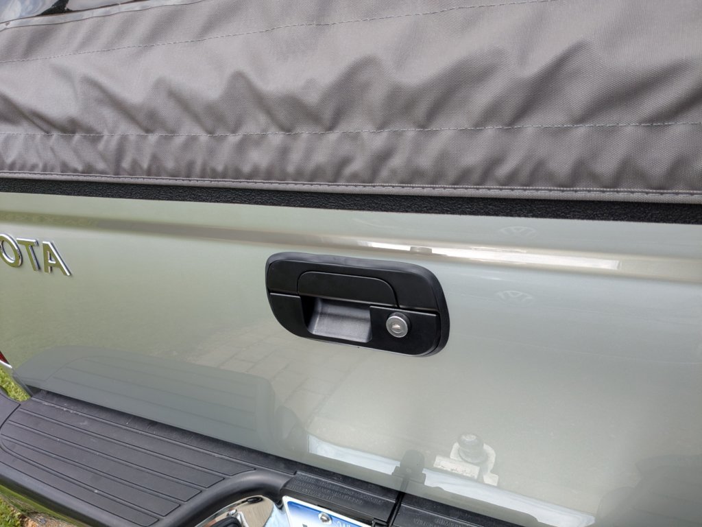

    Installed a Pop & Lock for my tailgate. Didn't like the idea of fingernails or gloves scraping the paint when going to open it so it adds a nice level of protection. For anyone installing one, would highly recommend adding some rubber weatherstripping behind the plastic that lays against the metal or filing the lips down, otherwise the plastic will dig into the paint. I took off the plastic ring that goes around the OEM handle and ran it along the edges of both and added a drainage hole at the bottom of the Pop & Lock so water doesn't build up behind it

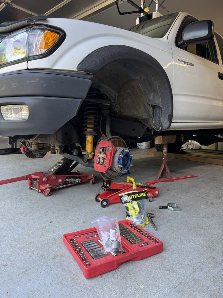

    LCA white line bushings going in along with new shock bushings. First time doing this job so I’m a little skeptical but luckily I have time on my side this time. It’s been a California truck most of its life I believe so I’m hoping that it shouldn’t fight me too much.. but I’ve been wrong before. Open to your words of wisdom for this project.

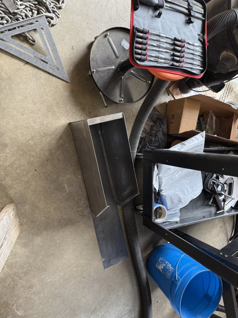

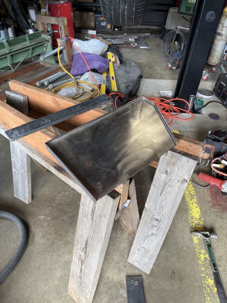

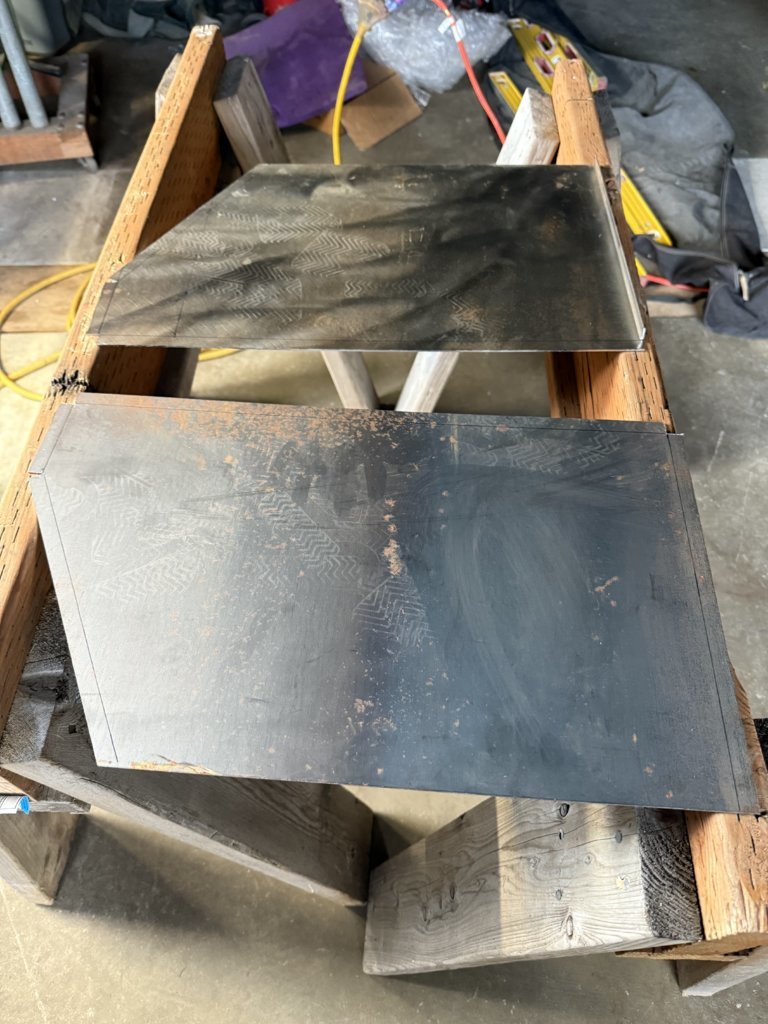

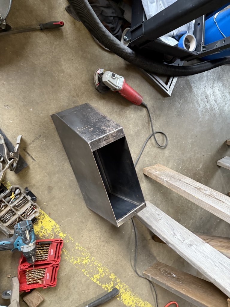

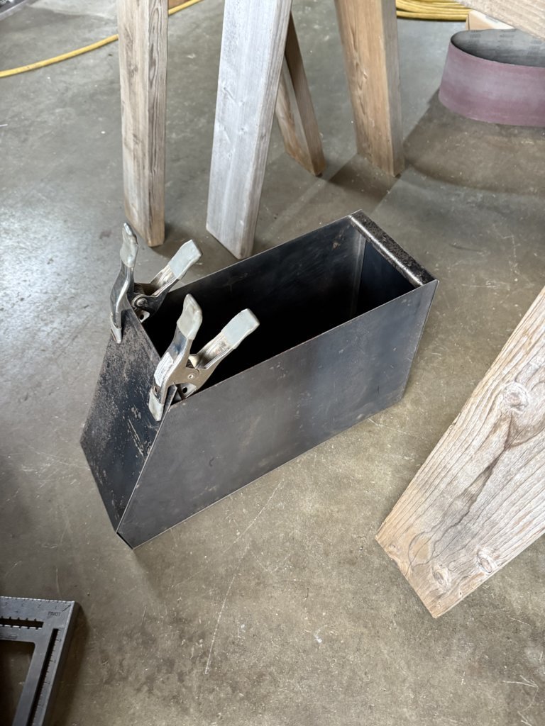

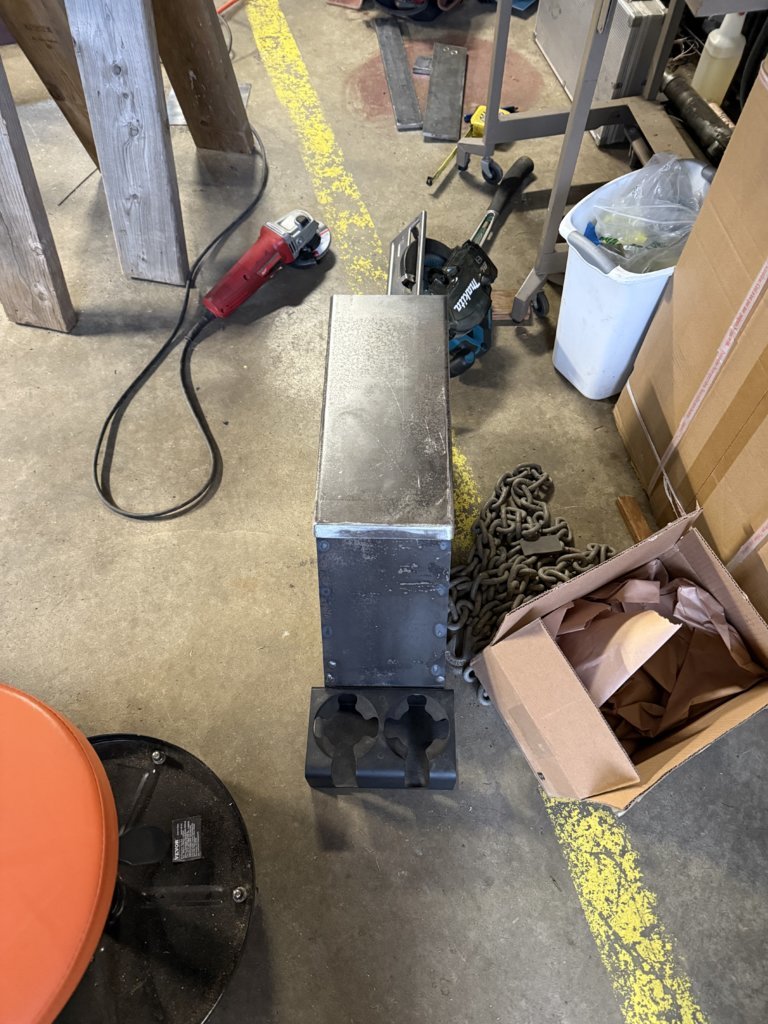

    IMG_4803.jpg IMG_4814.jpg IMG_4815.jpg IMG_4816.jpg IMG_4817.jpg IMG_4819.jpgDidn’t finish but progress made on my Tuffy center console knockoff

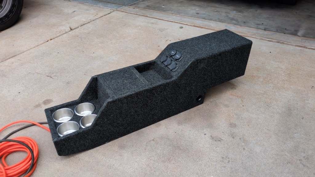

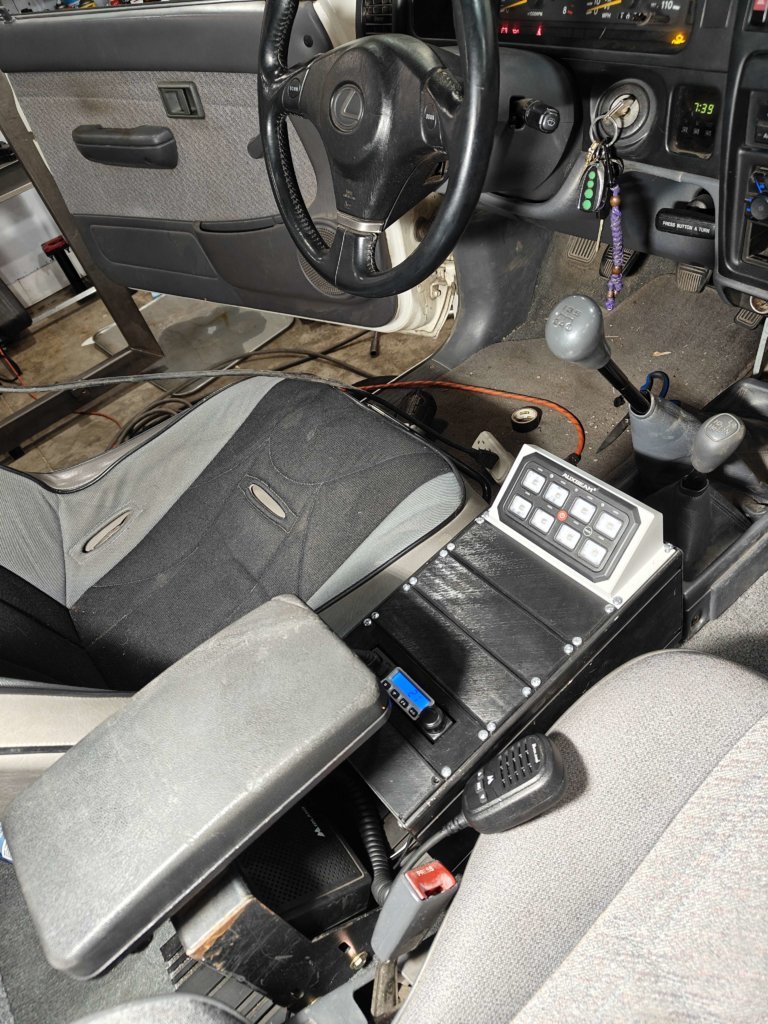

    Is the Tuffy no longer sold? Your version looks clean dude! I couldn't quite find what I was looking for either and instead cutdown and modified a police center console from Havis. Just been 3D printing faces for things

    Tuffy’s still around, I just didn’t want to pay $300. Had a bunch of 16 gauge sitting around, probably still be into it ~$100 including hardwares, paint, etc, might be hard to justify when my time is limited.
    It’ll be almost the same dimensions, even using a Tuffy lock and the cup holder.

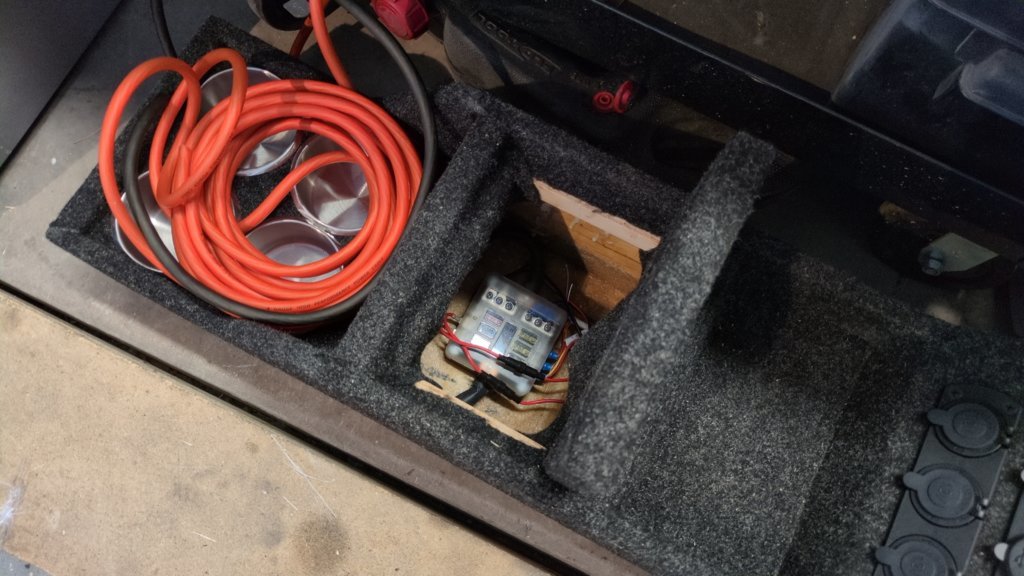

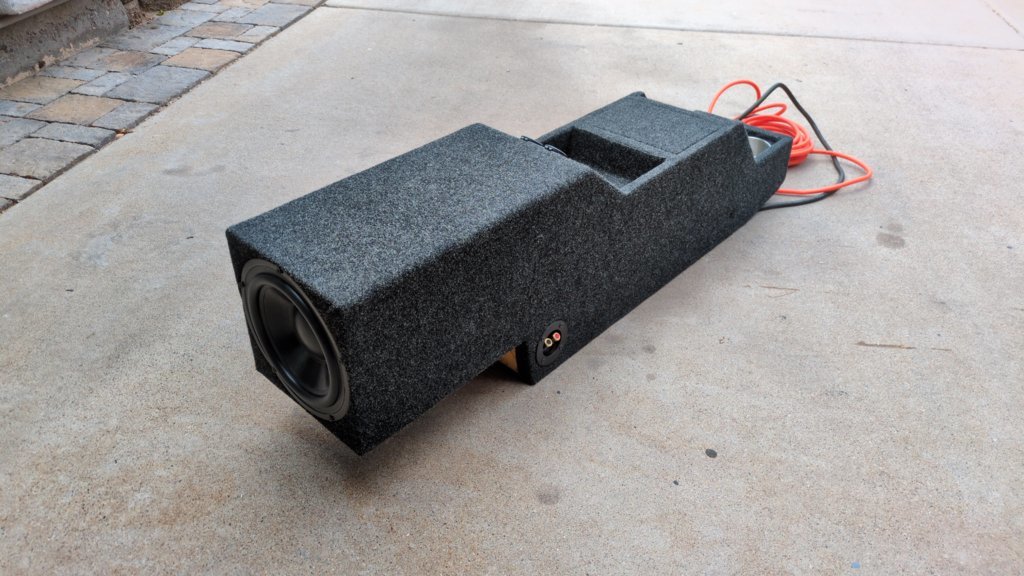

    Wrapping up the wiring for the new house battery.
    PRO TIP:
    Just because you build something that you want to fit into your truck cab doesn't mean that it will fit. o_O

    IMG_4838.jpgThere are…other options
