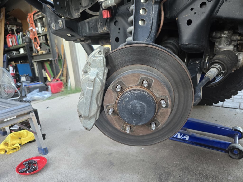

    No doubt. I'll be adding a paint marks too.
    Went for a drive to bed in the brakes and it drove nice and straight no more darting or weird pulling. The new brakes grab good too.

    Yes they were. It's possible that I forgot to put locktighte on them. The drives side was nice and tight still.

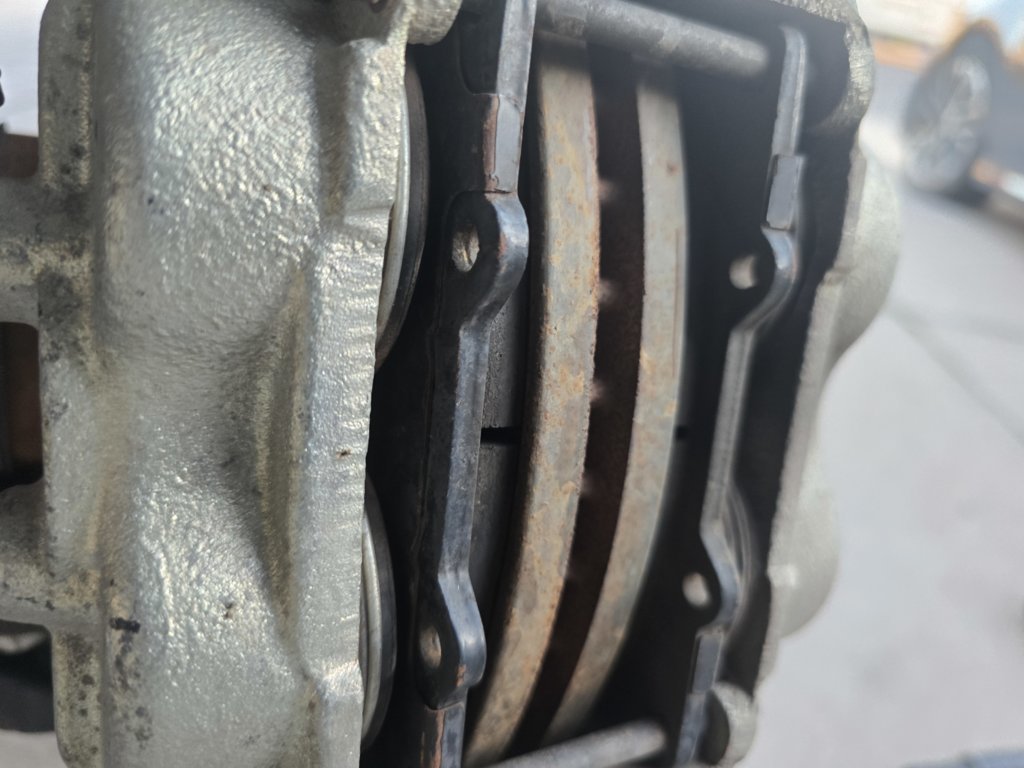

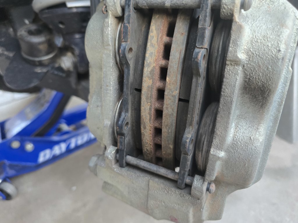

    So I have 13wl. Brakes. I had the Brembo andakebeno pads
    The new ones are power stop with there cermeric pads.
    Power Stop K2324 Front Z23 Carbon... https://www.amazon.com/dp/B005FL5XPQ?ref=ppx_pop_mob_ap_share
    I went into it thinking I might have had a sticky caliper. But the wear was really even. My pads sat below the rotors edge.
    Anyways when I was giving everything a once over is then I saw the loose lbj.

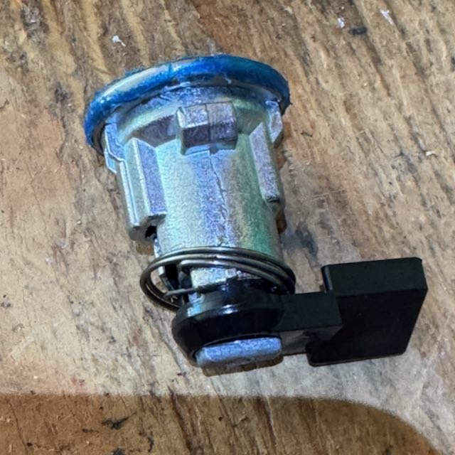

    Like with many of you, the fuel lid lock on my Taco failed last week when the little black thingy broke. Replacing the unit with OEM + re-keying it was stupid expensive, but I really wanted to have just one key to my truck. I bought this lock cylinder on eBay for $13.
    Looking at it in person, I realized I could pry off the spring and transplant the little black thingy on to my old lock cylinder. I cleaned up and lubricated the old cylinder, moved the spring and new black thingy over, then installed the assembly back in the lid. Unlocks now smoother than ever, all with my original key :) IMG_8601.jpg

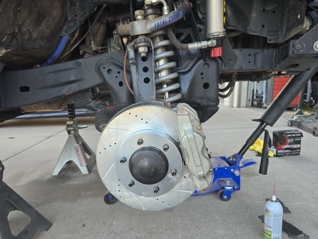

    Yeah, same, 13WL calipers, on like my 4th pair in probably 15years.
    Each set I bought were remans, can’t see why parts store calipers would be the issue, pretty simple system. First set was from Napa, each side froze in little more than a year, they wouldn’t honor the warranty, so went to Autozone/lifetime warranty, just swapped out whenever a boot tore, etc.
    I’ve flushed the fluid like clockwork every 30k, so not a maintenance issue, wheelers braided stainless lines front and rear
    Now got this brake pull issue, have an OEM seal kit, thinking I’m going to tear each side down and swap the seals and see if any of the pistons need replacing.
    Did you have brake pull as well? You mentioned sticky caliper.
    I’m not opposed to trying new rotors/pads like the Powerstop ones you got.

    That's crazy that you've gone though so many calipers. Mine are actual toyota factory calipers.
    So initially I was getting a scraping noise from my pads and rotors, the pads were sitting low on the rotor. So I was getting some weird handling and it ended up being one my lower ball joints .one bolt was missing a second one was 3/4ths of the way out and the other 2 were lose also. It was literally flopping around under the knuckle.
    New bolts, locktighted. Lol and it drives great no diving under braking. It stops a lot better now too. It really grabs without locking up.
    My calipers looked great and my pads wear was pretty even. They were hardly worn. Ive been running them for quite awhile. I wanna say like 7years. Let me dubbel check .maybe a little longer but not by much.
