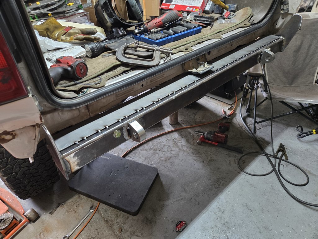

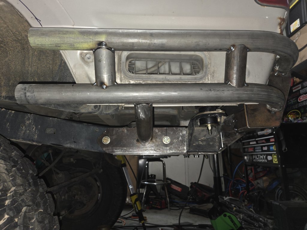

    Haven't posted much about what I've done to my 1st gen... cause I haven't done much to my 1st gen lately.
    But a 3rd gen 4Runner is close enough.

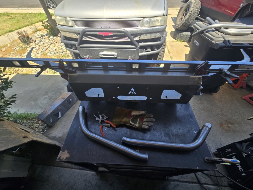

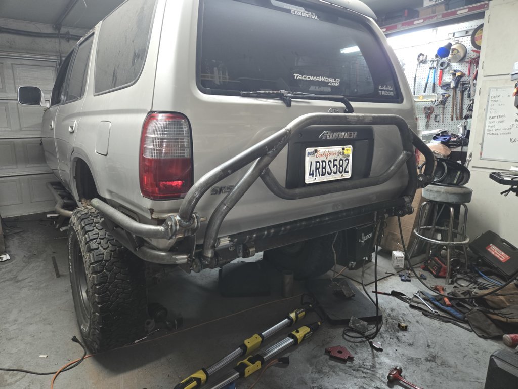

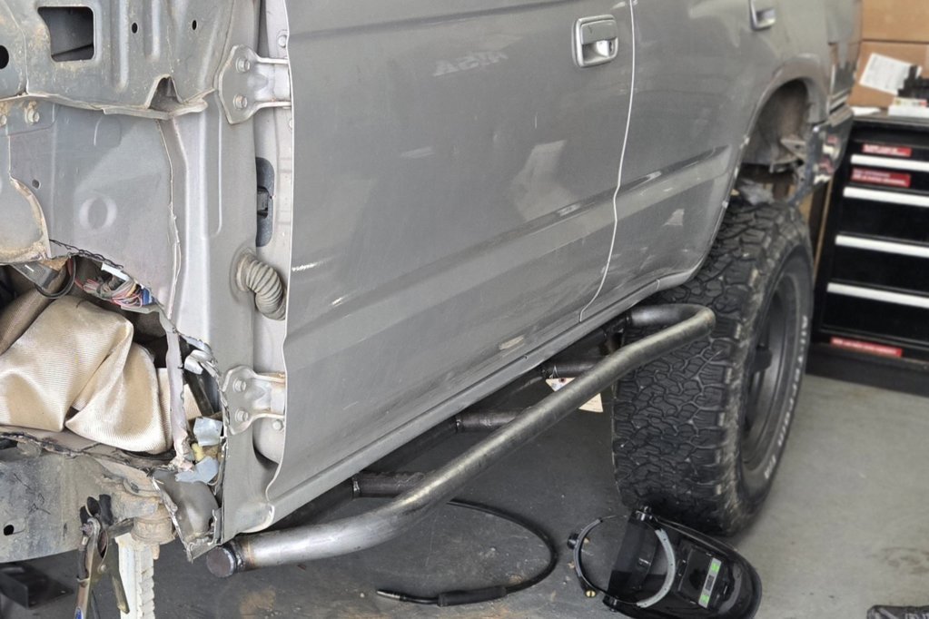

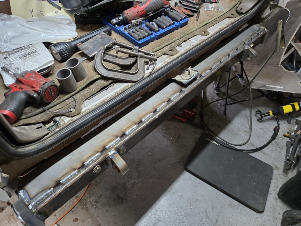

    Sliders

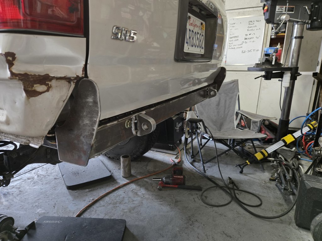

    Rear bumper
    20250407_125217.jpg 20250407_174616.jpg 20250407_182503.jpg 20250407_184018.jpg 20250410_202531.jpg 20250418_181413.jpg 20250427_132956.jpg 20250420_161628.jpg

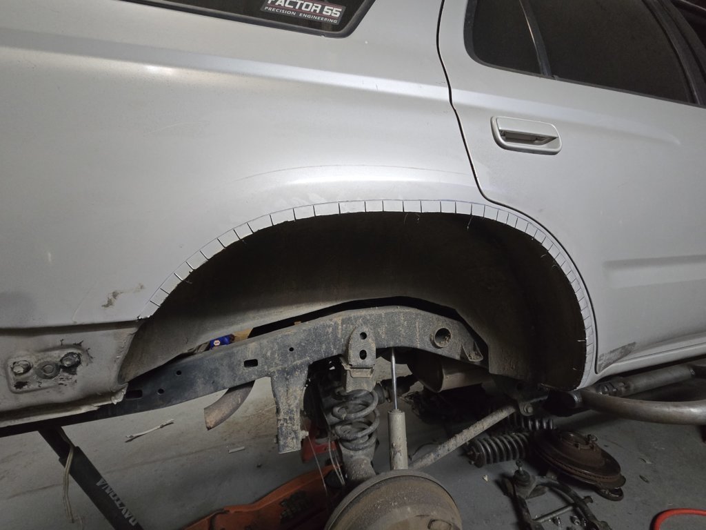

    Tire clearancing
    20250501_180933.jpg 20250519_195626.jpg 20250525_181555.jpg 20250518_211513.jpg 20250519_195643.jpg

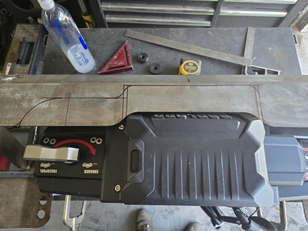

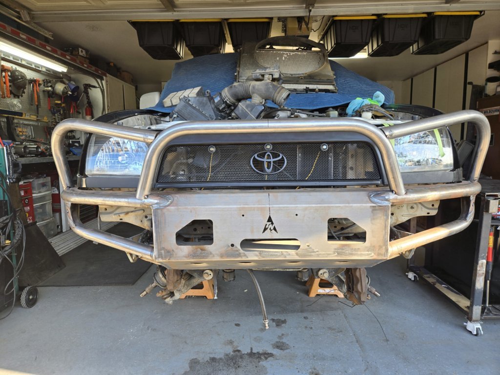

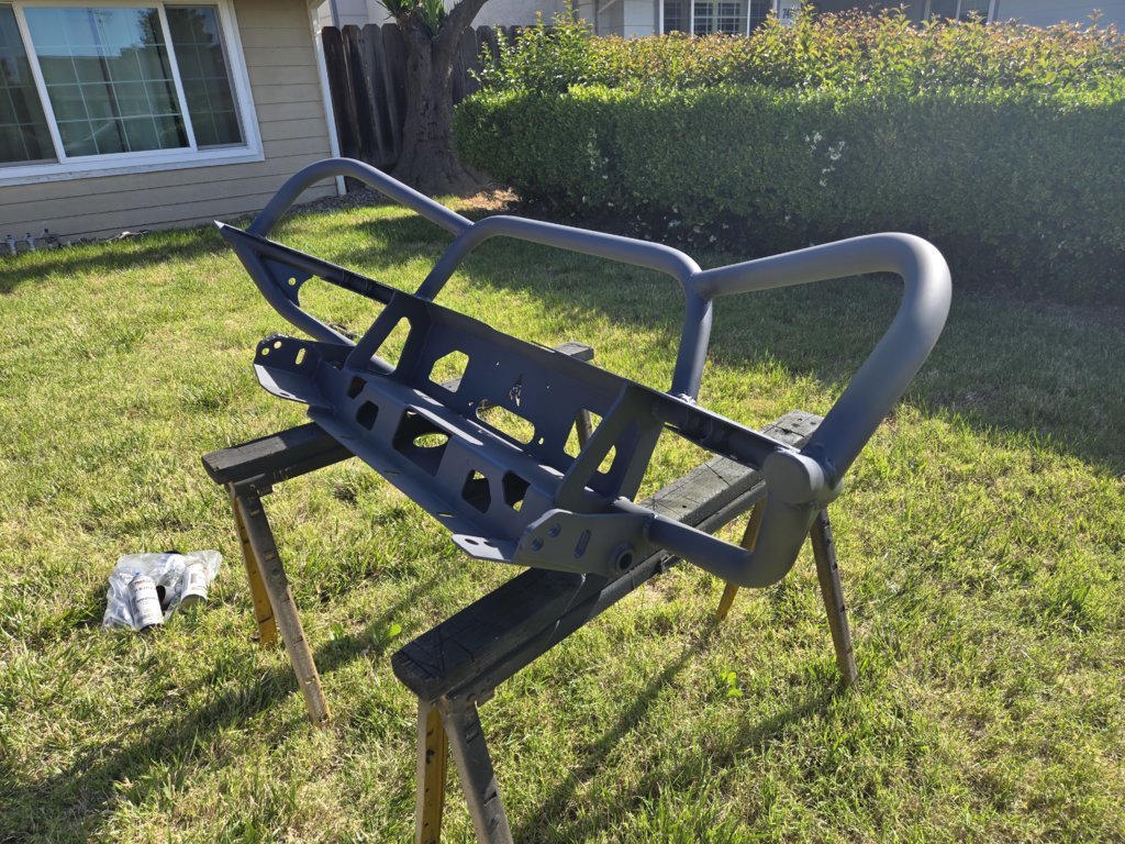

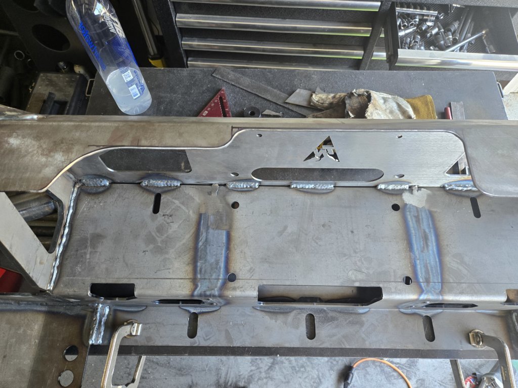

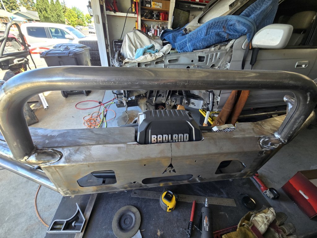

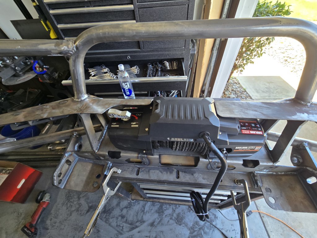

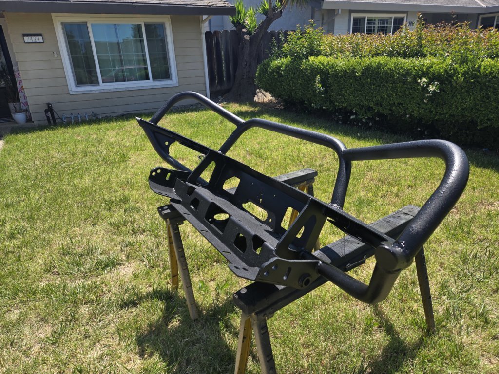

    Front bumper
    20250525_125109.jpg 20250525_131202.jpg 20250525_142115.jpg 20250525_142053.jpg 20250525_165732.jpg

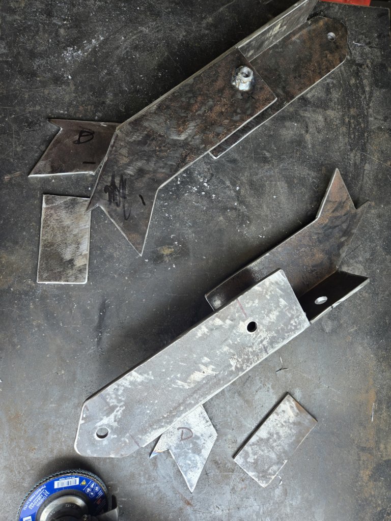

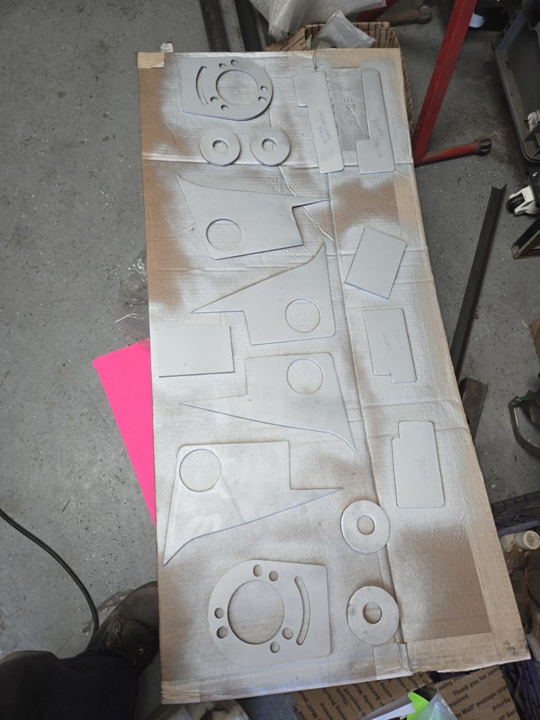

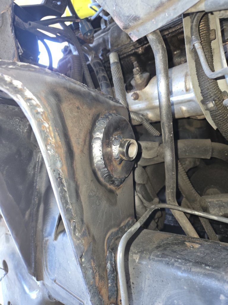

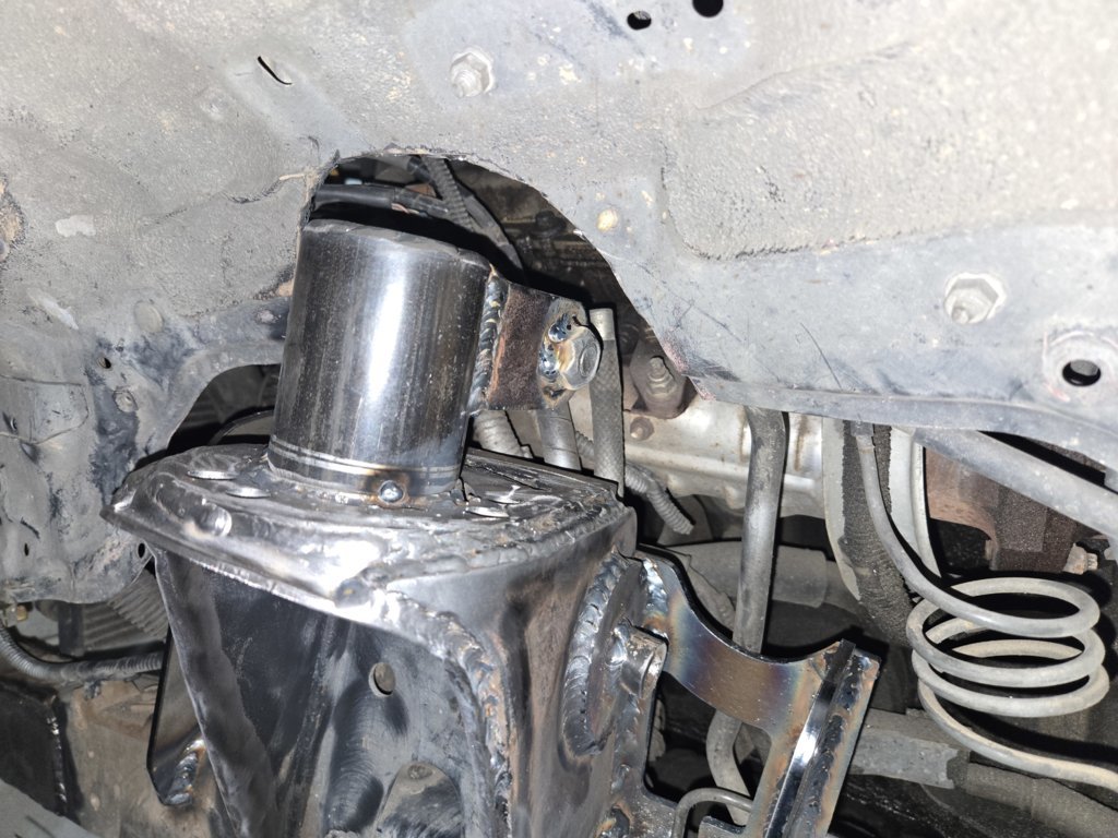

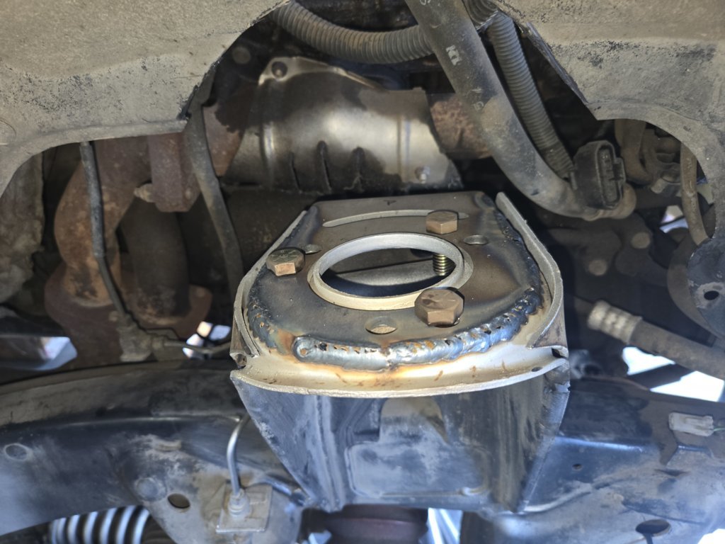

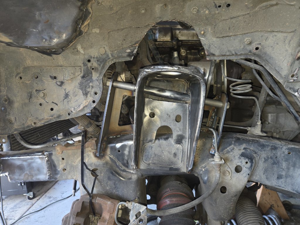

    Coil bucket reinforcement - and mounts to add a tower to tower cross over brace later.
    20250510_193848.jpg 20250511_112004.jpg 20250511_142624.jpg 20250511_164619.jpg 20250512_191901.jpg 20250516_142648.jpg

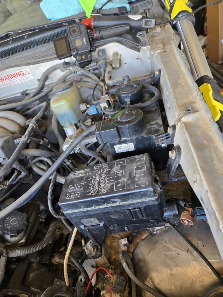

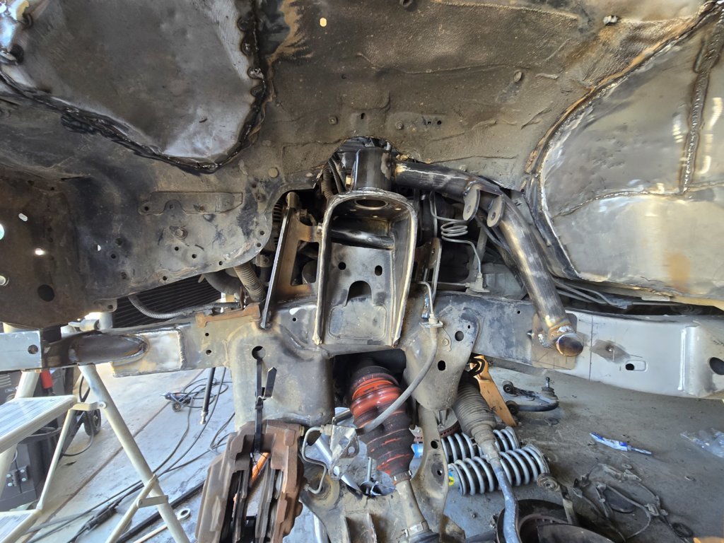

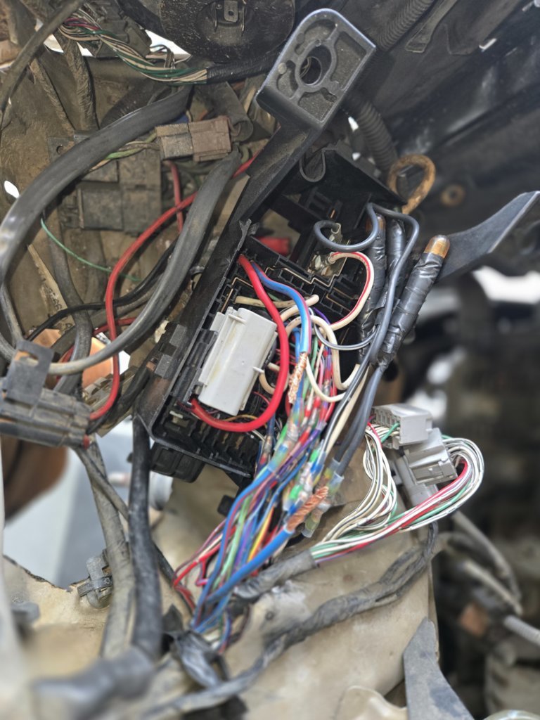

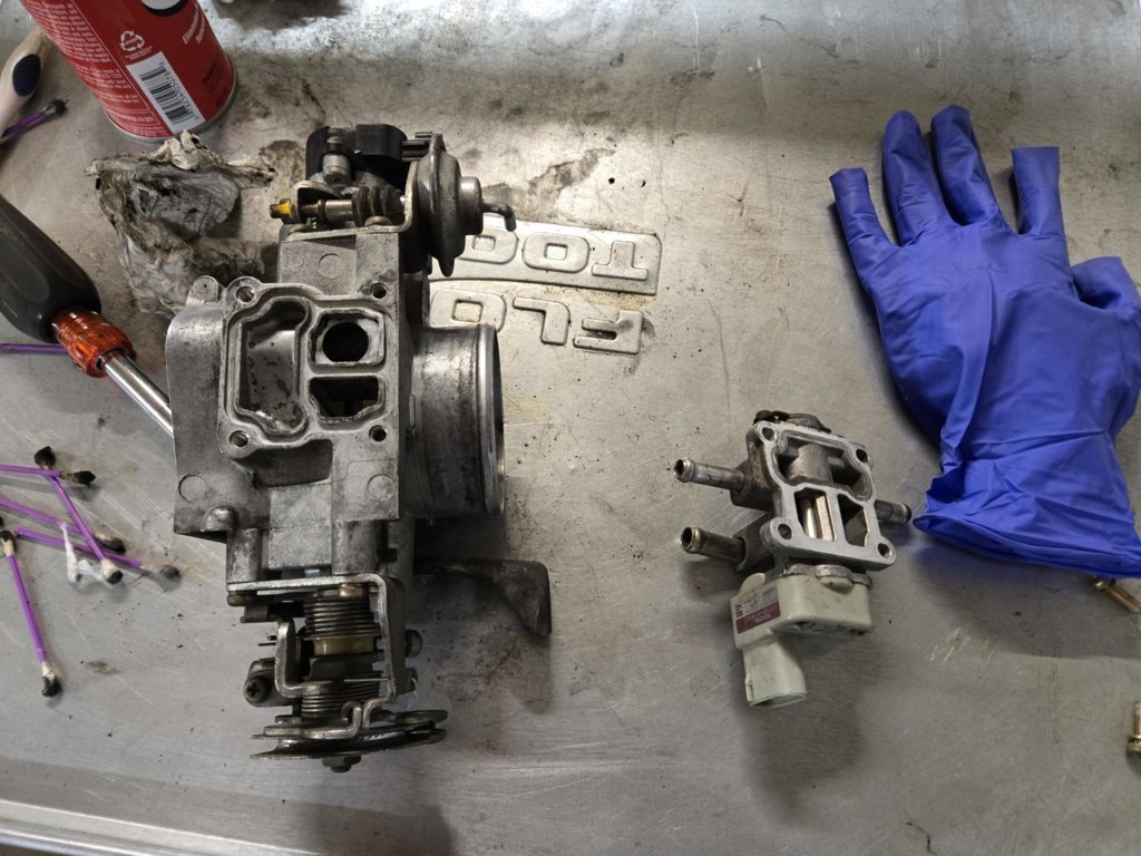

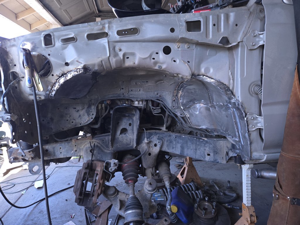

    Also re-wired the main fuse box (meaning spliced ALL the wires coming out of it), replaced the evap canister, and replaced the air filter box.
    All these items were damaged in a front end collision (previous owner).

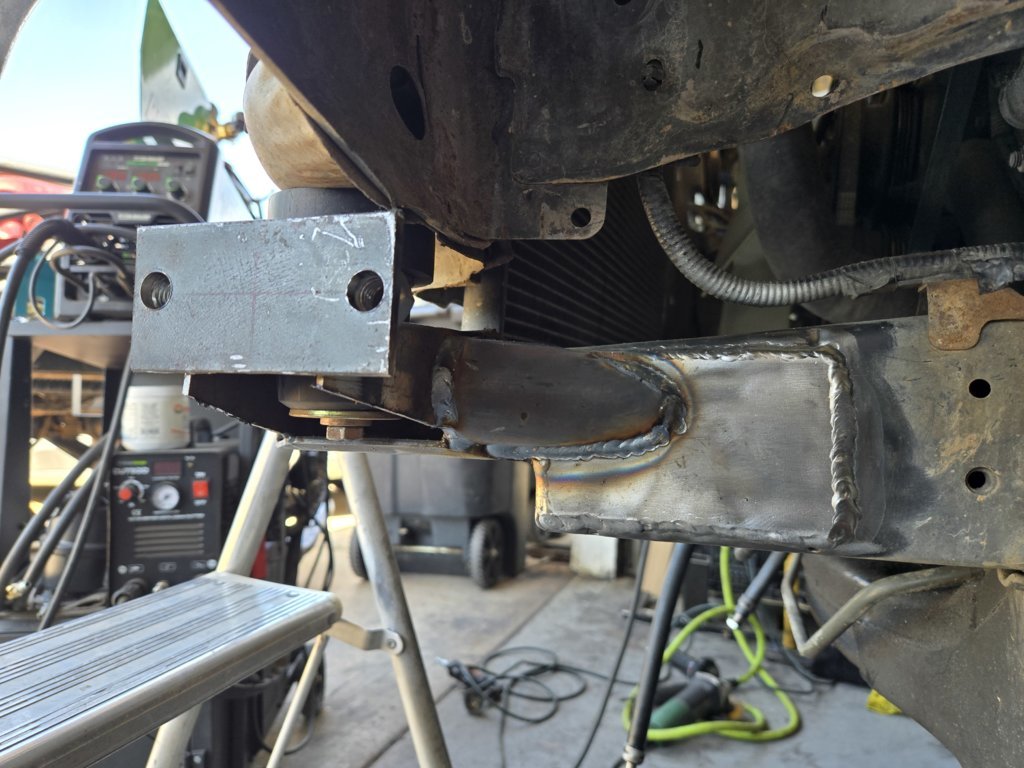

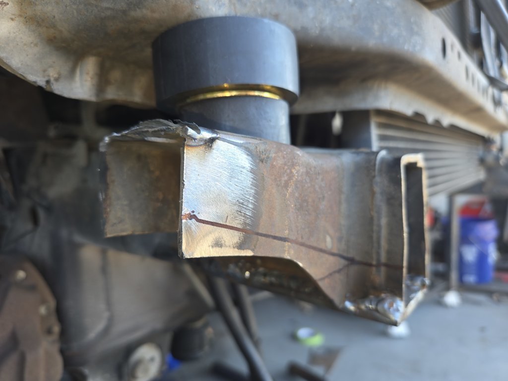

    I notched the frame ends and front body mounts, to account for the 1 inch body lift. (To get rid of the 1 inch gap between fenders/grill and bumper)
    It gave me about a 3/8 gap between fenders/grill and bumper. Which is pretty close to the original gap. And definately within my tolerances.
    I reinforced the frame ends and body mounts.

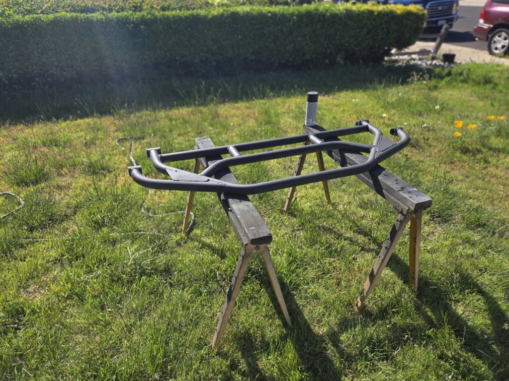

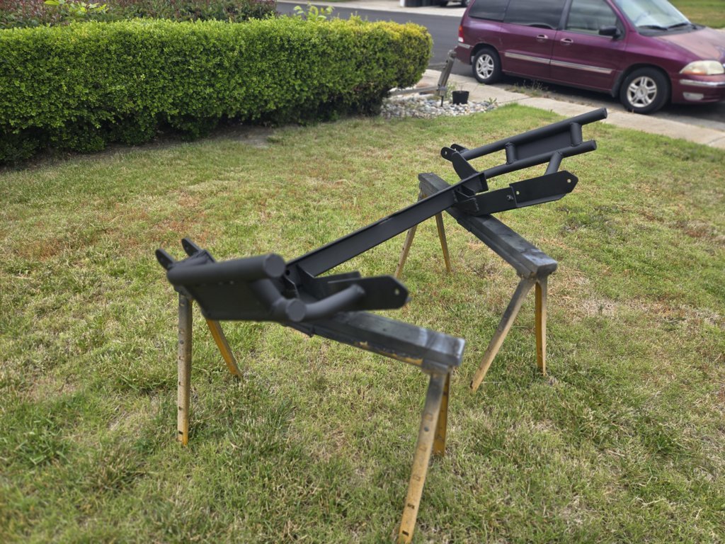

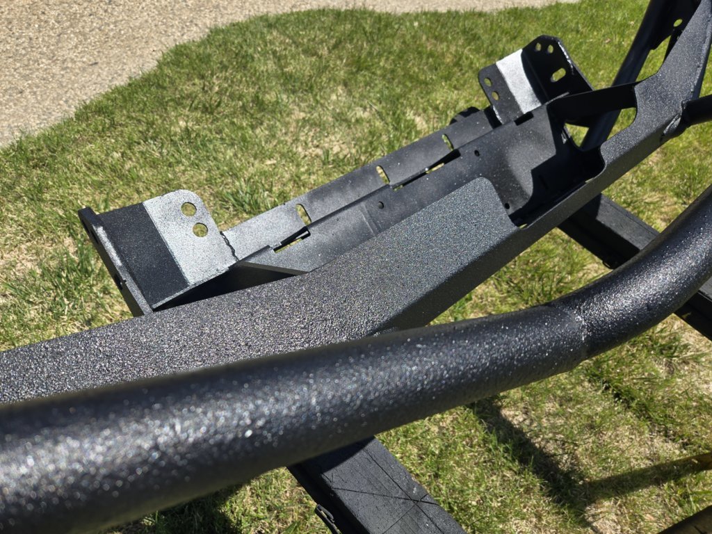

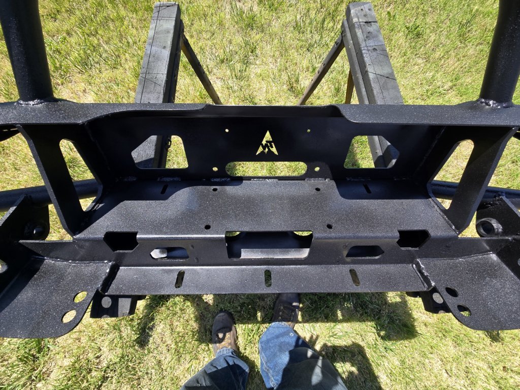

    Bumper got first coat of Raptorliner. I'll let it sit till tomorrow, then I'll turn it over for final coat on the front.
    Pro tip. Just paint the inside of the winch cradle with good paint. And then just let it get the overspray. That area would take a lot of Raptorliner to cover completely. Paint is cheaper than RL.

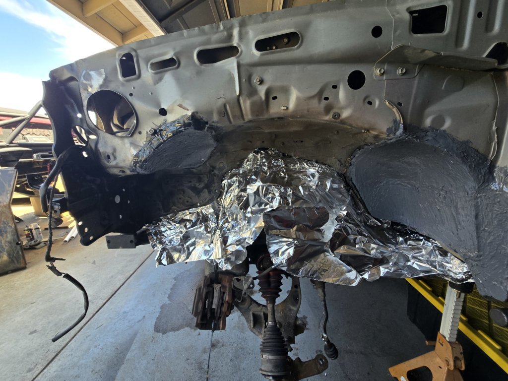

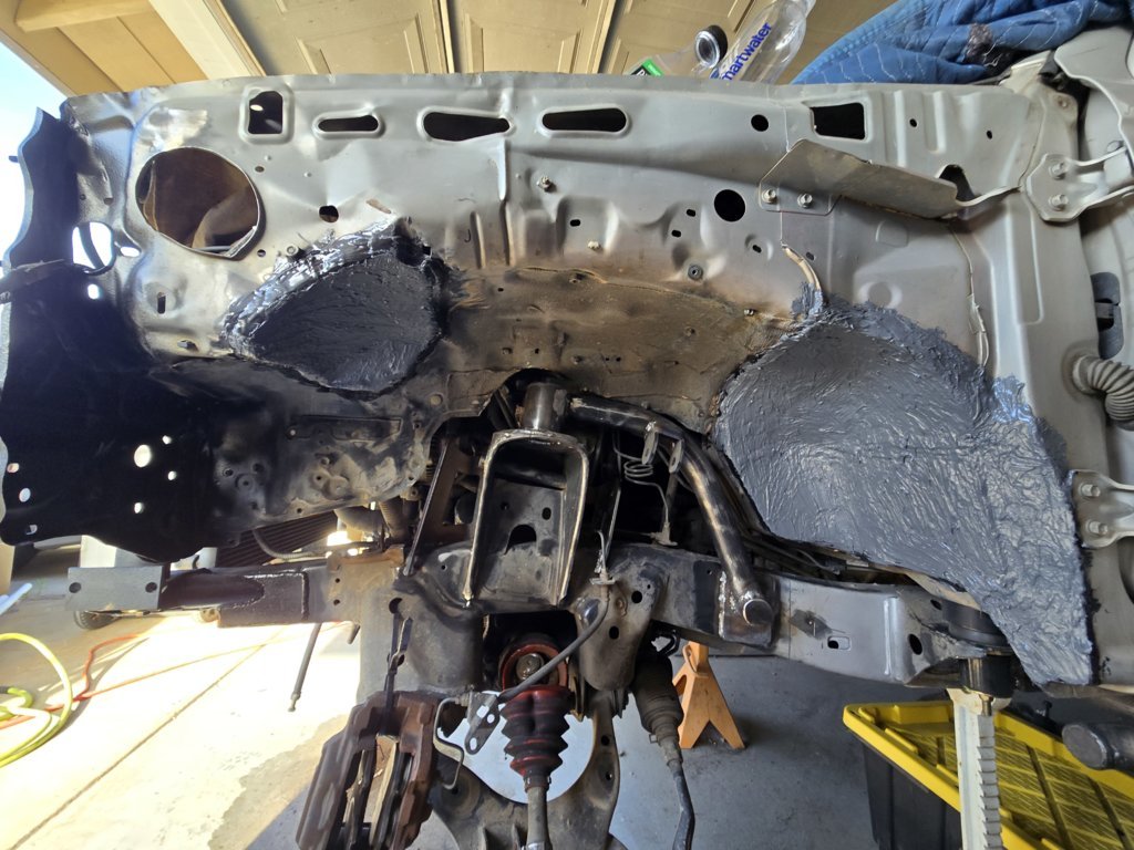

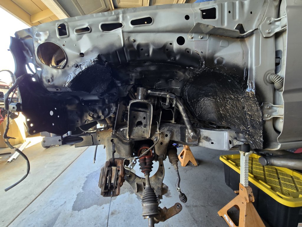

    Who else keeps aluminum foil in their paint prep kit?
    Undercoating complete

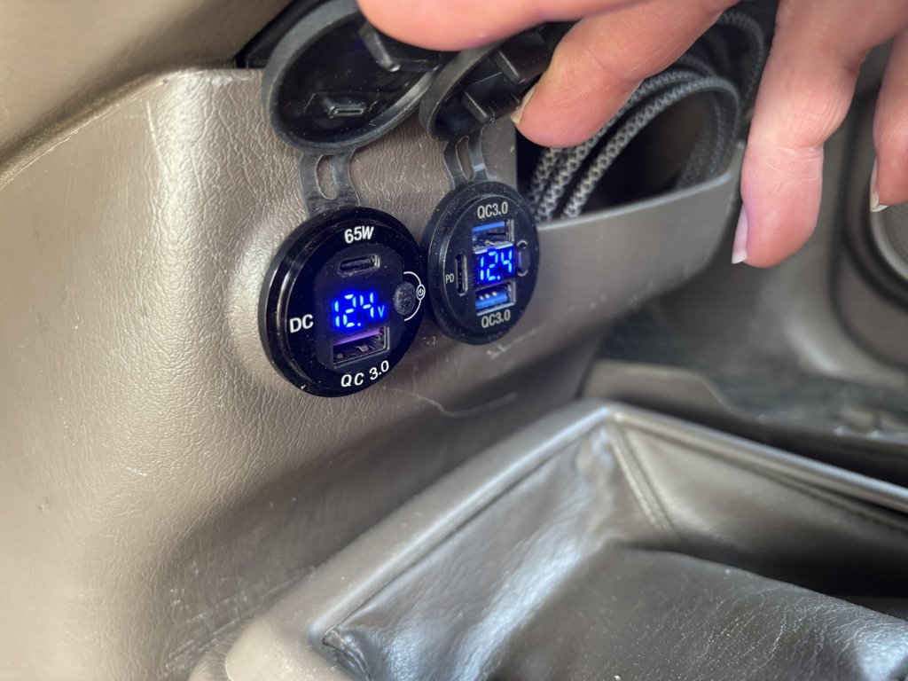

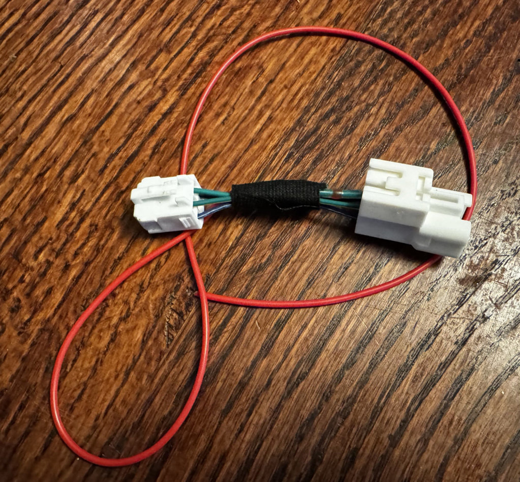

    It’s not a big upgrade but it made for a nice afternoon. Upgraded two of the 12V power outlets to USB-A and USB-C ports so I don't need a separate plug-in for phone, laptop, GPS, etc. The volt meter is kinda nice. Replaced the nonfunctional cigarette lighter with a new 12v outlet for a portable air compressor. Also cleaned up the wiring from a previous owner.

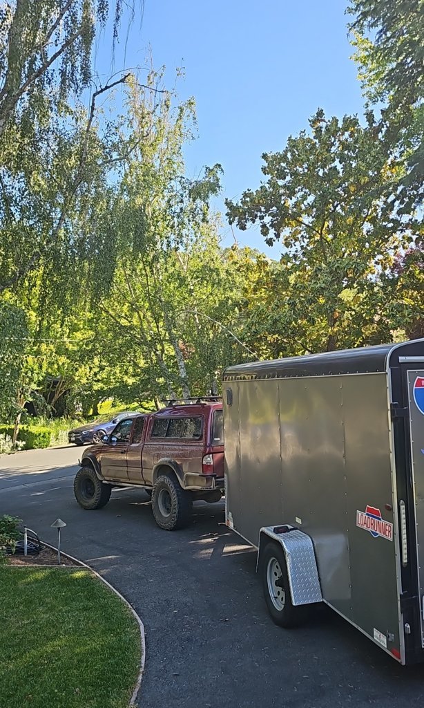

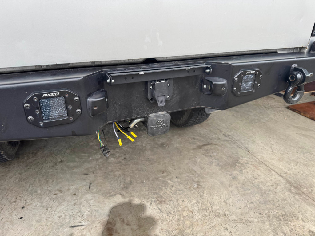

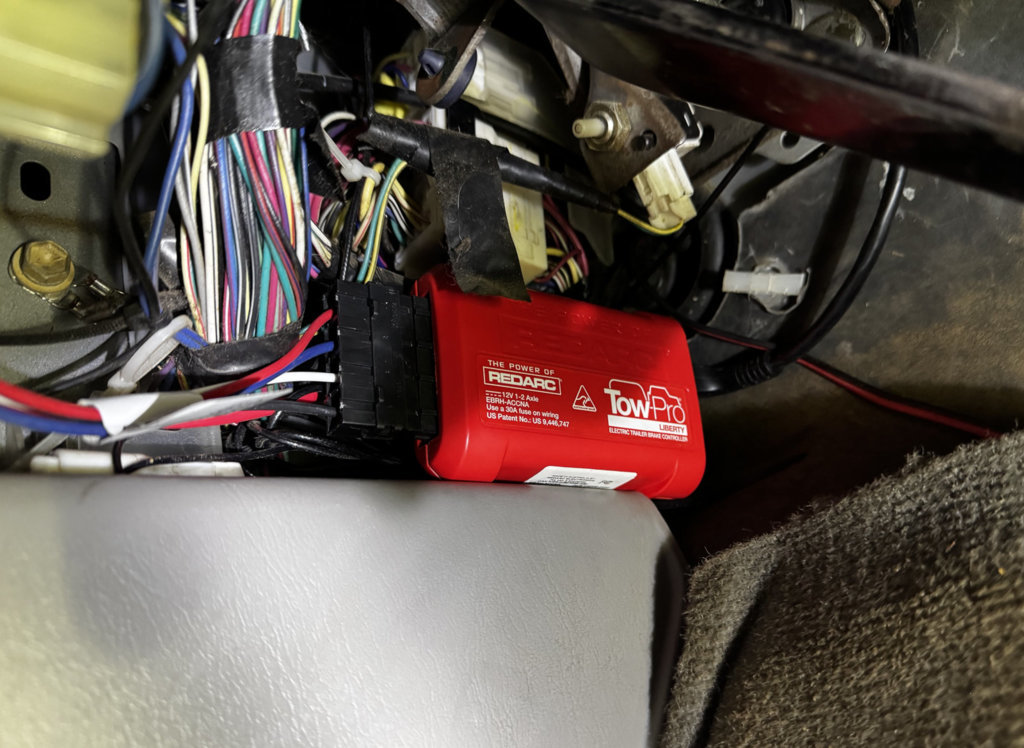

    Picked up a tilt trailer last year with a braked axle, so I'd been wanting to get a trailer brake controller installed. It was a bigger project than I anticipated, but I finally got things wrapped up last week and was able to test it out this weekend.
    I managed to fit the 7 way plug in a pre-existing hole in the middle of my Relentless fab bumper, I paired this with a flip up license plate adapter.
    For the controller I went with the Redarc Tow Pro Liberty, I liked that the control dial/button was separate from the control unit. I mounted the control unit down by the kick panel:
    I found a trim bezel on eBay without a clock, drilled a hole in it and mounted the control knob where the clock used to be.

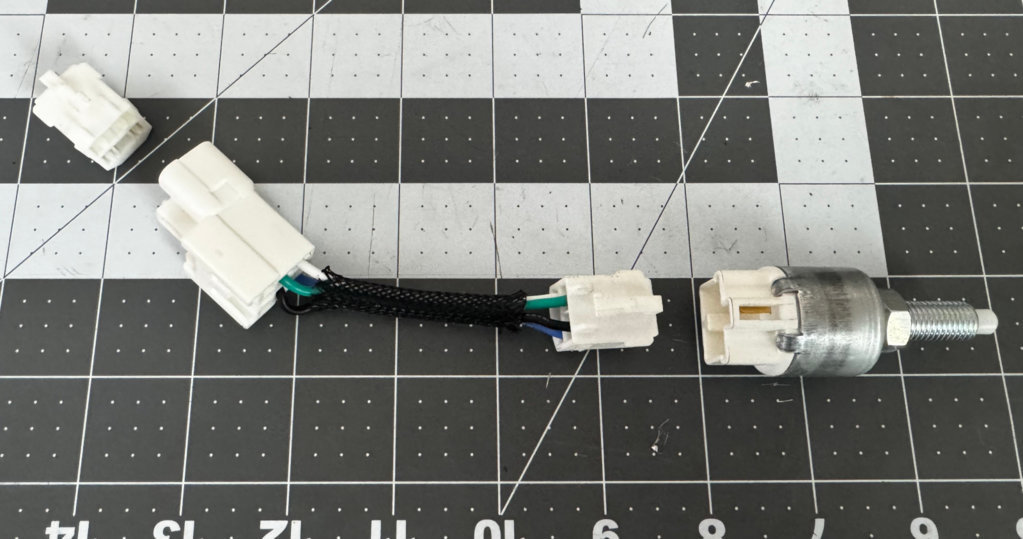

    I wanted to avoid having to splice into the factory wiring, so I bought some brake switch connectors on Alibaba and created a adapter that lets me splice out the brake signal. If anyone would want an adapter or the parts to make one just let me know.
    I needed to run 12V to both the brake controller and the 7 pin wiring so I added a Blue Seas System battery terminal mount.
    It's all working good, and came together in time to do some ditch digging this weekend.

    What undercoating did you use in the wheel wells, everything I've used in there has tended to come off mine, though I probably could have prepped better.

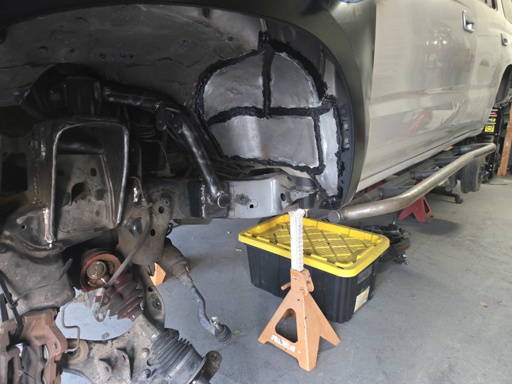

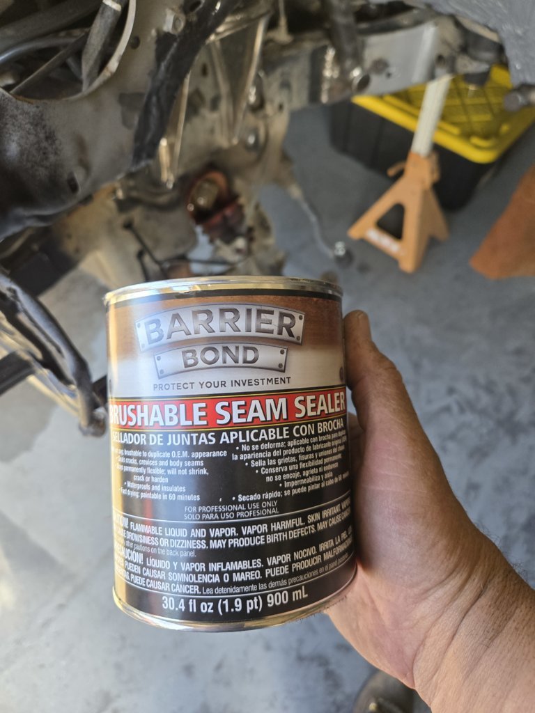

    I used this
    https://a.co/d/9cJ5jP5
    To do this part
    Highly, highly recommend this product. It goes on with a caulking gun. It applies out of the caulking gun easily. And it lays down flat when dry. Even in areas where it's upside down. And it is on there, where you can tell it will not come off.
    1000 times better than the 3M I've used in the past.
    Only took 1 of the 2 tubes to do what I did (including doing this to the back wheel wells)
    Then I used this
    https://www.amazon.com/dp/B083ZL8QFT
    For this part
    It went on with a brush... but it's HELLA thick. Like, 3x thicker than paint. It's doesn't lay down quite as nice as the caulking did, but it's a thick and covered really well.
    Took about 2/3 of a can to cover what I did.
    Then I used this
    https://www.amazon.com/dp/B07PHQ4Y9J
    To do this part
    It stays flexible. (The Barrier Bond stays flexible). I wanted to cover the Barrier Bond with something flexible, so it didn't all just start cracking and peeling off the Barrier bond.
    Took half a can to do the front wheel wells.

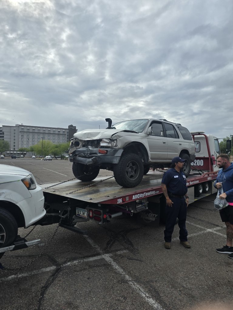

    @El Taco Diablo how bad was the front end damage? My 4runner was in a t-bone I was thinking about trying to repair it. The frame might be bent and I'll need some new clip pieces for sure.

    Ah okay, I used SEM paintable seam sealer (that stuff has been excellent)...
    [​IMG][​IMG]
    But I probably should have done that brush on coating as well and maybe should sand or scotchbrite the inner well before coating again. I had used the Duplicolor Truck Bed Coating in the blue can last time.

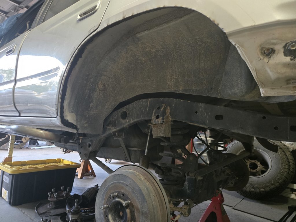

    Not really sure how bad the damage was, actually.
    The truck looked like this when my son bought it (I've since bought it from him, when he moved to Florida).
    It was a salvage title when the guy my son bought it from, bought the truck.
    I know the radiator, fenders, and hood were replaced, the air box, fuse box, evap canister where all still damaged when we got it. The ends of the frame (at the body mounts) were bent in the wreck... and "straightened" by, what appears to be a redneck with a come along, and a sledge hammer. The bumper sub structure was missing, the lower bumper valance was held on with bailing wire. (Which meant there was nothing to mount the frontskid plate to) I reinforced and straightened all that work when I did the work to lift the bumper, to account for the body lift. And the new bumper provides the mounting for the skid plate.

    I used a sand paper flapper wheel on a die grinder to knock down all the welds, then used red scotch brite on the bare metal before I applied anything to it.

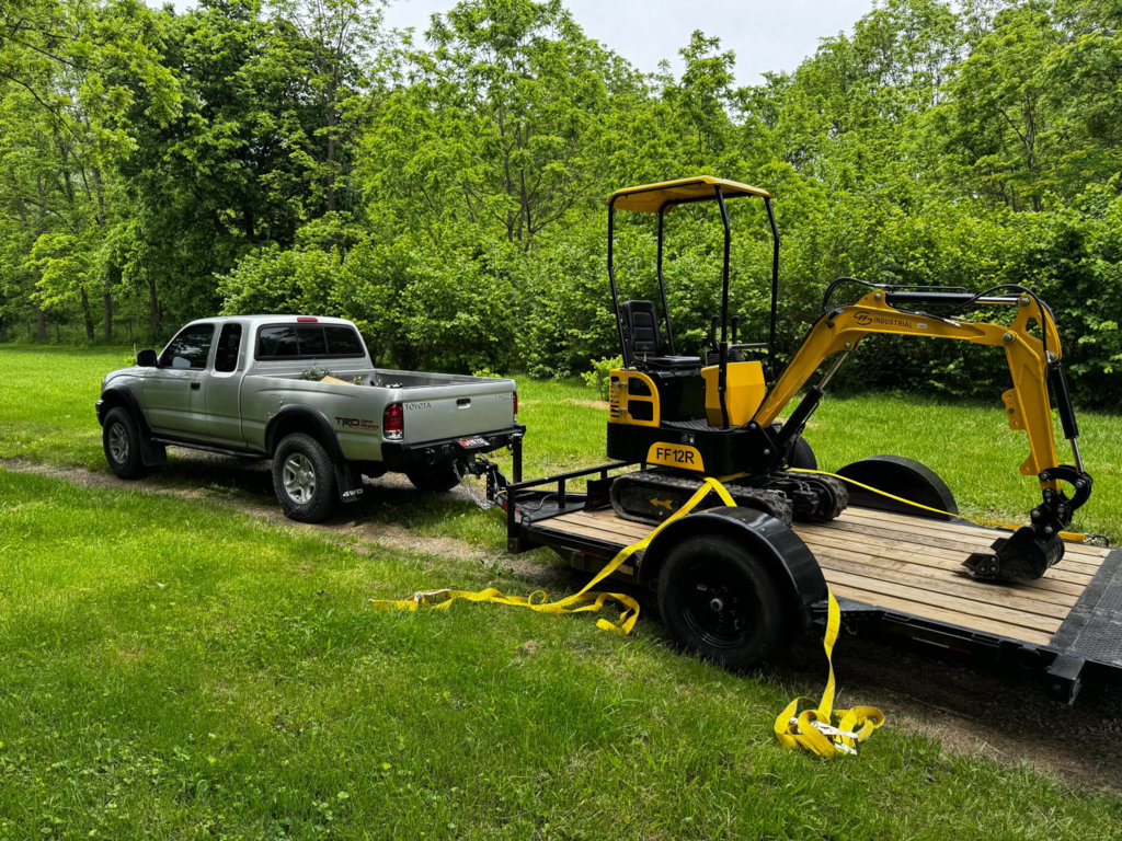

    It is pretty fun and I've been impressed with its capabilities given the price. I've wanted a mini excavator for a long time, but had trouble justifying the price of a new Bobcat/Deere/Kubota/Yanmar or gambling with a used rental one at auction. Andrew Camarata's video convinced me to pick one up: https://www.youtube.com/watch?v=lCDQs-G9Wv0
