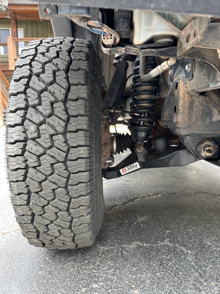

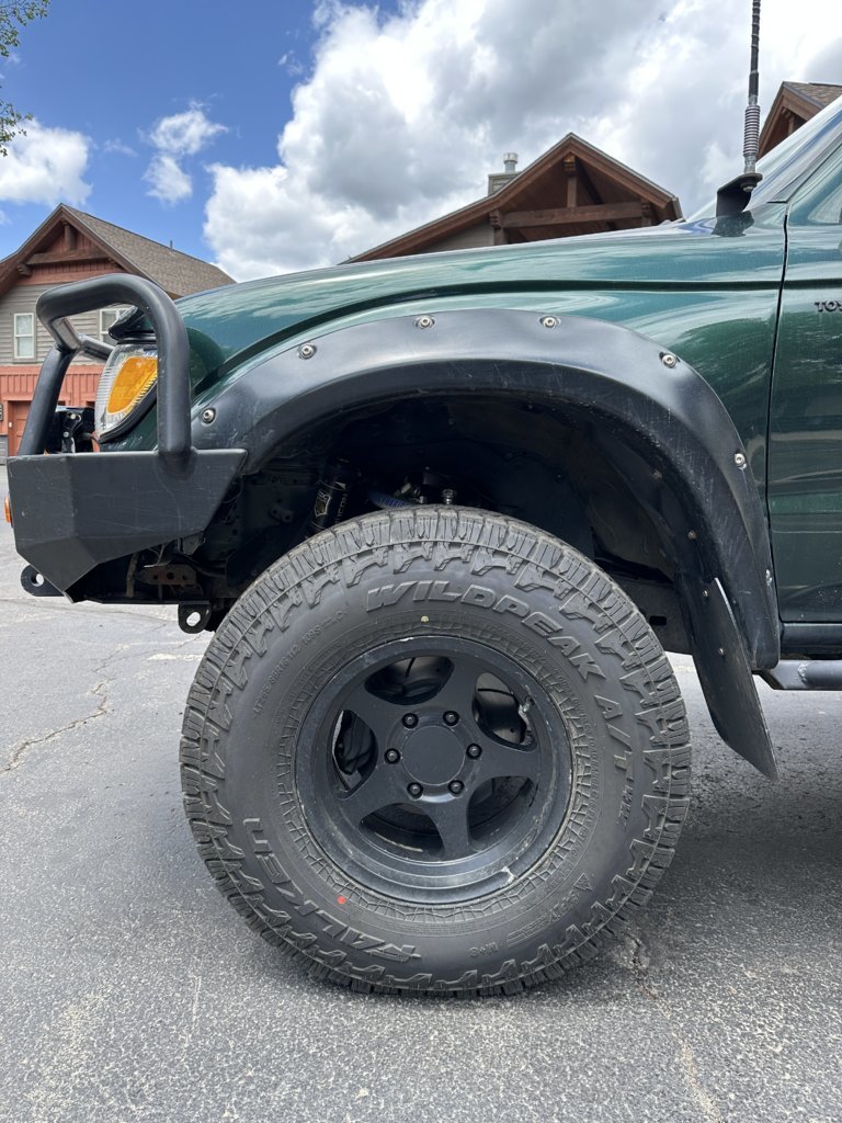

    Solo Motorsports stock length lowers, Fr33Lance built and gusseted spindles, and 33's (255/85/r16)

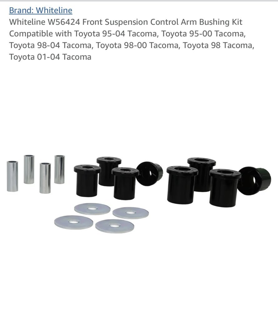

    purchased some goodies for my frame swap build. feel free to check in on my thread. one of many parts to be ordered lol.

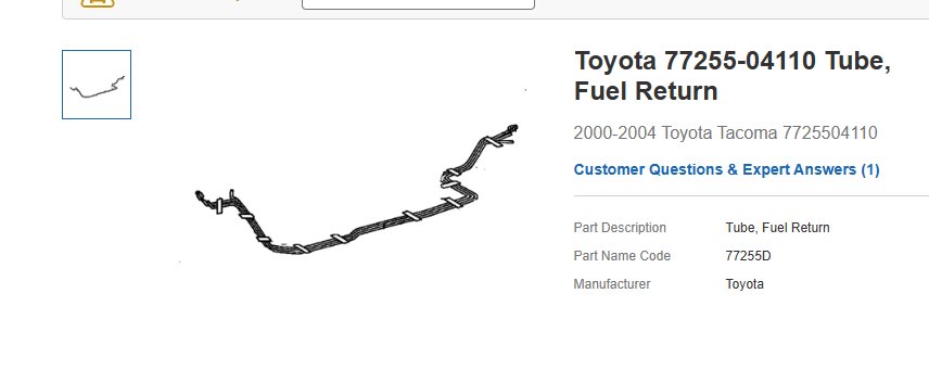

    I went to go order up the fuel lines that run under the cab for my 97 toyota but they are unfortunately discontinued and I cannot located them online. : 7725204040 main , 7725504060 return line , 7726104050 fuel canister
    It appears however for 00-04 trucks they still sell the three lines: 77261-04080 , 77255-04110 , 77251-04170.
    If anyone can let me know if I can run those and be fine let me know lol.

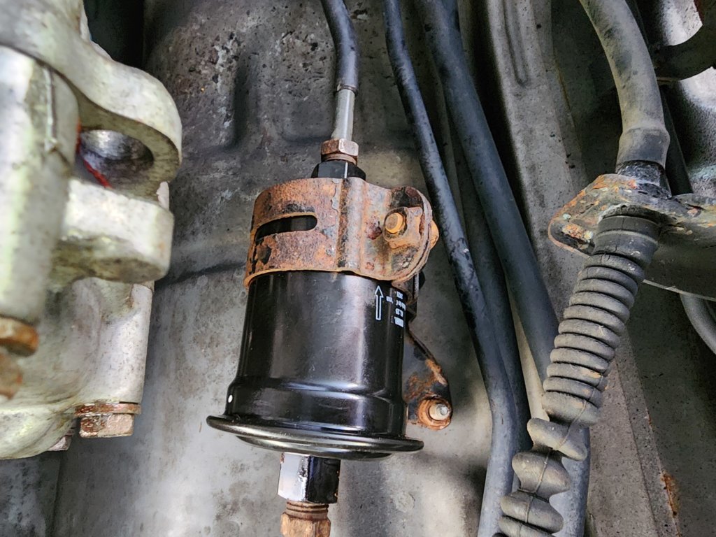

    I would think so, but I think they changed how the fuel lines secure to the bottom of the cab between 95-99 and 00-04. There's reference to nuts securing the lines in the filter guide I used for my fuel filter, and there aren't any under my truck. (Had to bend the lines a little to get the old filter off, then bend them back to secure the new filter)

    Hey what fender flares are those?

    Bushwacker

    For what truck?
