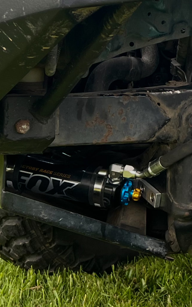

    IMG_7039.jpgDrilled and tapped, if the holes ever strip think I’d go to a rivnut, with there not being a lot of movement at the bracket I don’t think there’s a lot of stress at the fasteners

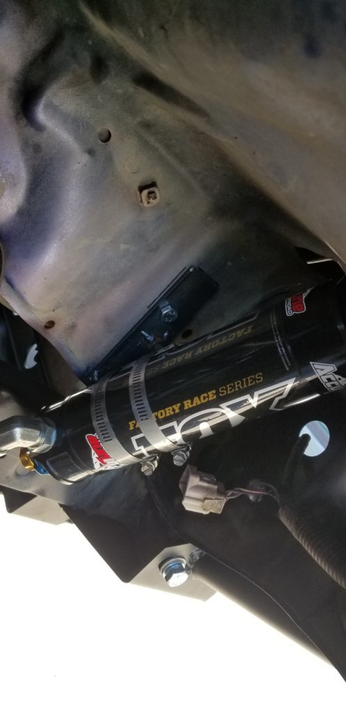

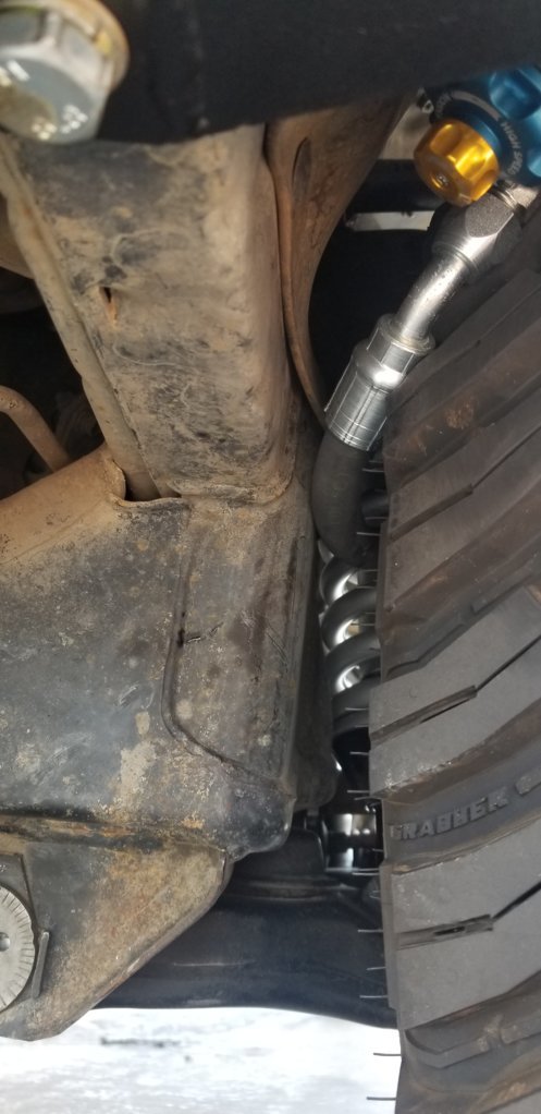

    Only one fastener into the frame per side?
    I might have to re evaluate the mounting of mine because I do have to be mindful of how hard I turn on the trail because the tire side knobs will contact the hose.

  6. Jun 11, 2025 at 3:00 PM
    JR_Roams
    JR_Roams Well-Known Member
    Apr 17, 2025
    #469627
    106
    2002 Tacoma TRD-OR EXC 5MT
    @betterbuckleup Looks risky especially since you're hitting the rigid hose fitting and not the hose itself. The hose has some give to it.
  7. Jun 11, 2025 at 4:43 PM
    betterbuckleup
    betterbuckleup Well-Known Member
    Jun 26, 2017
    #222483
    4,831
    Ian
    Concord, CA
    2000 Tacoma SC 2.7 4x4 5spd
    Ya it's not ideal but I have gotten away with it like that for the last 5 years without issue, but my setup has changed a lot from the picture taken in 2020.
    That situation also doesn't happen too often since it's at full compression and full lock

    IMG_5117.jpg2 fasteners per side, countersunk 5/16-18 stainless (I think). The bar stock I think is 3/8”x1” 6061, bent to the angle with a press brake. Definitely some futzing around getting the clearance right.
    I initially tried to mount the resis to the inner fenders, but my inner fenders are cracking in several places so I figured it wasn’t going to work
    Now with the Solo lowers on (got it aligned today), there’s no stops for the lower ball joints to hit, so basically just maxing out the travel of the steering rack, no clearance issues, no rubbing at all at least under normal conditions, haven’t tested while suspension cycling.
    I used to hit the frame at the back of the tire with enough bite from the tire lugs to stop the truck, that’s gone too, very happy with the results.

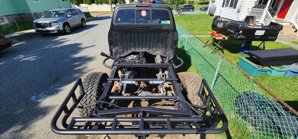

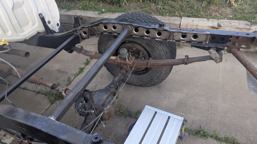

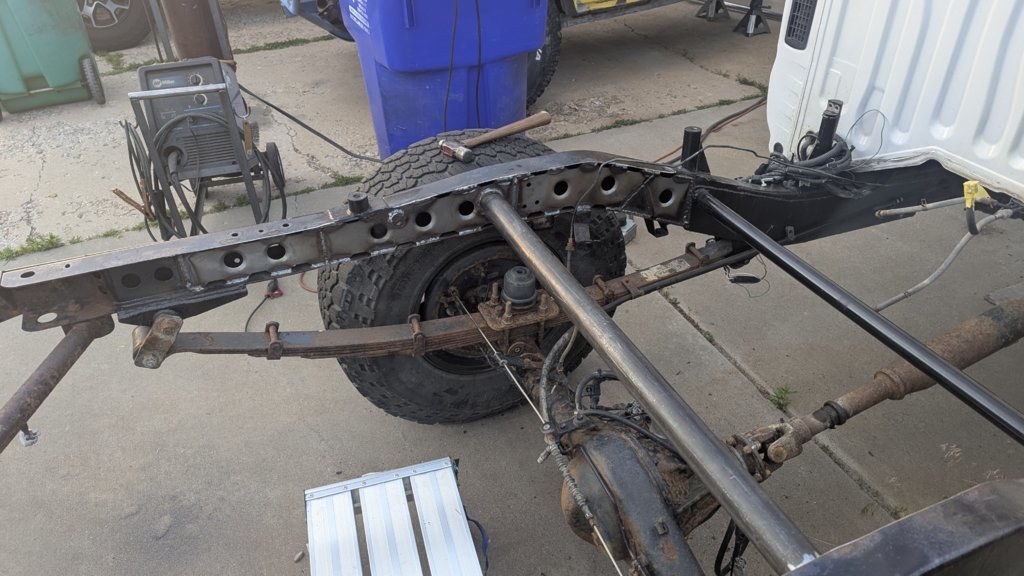

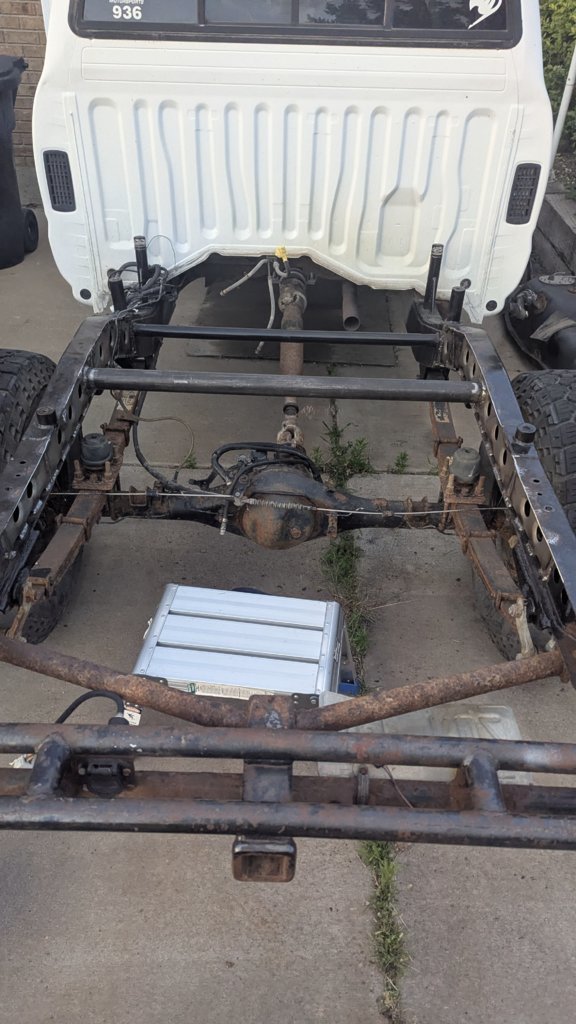

    Finished boxing in the back half of the frame and replacing the cross members today.

  13. Jun 13, 2025 at 5:55 AM
    BYJOSHCOOK
    BYJOSHCOOK Mr. Mojo Risin
    Jun 9, 2013
    #105887
    27,936
    Josh
    Woodstock and Alpharetta Ga
    2000 SR5 4WD Lunar Mist
    Check Out My Builds
    Is that the Solo kit?

    Good on ya for going all the way up. :thumbsup: Since I see no provisions for a stock fuel tank are you planning a fuel cell or something similar?

  15. Jun 13, 2025 at 7:18 AM
    P.Blackley
    P.Blackley Well-Known Member
    Jul 30, 2014
    #135093
    224
    Patrick
    Layton, UT
    99 Tacoma 4WD SR5
    Fox extended coilovers, LR UCA's, Deaver J59's W/ 12" Fox triple bypass shocks
    BYJOSHCOOK[QUOTED] likes this.
  16. Jun 13, 2025 at 7:23 AM
    P.Blackley
    Jul 30, 2014
    #135093
    224
    Patrick
    Layton, UT
    99 Tacoma 4WD SR5
    I have a couple designs for a 37 gallon fuel tank to sit behind the axle and still use the factory fuel pump and sender. I just haven't gotten around to sending the file out to get cut and bent.
    I originally had it designed for around 50 gallons but decided I didn't need that much.
  17. Jun 13, 2025 at 7:31 AM
    Speedytech7
    Feb 20, 2014
    #123587
    58,499
    FCQM+VG Cheney, Washington
    It's less Tacoma and more mod
    Nice, same actually, but I went for an already made 35 gal tank.
  18. Jun 13, 2025 at 7:37 AM
    ToyRyd04
    ToyRyd04 Taco Transformer
    Aug 5, 2011
    #61217
    1,900
    Greg
    Perryville, MD
    '04 PreRunner
    SAS'd PreRunner Diamond Axles Crawlbox
    I just finished up boxing the frame and tube crossmembers in mine. The solid feeling is pretty remarkable and the difference in ride quality is great.

  19. Jun 13, 2025 at 9:31 AM
    cynicalrider
    cynicalrider #NFG
    Jul 25, 2012
    #83399
    17,195
    Jersey
    01 SR5 TRD 4x4, '23 Bronco Wildtrak, 2017 HSQV FE350
    Drop bracket lift and booger welds
    unstpible, Phessor, ztwatson and 2 others like this.
  20. Jun 13, 2025 at 9:37 AM
    Speedytech7
    Feb 20, 2014
    #123587
    58,499
    Aight, I'll play, boxy is beautfiul
