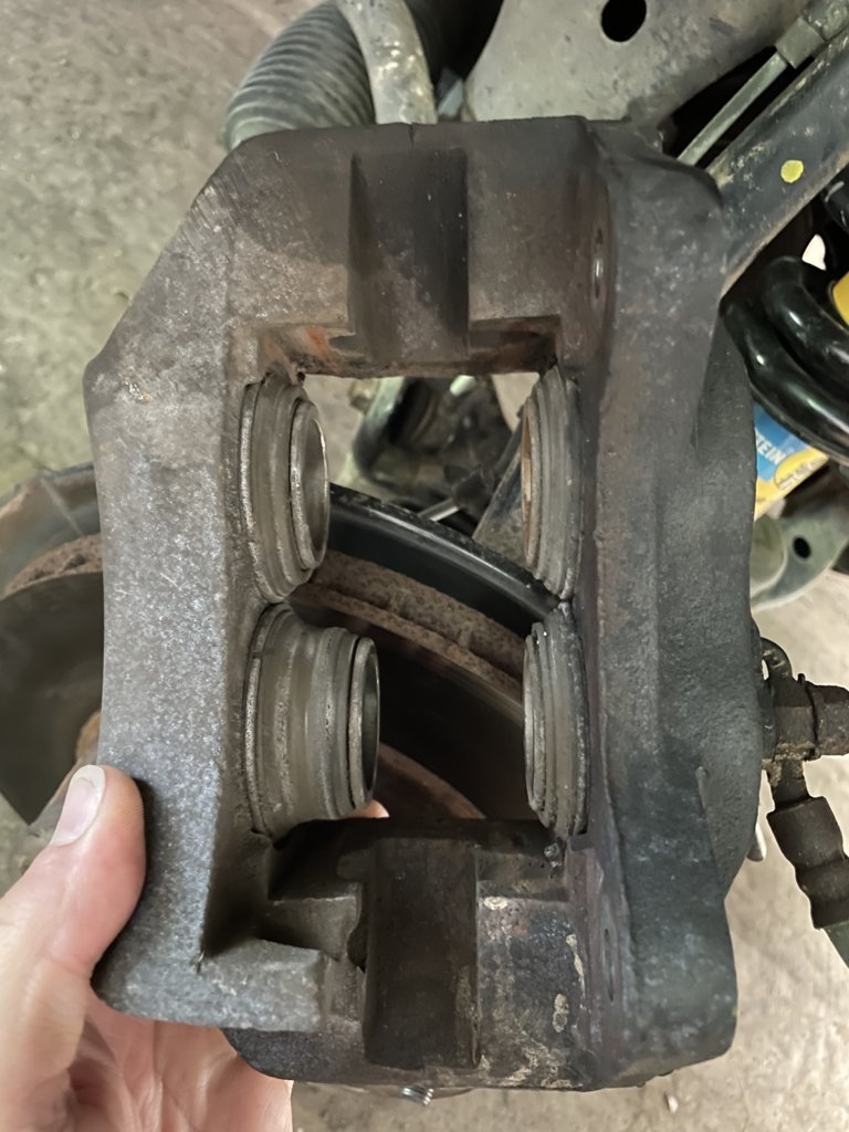

    Troubleshooting some pulsing brakes. Rebuilt the calipers and added some grease where needed to make sure the front brakes were running as they should. Think I got the problem solved. Time will tell.

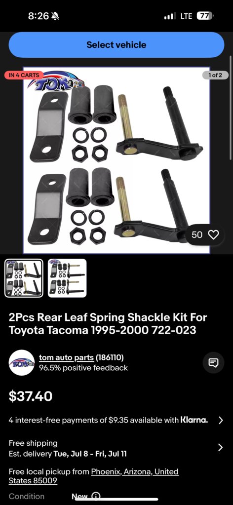

    Is there a cheaper version of this for bilstein shocks?
    Also it seems like I’ll save over $70 on shipping if I piece out this kit on ebay alone vs purchasing from ToyTec.

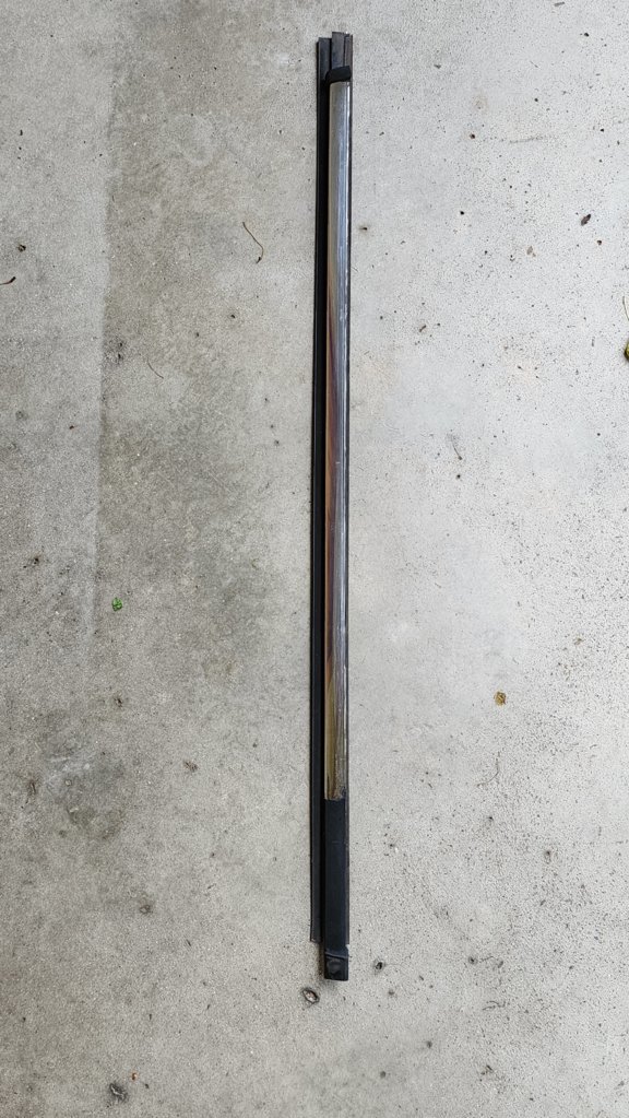

    Bottom window weatherstripping was hammered
    4 piece set from EB were packed well unlike some from the dealer prior.

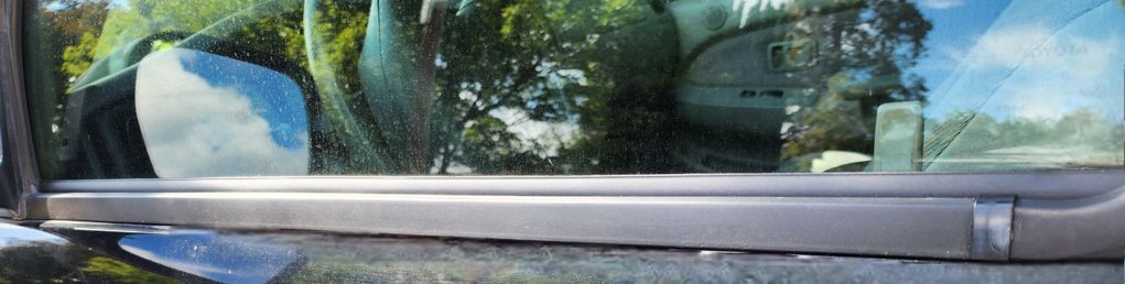

    Fronts fit well.

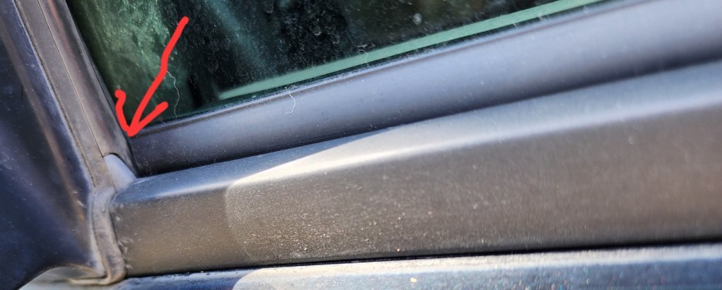

    Filled the gap in OE vertical with a little weatherstrip

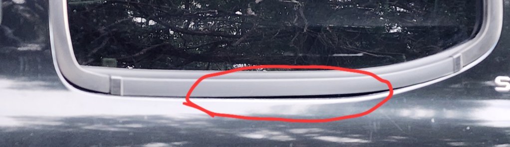

    But rear wasn't shaped right and gapped.
    So repainted the OE since it was repairable and reinstalled.
