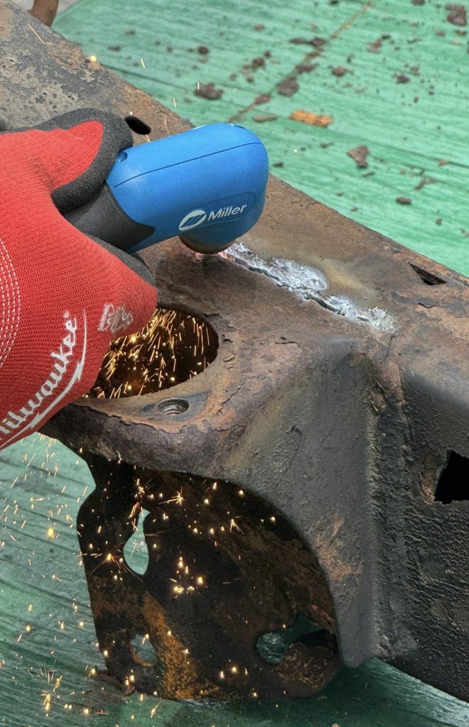

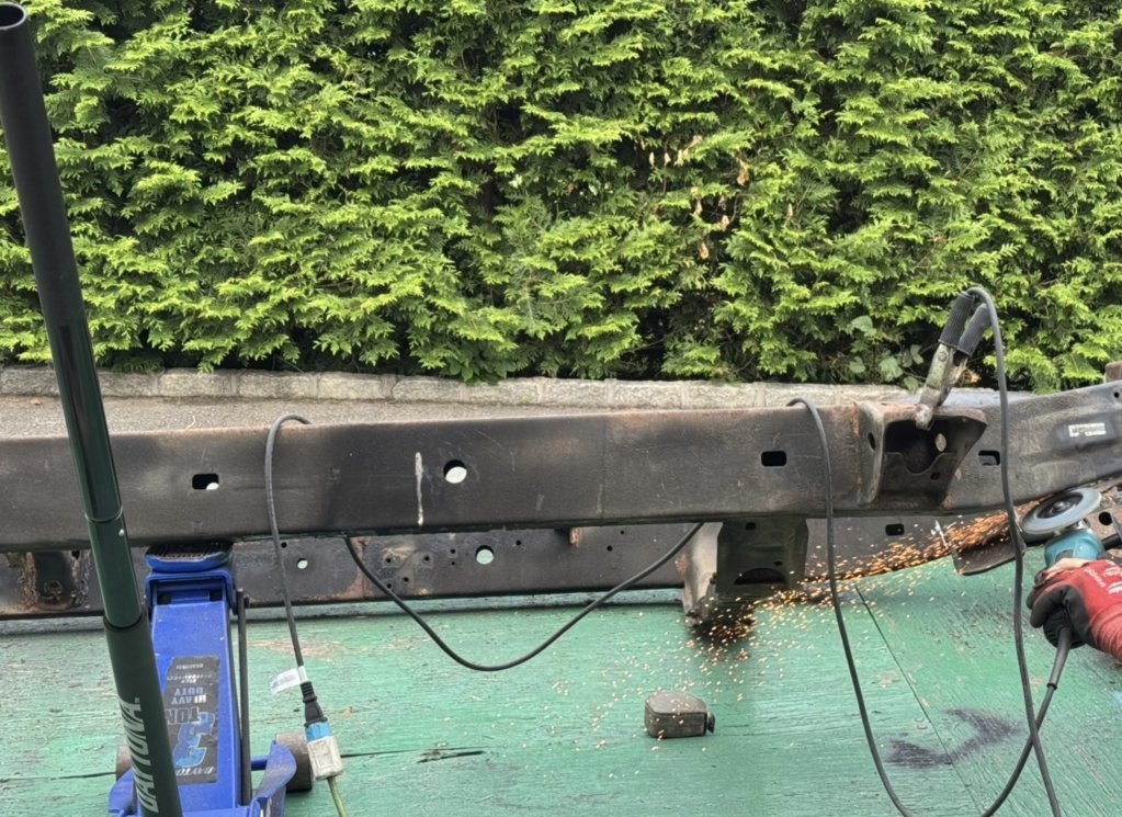

    Touched the frame today. Moved some mounts around with the help of my dad with his grinding and welding expertise.

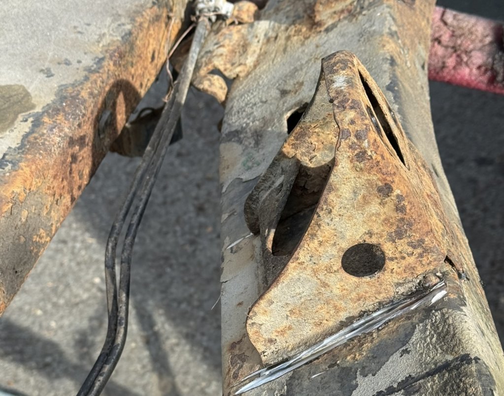

    Some things to note: Double Cab Frames have different Bed Mounts. So we had two spare rails left and right from a 1999 extra cab which we borrowed the bed and cab mounts from. Rear Cab Mounts are slightly different.
    Plasma cutters are awesome however we dont have strong enough electric in the house to run it for very long so it kept shutting down on us so unfortunately had to result in using an angle grinder like a redneck for the job. Took hours this way lol.

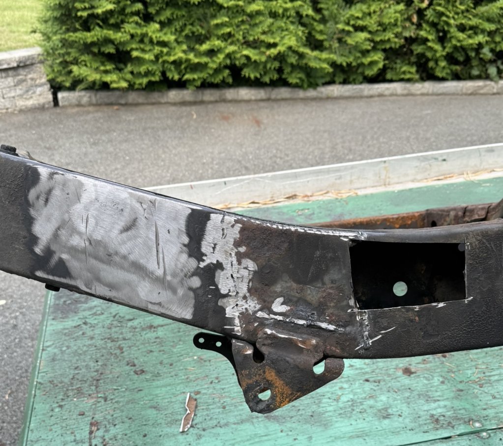

    Welded on some new sway bar brackets and cut a hole out where there was rust forming near the leaf spring bracket. Frame is perfect otherwise.
    I forgot a pic of all the mounts we cut off they are now chillen in my sandblast cabinet for another day. I have to purchase one bed mount from Toyota.

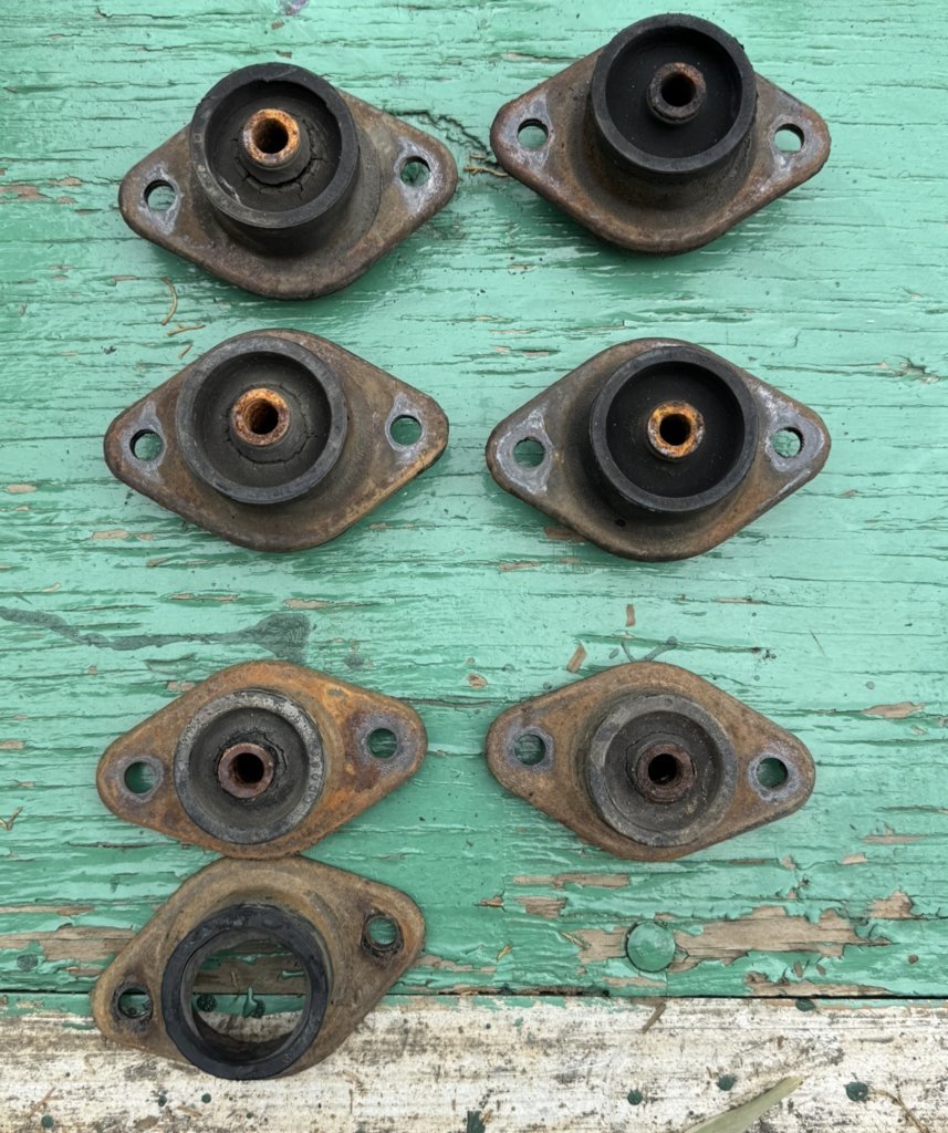

    Old Cab Mount Bushings from both frames, pretty shot. I ordered a Energy Suspension Replacement kit which is significantly cheaper than sourcing OEM ones.

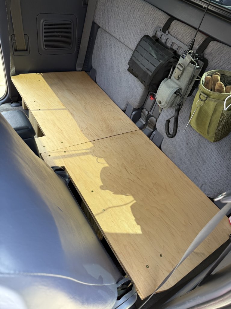

    Enjoyed the heat and put together a storage solution for the xtracab. This is a 2 piece platform that easily lifts in and out when needed and covers the entirety of the rear area in the truck. Was fairly simple to put together using cardboard as a template. Going to cover the wood in an outdoor marine type carpet in the next couple weeks. Fitment ended up being great.
    Had no idea how expensive plywood is now…

    Looks like I wasn't the only one with this idea this week.
    I did mine in my double cab. The short back panel folds down for access to the jack and its tools, the body of my ham radio, and some more open storage where I will keep some emergency supplies (light rain gear, a few tools, belts, filters, tire plug kit and the like), just waiting for some latches to come in.
    On the shelf above the wall, I have built a rack for a pair of long rifles that will be installed for hunting season because they won't fit in the overhead rack. I will interchange that with a shallow tray that I will build sometime in the future to hold some loose items.
