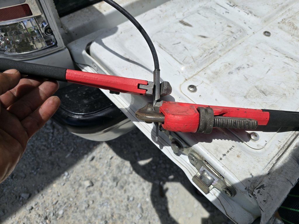

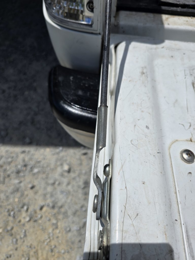

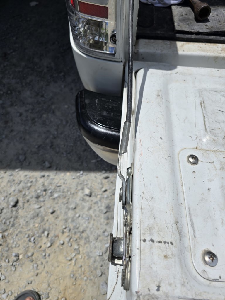

    He rediseñado el trabajo. Lo he simplificado. Solo tienes que doblar ligeramente hacia adentro el extremo que conecta con la tapa del maletero del camión.

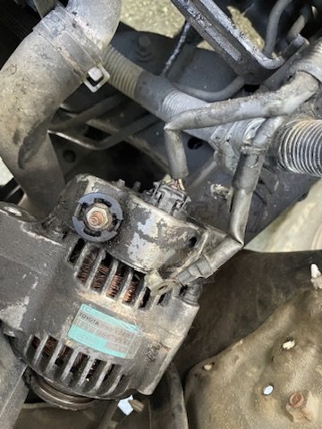

    Battery light came on. Didnt test it but assumed it was the alternator. bought a used one for $90 and swapped it in. took 4 hours. Was a bitch to get the electrical connector out of the old alternator, and was a bitch to get the used alternator in because the bearing was sticking out, few taps with the hammer and it was back in

    I recently replaced my alternator with the 105A Denso, and I found it was much easier to unbolt the alternator entirely (both the tensioner and pivot) and then "set/fold/pivot the alternator down in the engine bay" in order to get the plug out. Was still a pain, but much easier to get a pair of pliers onto.
