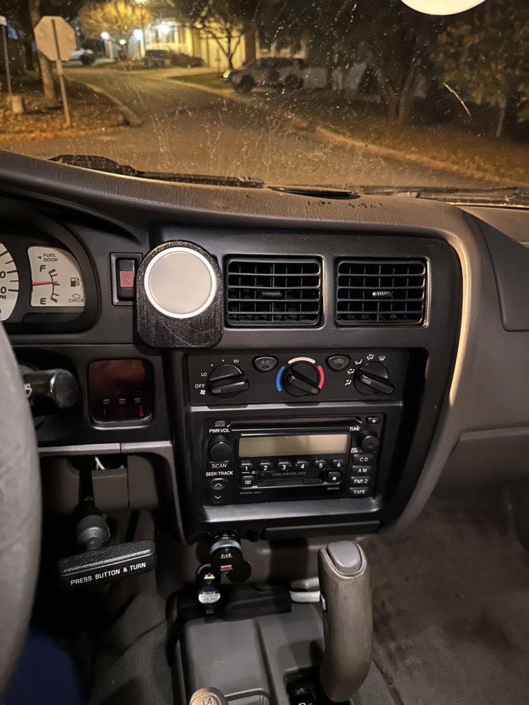

    2003 Tacoma TRD Off Road
    New phone mount from nzbrock
    and Bluetooth radio receiver.

    Lookin good!

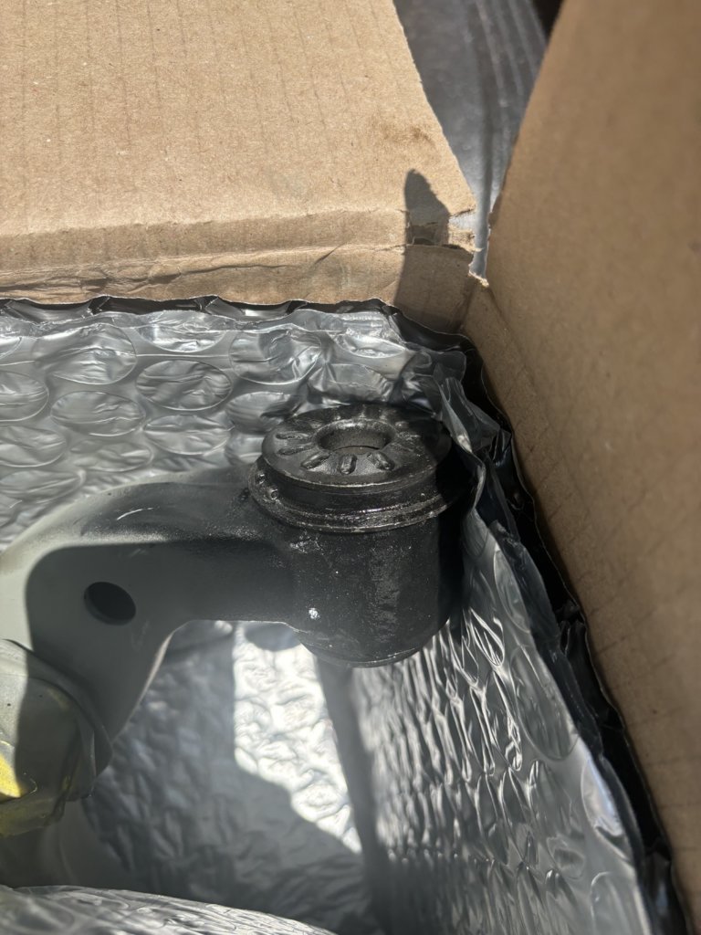

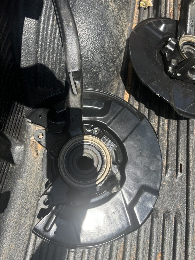

    Spindles and lower control arms came back from the machine shop. New Bushings, bearings, and backing plates installed.

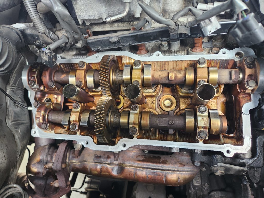

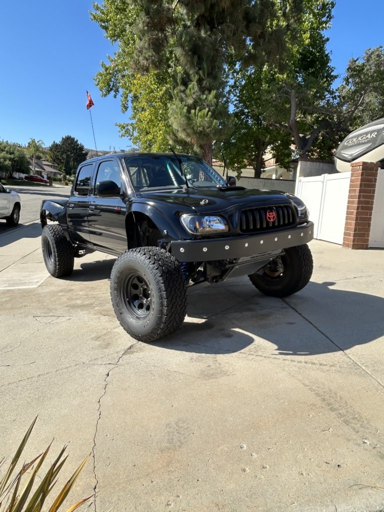

    Not sure if the non-oem gasket used last year is to blame, but fixing small leak in lower back corner. Luckily the passenger side is easy to access.
    356K miles.

    Felpro?

    Some no-name Amazon (or ebay? can't remember)
