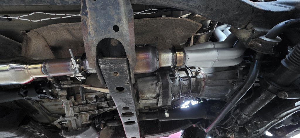

    95 tacoma regular cab 3rz 5spd 4x4
    456 gears, 35s, balance delete, .040.

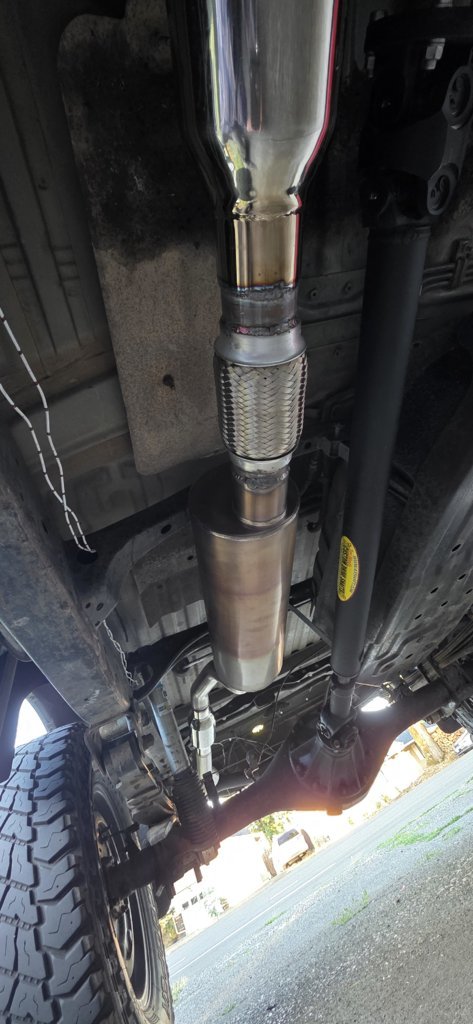

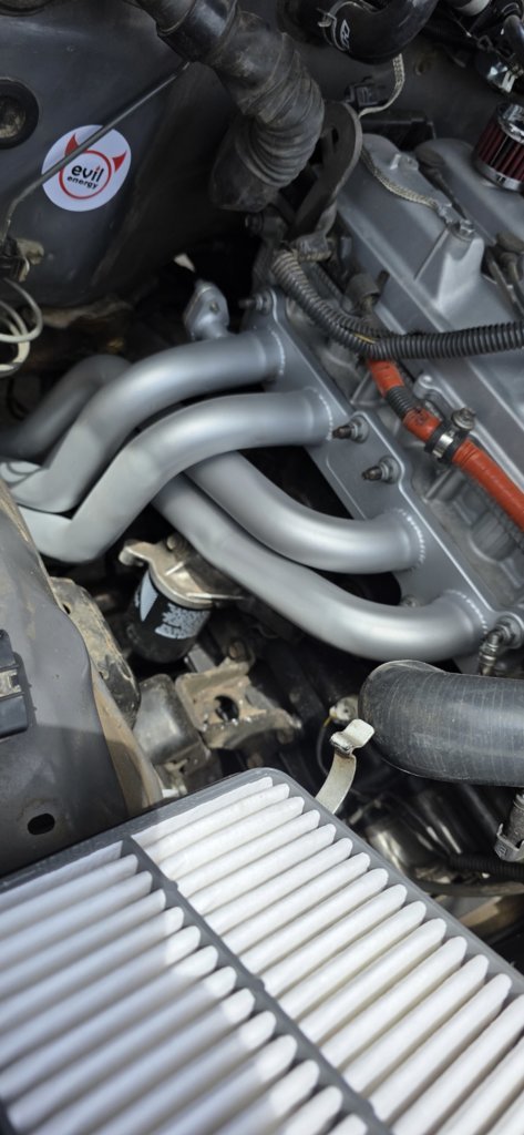

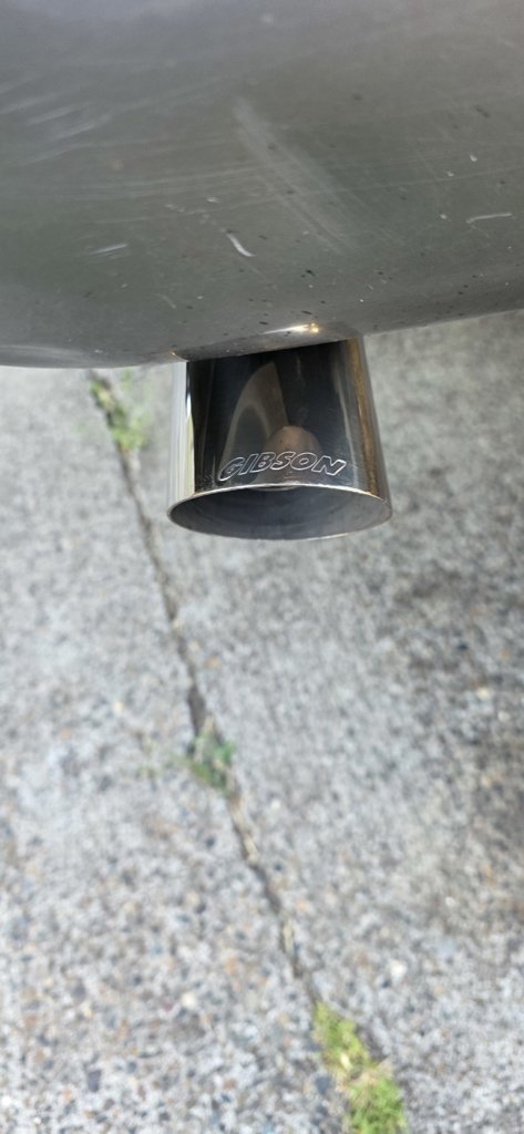

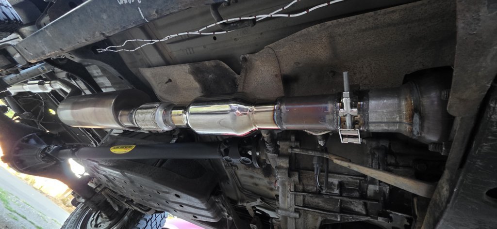

    Redid the exhaust in the truck today, full exhaust, header back. Got a nice high-flow cat, used V-bands for the cat incase I ever have to replace it for some reason. Then added a resonator before the muffler then added another resonator after the muffler. All stainless 2.5" muffler is a Gibson. It sounds so much better than it did. And its not all hacked up -previous owner really butchered the exhaust in this, the original cat was welded to the header, but punch out and not doing anything.

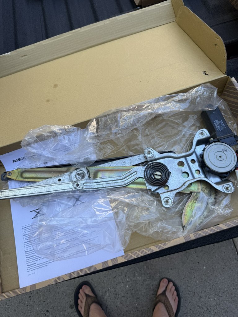

    Driver side window was starting to not want to go up without some percussive maintenance. Replaced with an Aisin branded regulator/motor. Went in really easy and already was coated in grease. Lubricated the channels with silicone during. Worst part is having to pull the plastic cover and butyl tape off - I replaced with new butyl and cut a new plastic sheet. It does seem a little louder than the OEM one I pulled but is smooth.
    Will be doing the passenger side tonight figured might as well do both. Heat index hitting ~115 today in the South so gotta wait a bit. Figured a great time to go to the air conditioned indoor gun range instead.

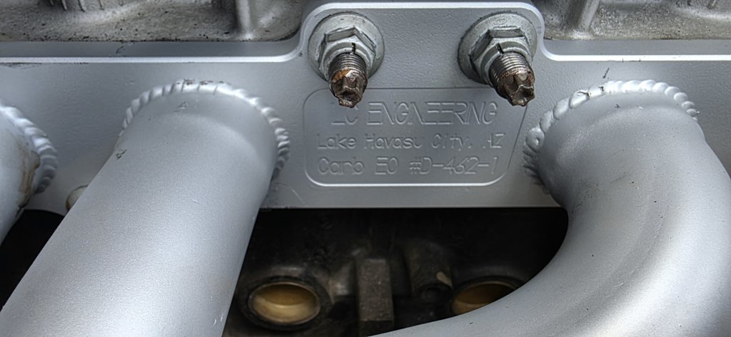

    That looks really clean man. How do you like the LCE header? I ended up swapping mine to the '01-04 mini header after I got a ton of idle vibrations from the LCE header.
