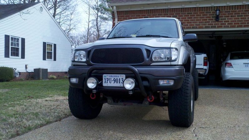

  5. Feb 27, 2011 at 1:16 PM
    #245
    tacoman355
    tacoman355 WORD!?!
    Oct 10, 2009
    #24082
    921
    Tyler
    Hampton,VA
    03 Reg Cab Taco
    sold....
    New grill, now for some hellas!
  6. Feb 27, 2011 at 1:17 PM
    #246
    Pingo
    Pingo Well-Known Member
    Jul 8, 2008
    #7826
    466
    North Pole, AK
    2014 S/C TRD Offroad A/C
    Which grill is that?? Looks good!
  7. Feb 27, 2011 at 1:21 PM
    #247
    tacoman355
    tacoman355 WORD!?!
    Oct 10, 2009
    #24082
    921
    Tyler
    Hampton,VA
    03 Reg Cab Taco
    sold....
    Thanks man, its a grill craft.
  8. Feb 27, 2011 at 1:25 PM
    #248
    Pingo
    Jul 8, 2008
    #7826
    466
    North Pole, AK
    What are your plans for mounting the hellas?

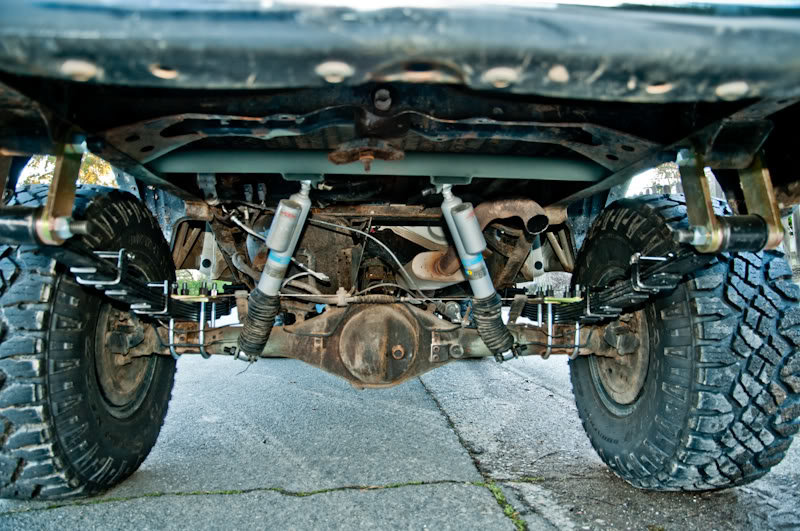

  11. Feb 27, 2011 at 3:22 PM
    #251
    JLee
    JLee The Man! Vendor
    Jul 20, 2010
    #40461
    19,622
    Jerry
    Grass valley CA
    02 Extra cab SAS Linked front and rear
    I lost track thousands of dollars ago.
    This!
    Austin W. R. likes this.
  12. Feb 27, 2011 at 3:49 PM
    #252
    tacomakid96
    tacomakid96 Lions Not Sheep
    Jan 27, 2010
    #30175
    4,268
    Phil
    Out n' about
    1996 Tacoma / 2000 4.7 Tundra TRD
    Damn jerry that's quite a setup!
  13. Feb 27, 2011 at 3:53 PM
    #253

  14. Feb 27, 2011 at 3:55 PM
    #254
    tacomakid96
    Jan 27, 2010
    #30175
    4,268
    Phil
    Out n' about
    How does she ride?
  15. Feb 27, 2011 at 3:58 PM
    #255
    JLee
    Jul 20, 2010
    #40461
    19,622
    Jerry
    Grass valley CA
    Really good! Ive heard mixed reviews about mounting the shocks angled so I was on the fence for a wile. But i said screw it I'm doing it and If I don't like it I'll change it later.
  16. Feb 27, 2011 at 4:03 PM
    #256
    supremetaco2
    supremetaco2 Well-Known Member
    Jul 9, 2009
    #19500
    1,105
    concrete jungle, oahu
    04inacoma
    +hp, lifted, lights, dif breather mod, debadged, shorty antenna...
    ^^ hows it compared to the old mounting spots? big change? or subtle one?
  17. Feb 27, 2011 at 4:21 PM
    #257
    JLee
    Jul 20, 2010
    #40461
    19,622
    Jerry
    Grass valley CA
    Well my stock pack was spongy and with the Expos it's nice a firm I can't really say if the shock mounting place changed the ride any it's probably all of the above that makes the ride better.
    But it is required relocate the shocks on a 1st Gen to install the U bolt flip kit

  18. Feb 27, 2011 at 4:31 PM
    #258
    tacoman355
    tacoman355 WORD!?!
    Oct 10, 2009
    #24082
    921
    Tyler
    Hampton,VA
    03 Reg Cab Taco
    sold....
    i have a piece of aluminum angle that im gonna bolt up to the radiator support probably.
  19. Feb 27, 2011 at 4:39 PM
    #259
    ibengineer
    ibengineer Well-Known Member
    Jun 13, 2010
    #38883
    194
    California
    00 Tacoma TRD 4x4
    Dirt Logic 2.5" Coilovers, Camburg UCA's, Icon 3 Leaf add-a-pack, billy 5100's in the rear, Custom front Plate bumper, XRC 8500 lb winch, lots of little mods
    hmmm...I dont know about the angle with the shocks man. It seems to me that you will be causing some serious stress to the shock mounts.
    For example: Grab a piece of paper and draw two lines, one to represent each shock (angled). Now draw a new line to represent the shocks assuming you compress your rear suspension and the axle moves upward, shortening the distance between the bed and the axle...The angle between the top and bottom shock mount will change - which will cause a torsional force on the mount in a direction that it is unable to rotate.
    Just sayin.....
  20. Feb 27, 2011 at 4:41 PM
    #260
    JLee
    Jul 20, 2010
    #40461
    19,622
    Jerry
    Grass valley CA
    The shock move up and down freely with no binding.
