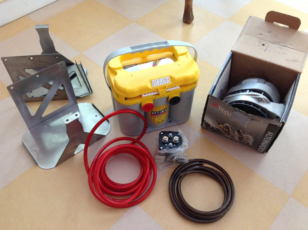

    Is it a direct bolt in? Do you have a link you can share?

    Yep lol.
    Pretty much. You have to add a couple washers on one of the mounting points and upgrade your wires but other than that it fits right in. I ordered the special harness off of eBay so I don't even have to splice into my factory harness. It converts the plug from Toyota to GM.
    Here is a list of links for the swap. I pulled this straight out of Blackdawg's build thread.
