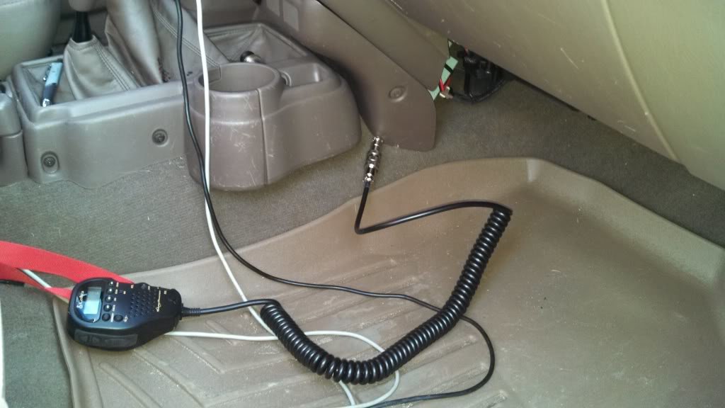

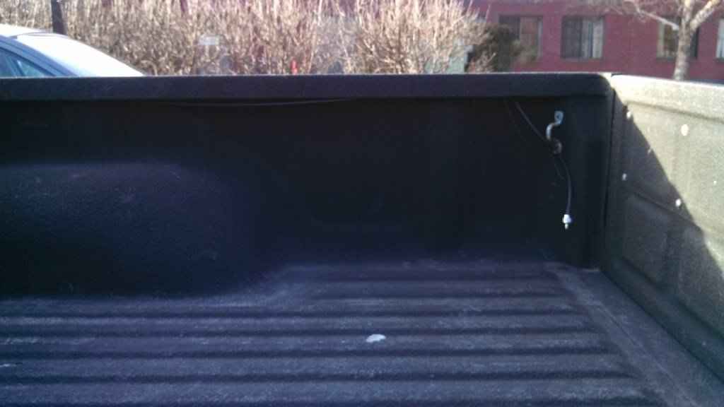

    Installed CB last night:

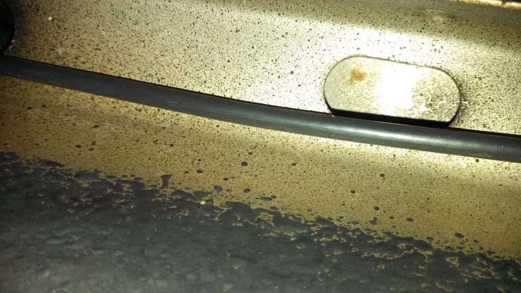

    Ran coax along firewall, behind passenger side kick panel, under door sill plate. From there there was enough room to shove it under the rear pass side panel, up under the junk catcher, and then through the hole adjacent to the rear pass seat belt anchor point into the tire iron cubby. Then out the grommet in the rear of the cab, up through the cavity in the front pass. side corner of the bed to up under the pass side bed rail. Under the bed rail there are a bunch of equally spaced holes on the lower layer of sheet metal. I threaded some zip ties between them so the coax is hidden up under the bed rail. :
    One of the sheet metal holes:
    Just waiting on my antenna mount which will go in the rear pass side corner over the tie down cleat.
