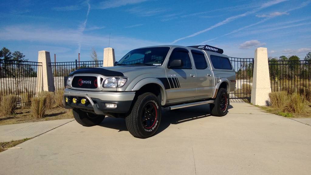

    so i wanted to try something different on my truck. its plastidip and peels right off but i kind of like the way it looks. opinions?

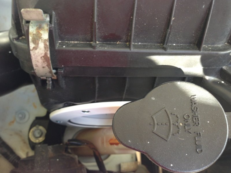

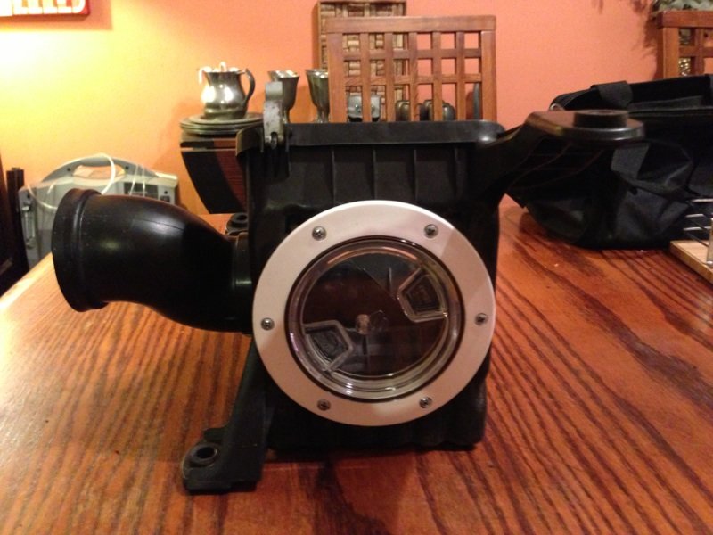

    Today yielded a productive day on the tacoma.

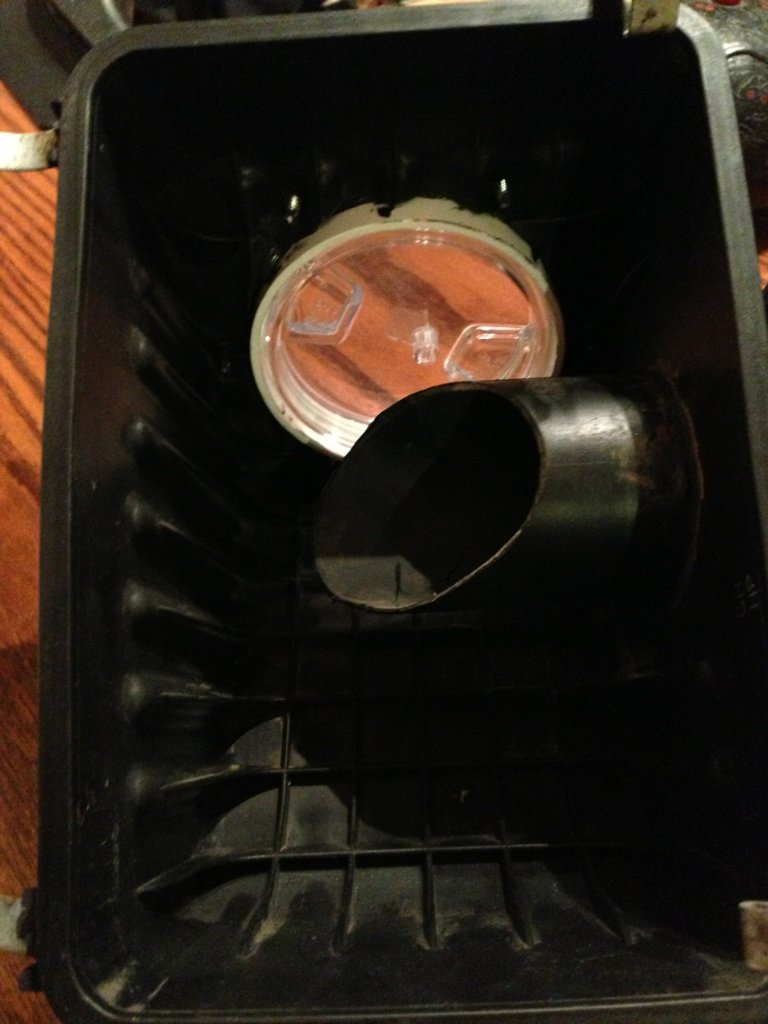

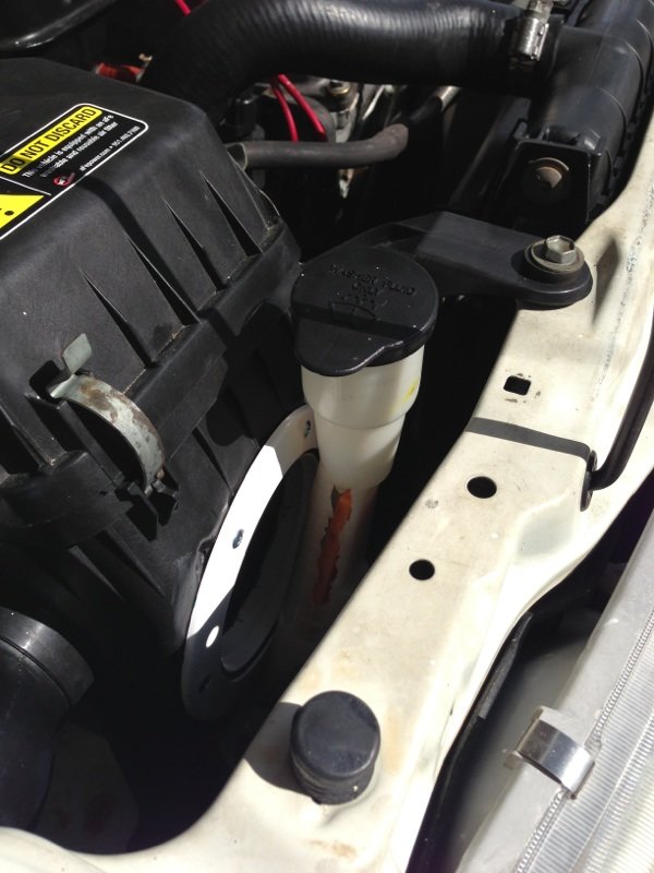

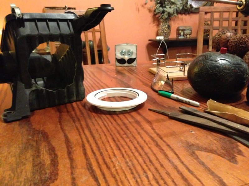

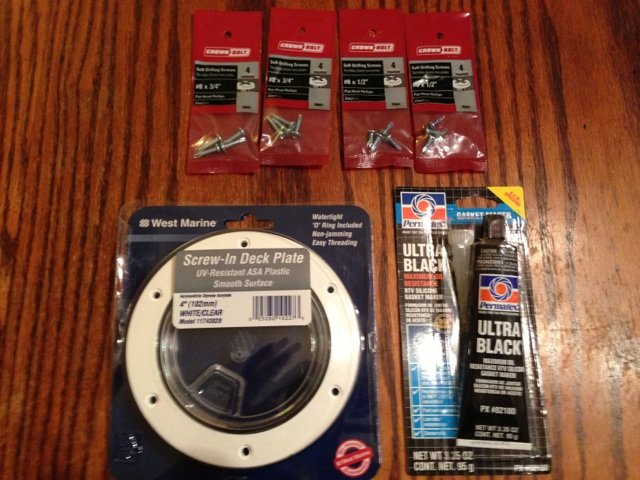

    Did the Deck Plate Mod. Got the deck plate at West Marine. Black RTV at auto part store, and 3/4" #8 self-drilling/self-tapping screws at Home Depot.
    Hole cut and filed, ready to install.
    Deck plate installed
    In truck. (Yes, I know I need a new washer fluid reservoir.)

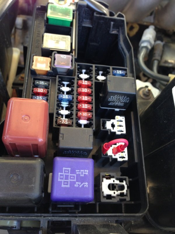

    Next up was the simple Power Outlet Mod. Which enables you to have power at the outlets without the key turned. Really nice for when you're trying to charge your phone and not in the truck.

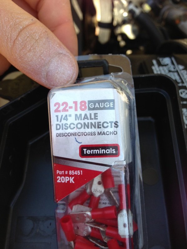

    Had some male connectors and wire laying around

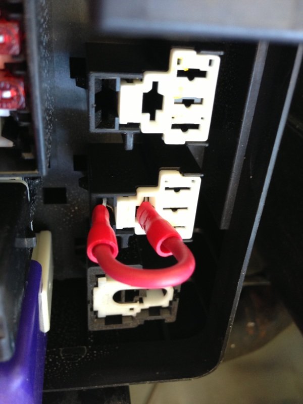

    Pulled the fuse, and placed it in the spot above the power outlet, where there wasn't anything drawing power to keep as a spare. Placed the two male connectors in, and tested it out, phone charging and key in my pocket.

    Nice! I think I'm gonna order up a deck plate soon. So did you seal the inside of the airbox to make it air tight rather then sealing from the outside?
  11. Feb 18, 2013 at 3:12 PM
    SpeedoJosh
    SpeedoJosh Well-Known Member
    Aug 15, 2011
    #61730
    2,300
    Florida
    2010 Access cab, Base, 4x4

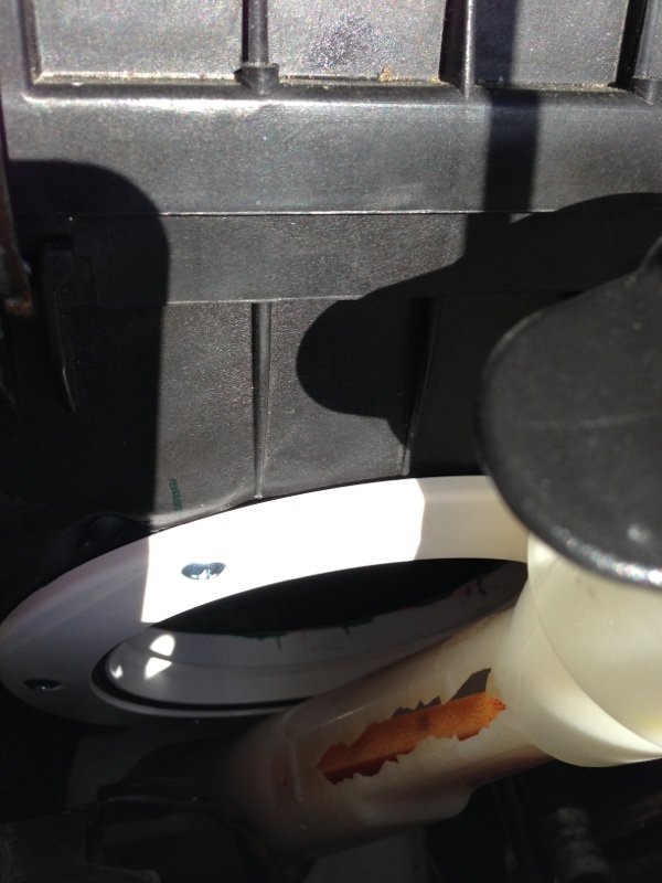

    I have the 2.7, so I have a ribbed air box. So I glob'd a lot of RTV in the ribs to fill the space, then put a bead all around the outside of the hole on the air box that was covered by the 1" lip on the deck plate, then a bead around the lip that sits inside the airbox. Then after I shoved it in, there were two spots that weren't as close as I'd like, so I put some RTV in those spots as well. In the pic you quoted,
    you can see a bit of RTV that was pushed through when I tightened it all up. I cleaned off the excess before it dried.
    I wanted to keep the amount of RTV on the inside of the box minimal. I feel it's as airtight as could be, but if you think about it, there is a 4" hole right there, so a tiny spot that might, just might, not be airtight isn't going to matter. Maybe, just maybe water will get in there if I submerged the truck up to the air box, but if I was in that deep, I'd be eff'd anyway.

    Makes sense! Looks good man. Thanks for the tips.

    i think i would have fiberglass the edges of the deckplate instead of using RTV imho
  14. Feb 18, 2013 at 3:20 PM
    45acp
    45acp Paint me back in Wyoming again...
    Aug 9, 2009
    #20861
    6,705
    Jonathan
    Boring, Wisconsin
    1981 Long bed 4x4
    I thought you were supposed to use sensor safe silicone?:confused:
  15. Feb 18, 2013 at 3:22 PM
    Slodgetto
    Slodgetto Über Posre
    Jan 18, 2011
    #49483
    9,276
    Silas
    I think you're right... Supposed to use the blue RTV so it doesn't screw up the MAF sensor.

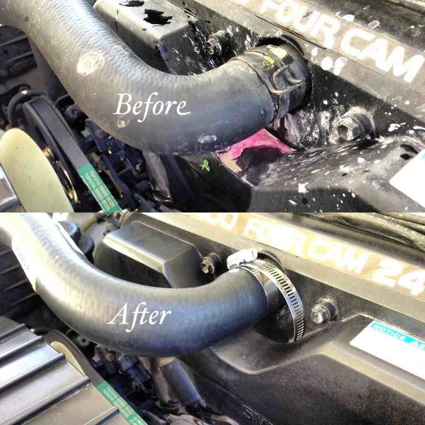

    Replaced the upper radiator hose and the air filter. Cleaned the battery connections. ImageUploadedByTapatalk1361229727.249698.jpg

    I think this is correct. But I saw a video and the guy said just as long as you let the sealant dry for at least 24 hours before installing back into the truck because the fumes is what screws with the MAF sensor.

    You are suppose to use sensor-safe RTV.
    If you zoom in on the pic that has the Black RTV still in the package, the last bullet in the blue section says, "Sensor-safe". I read other's write-ups and they also used black RTV.
