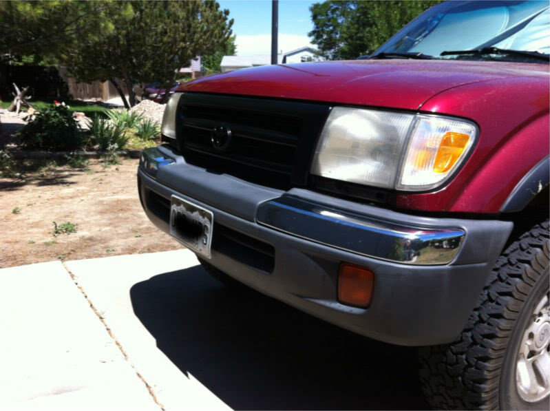

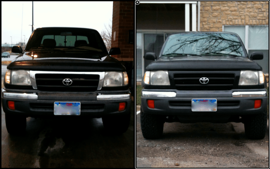

    Use vinyl dye.
    It's much easier to use and more permanent.
    before and after:

    What did you use on your grille?
    Does the vinyl dye spray on and wipe off?

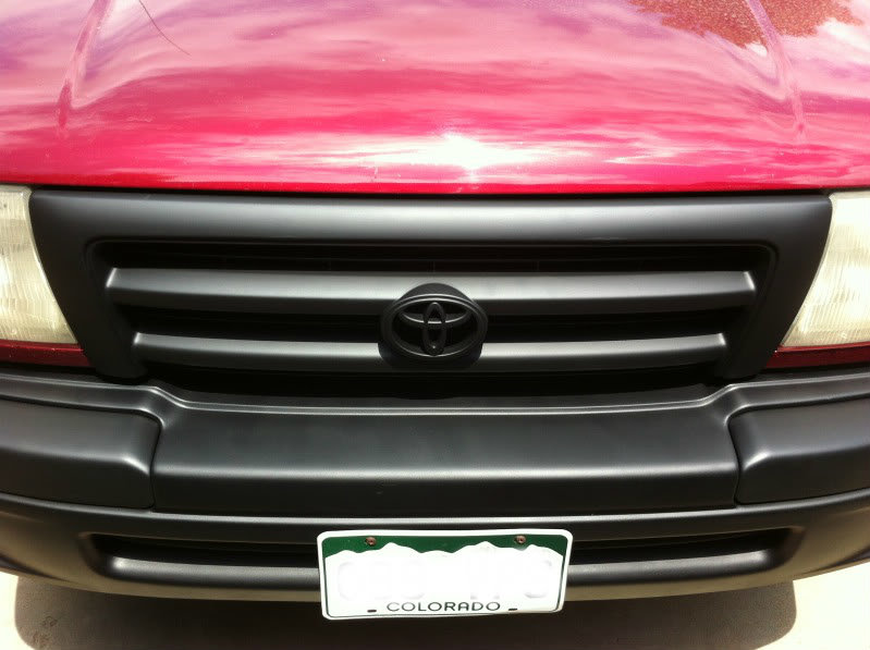

    1. I used sand paper (320 grit) primer and spray paint. That's semi-gloss in the first picture and flat in the second.
    2. It sprays on and absorbs into the material. The lower valence is a perfect medium to use this vinyl dye on. For the chrome inserts use the method in step 1.

    Have you had any problems with flaking? I put 3 heavy coats on mine and it looked great. I went mudding and left the mud on there for a few days and it seemed to have pulled places off when I washed it. I thought it was supposed to dye the plastic but I can see the original bumper clear as day in the flakes.

    sounds like bad prep before painting..

    I haven't.
    I wheeled after doing and dug branches into the lower valence and literally got tears in it.... the dye absorbed so well into it, the material exposed in the tears was flat black as well.
    If I wash it, it looks like the day I sprayed it.
    Like Monte said... prep? I washed it, dried it, then used the Duplicolor prep wipe on it before dyeing it. And the whole time from wash to dye I was wearing latex gloves to keep the oils from my skin off it.

    I washed it multiple times and quit putting armorall on it long before I redid it. I didn't use acetone or anything though.. Still I was under the impression that it was supposed to dye the material rather than just cover it. I'm not too worried about it though. I have plenty to redo it with I just don't want to have to keep redoing it. Hence why I went with the dye instead of paint.
