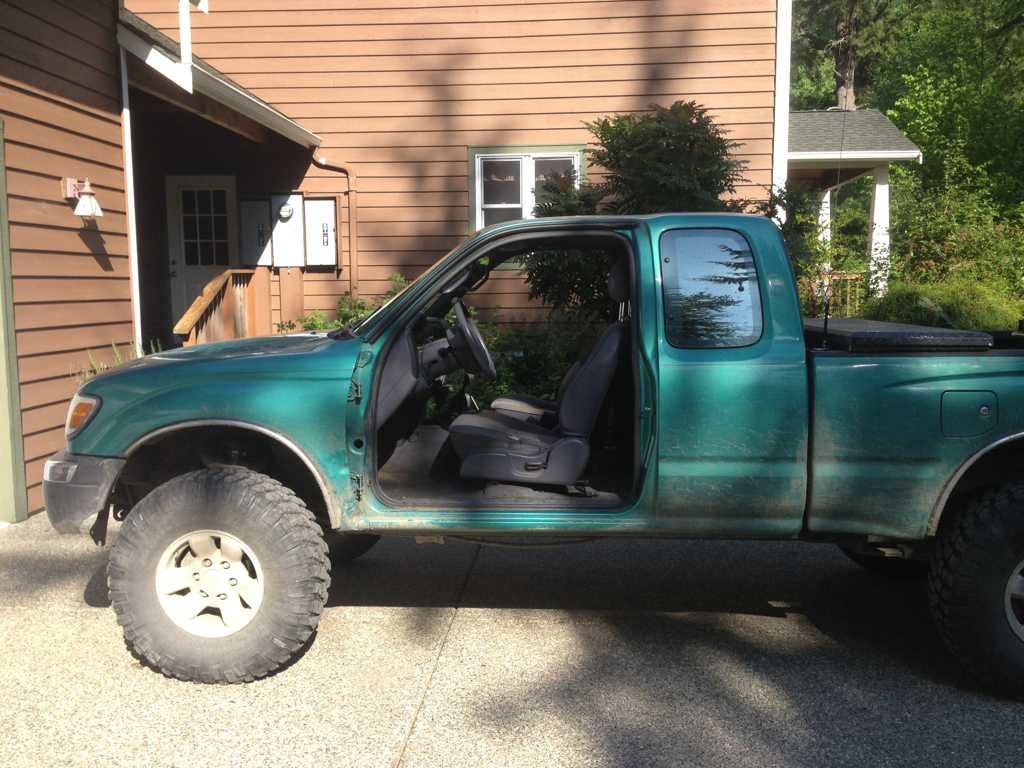

    Is it illegal to drive on highways and town with no doors?

    I wouldn't think so, Jeeps do it all of the time.

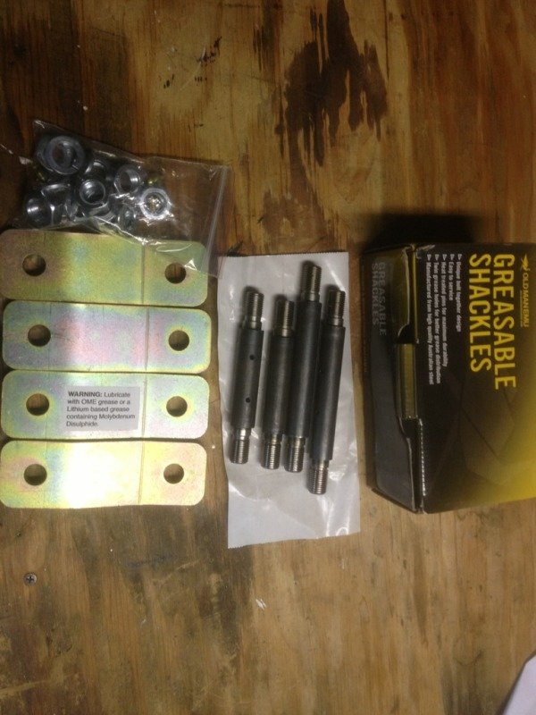

    So here's my dilemma. Here's the shackle kit and everything that was in the box.

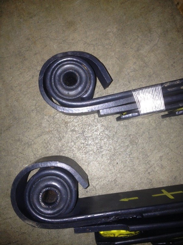

    Heres one end of the springs.
    19F357EA-F0EC-4B0C-8929-9BD7E236A284-206_6d7b881479e61ffe5690580c80e10236a8c4460c.jpg

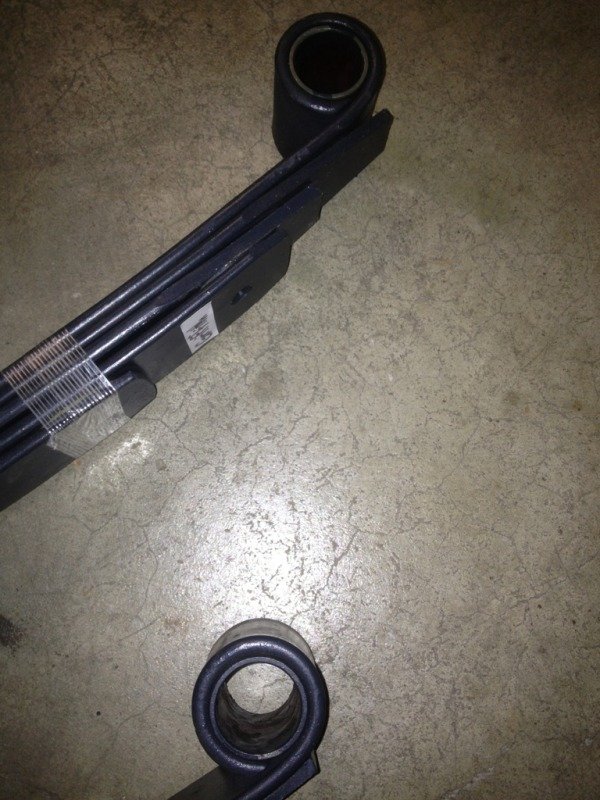

    Here's the other end.
    B89085E6-9493-4560-BE74-2CB4E4CDEF22-206_2964b9c5f366019ae9d70a3ecb08484d4318c13f.jpg

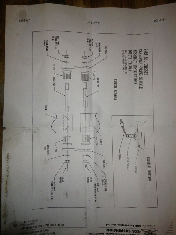

    Here's the instructions with the shackles.
    0B06846A-70C2-46FB-9EF2-1CA444081C4C-206_17861ced098338fafbd275fb0c46a262635223d1.jpg
    Don't I need something that goes over the shackle bolts between the shackle plates? Because I have nothing in the kit.

    You are missing the rear spring pack bushings. They don't come with the OME leaf pack.

    Looks like you're missing your bushings for the shackle end. I had to order them separately for my OME Dakar springs too iirc.

    Ok that's what I thought I need. I thought they came included on the full OME kit from wheelers. Dan is saying he saw them in the box he shipped me, but I think he may be confusing them with the rack bushings I ordered. This could be kind of crappy. This weekend is the only one I have off for a while that I can see :/

    Call Dan back. He'll make it right.
    We had a mod day long ago and ran into the same issue with another member. I ended up making bushings from a bunch of misc shit we got from summit racing that we had to cut and grind to fit and made our own sleeves from scrap. Giant pain in the ass because the OME eyelets are metric.
