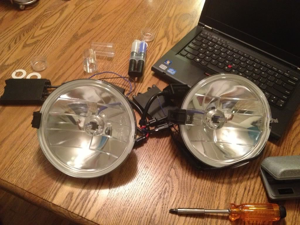

    Up converted my hella 700ff's to 55w 6k hid:
    0B39C425-1495-4590-A290-C4EE080D4324-151_456c78a221cf7021ca3802fb4d1c3581b8e9b0be.jpg
    Installation coming this weekend.

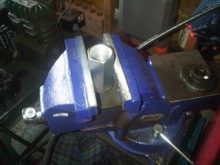

    I finally got myself a big boy job and decided the truck needed some love,

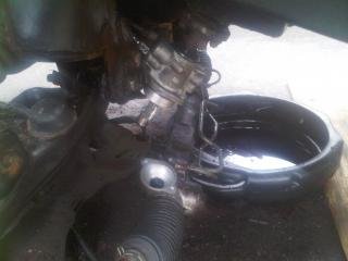

    the Power steering had been leaking for what seems like forever, so i ordered the seals for it,

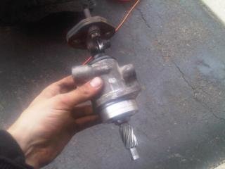

    it was leaking out of the top of the gear housing, so i just pulled that section and resealed it.

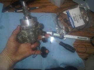

    i had to make a special tool to remove the aluminum cap.. its like a 32mm 8 point hollow allen key....
    I just bought this... a 7/8" coupling nut.. drilled out the center to 1" and ground the tips to make it fit in the 8 point section of the steering gear cap. worked perfect.
    put it all back together and re-installed

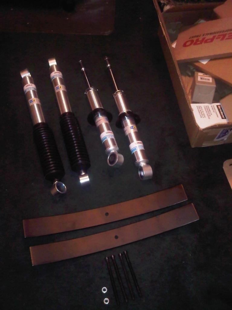

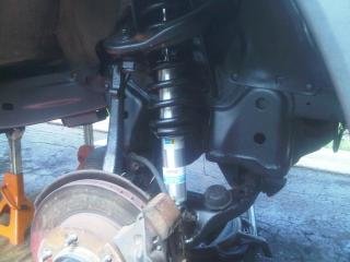

    I also bought a full set of Bilstein 5100 and some cheap add a leafs to go in for the time being until i can buy a better setup/leaf pack

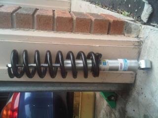

    I managed to get the fronts installed today.
    I will be installing the rear shocks and leafs, I also bought a valve cover gasket set
