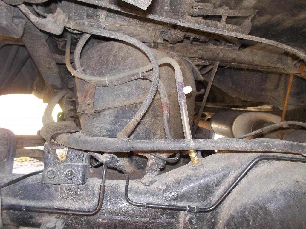

    there you go
    Often they rust and clog and can no longer vent. when this happens the easiest route to vent pressure happens. thru a seal
    For water the stock vent will suck water in if you go deeper than the axle so extending it will solve this and the stock vent is re-routed

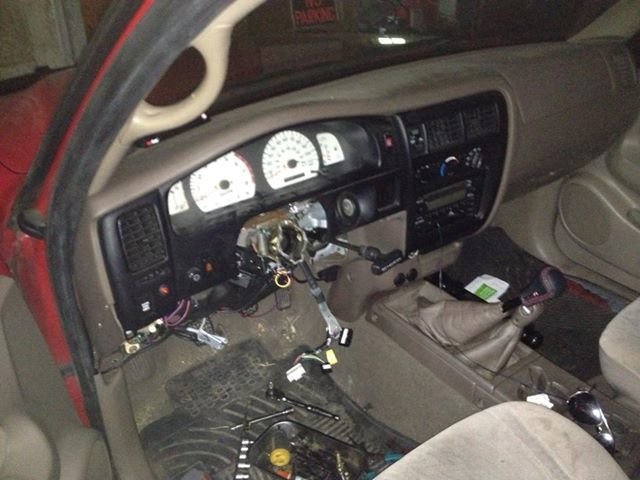

    did u do the test before hand to see if that was where the play was?

    To be completely honest, it didn't seem like there was any play at all but I figured why not do it, I had the time and it's not like it cost me anything. And if anything else at least it can't ever work its way loose.

    So, this means you can never adjust the wheel now right?

    Yeah, the hose fitting just above the cable is where I can see tension. Makes me think that if I get any flex at all in the rear end (not likely, but I'd rather play it safe when it comes to brakes), it will really be under strain.
