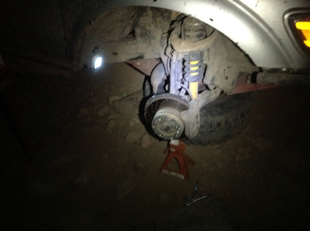

    This happened to my friends Tacoma, only we discovered the trouble out on the trail when the whole wheel assembly pulled away from the LCA. :eek:
    Two bolts were totally missing, one was sheared off in the sprindle and one was pulled out, stripping the threads in the process.
    Putting thru bolts with a nut on two of the four bolts might work but there may be interference with the outer CV boot. Ultimately, had to remove the spindle and put a heli-coil in the stripped location. This might be something you can try.

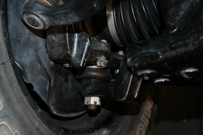

    At my last lower ball joint change I put a dab of JB Weld on the edges of each mount bolt. This allows for a quick "at a glance" visual check for loosening, nothing to do with retention.
    The bolts are properly torqued with thread locker but if the JB is "broken" I know to check them further.

    I like that idea. I think I will do that once it's fixed and put back together to help prevent this from happening again.

    Nice telltale. Yet they are still only as good as the human is at remembering to check them. I am beginning to think these should be through bolts nutted on the top, or better yet, with drilled bolts and castellated nuts, or drill the bolt heads and use safety wire (aka lock wire).
