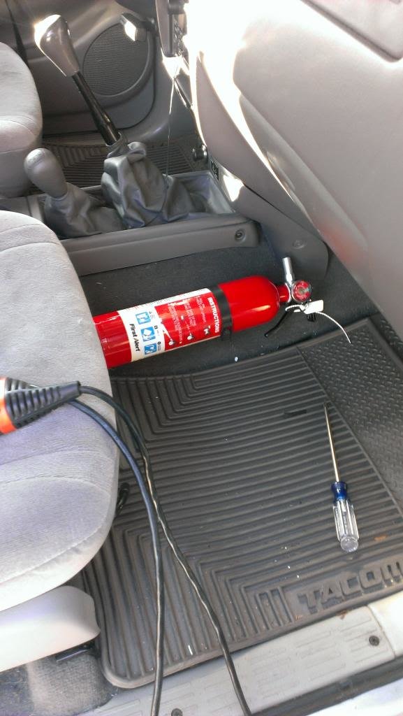

    I did this FWIW, the nozzle is down now though :eek:.
    I also run one in the bed when I don't have my topper on.

    is it through bolted? how did you reach the backside next to the tranny?

    I just used sheet metal screws and fender washers under bracket.
    I did have to make a spacer out of aluminum tube because the front part of the base is about 1" off. I'll take a picture if you need.
    Only suggestion I can give if you plan on going this route is to be careful when drilling for the holes. The insulation under the carpet can be a bitch when it gets twisted around the drill bit lol. Ask me how fun that one was.

    I learned awhile ago... if drilling through carpet or the likes, always cut away the spot with a blade first.

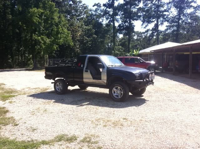

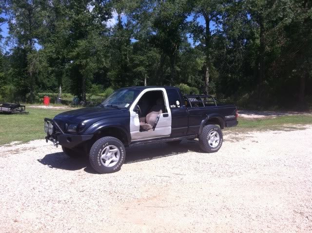

    Decided to hack on some sheet metal today.

    So :jellydance: i would much rather have those than tube doors

    Yea I started to make me a set of tube doors but I've always been a fan of the way half doors look so I went that way instead.
