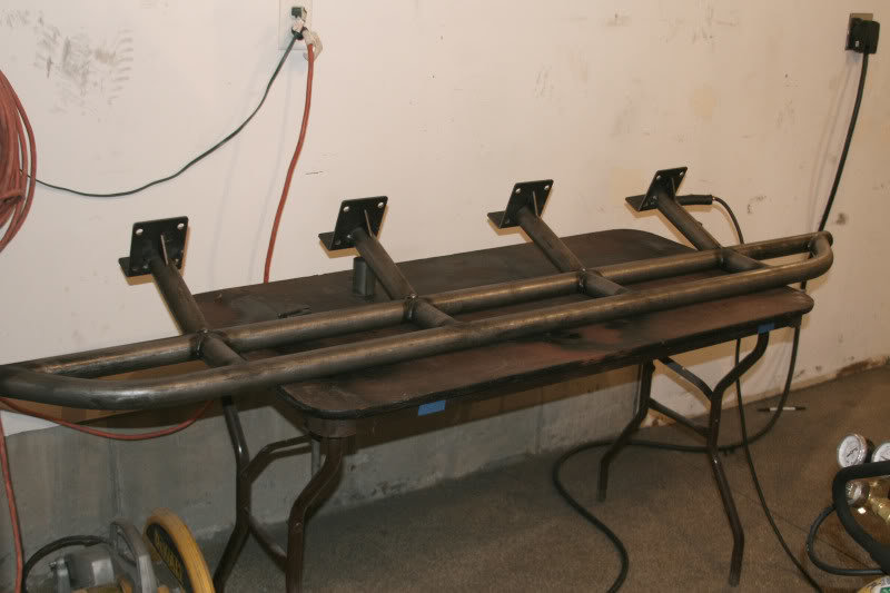

    gussets.
    I believe they go on top (might be the bottom) of the slider leg, and sit flush with the plate....

    The gussets are usually on top of the tube, against the frame plate to strengthen the mount and reduce the chance of you bending your sliders up into the pinch weld when you come down on something.

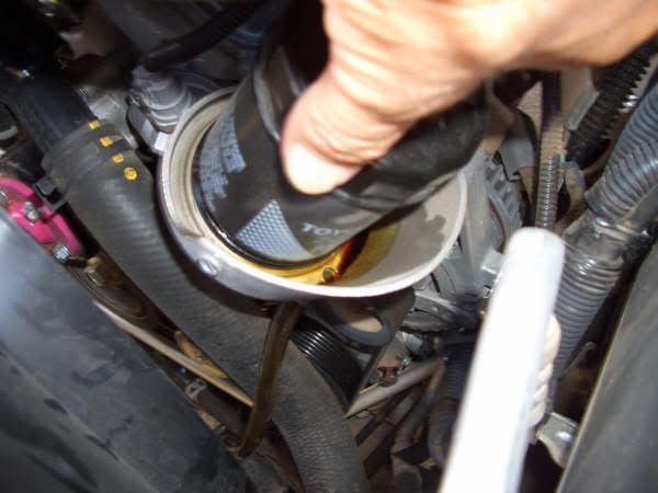

    On a side note i installed my Bud built skids, changed my oil & cleaned my air filter.
    Wile changing my oil I had an epiphany of something that every 3.4 owner must have. I'm working on a design ASAP and should have a product developed in the next month or so :spy:

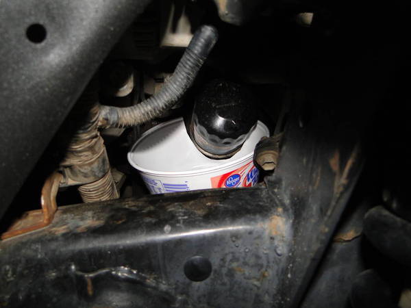

    would it be something similar to Tony's 'cool whip mod' ?

    It's already been said but just to confirm, those are the gussets. It's important that you use those to reduce flex in the slider so it doesn't contact the body when you put the whole weight of the truck on the slider.
    here's a shot of mine. You can see the little triangle on the top of the legs where they connect to the frame plates.

    Dammit Tony thought of it first :rolleyes: but really it will be a bolt on Oil catch so we don't get oil everywhere when changing the oil on your trucks. It shouldn't be too hard to fab up so I can keep the cost low. I'll let you guys know when I have one built tested.

    I just cut the top off a gallon water jug, and drop the filter in there too :D

    I use a plastic salsa tub and rag. But something in titanium or magnesium with a braided stainless drain hose with a remotely operated pump and a surge dampener and quick shutoff cam-activated by an oscillation overthruster would probably give me a couple more horses. Especially if I plastidip it.
    For my 93 22RE, I got a little angled offset funnel with a drain hose and carved out part of the funnel to fit under the filter/against the block snugly much like the cool whip bowl above...

    Yep kinda like that.
    Now how I'm I going to make anything of that idea ;)
