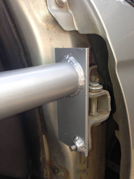

    Look at build!
    Did you use quick disconnect or do you bolt and in bolt them every time?

  3. Jul 11, 2013 at 8:44 AM
    Littlebro 5
    Littlebro 5 Well-Known Member
    Jan 15, 2011
    #49292
    737
    Tyler
    Wilsonville or
    01 4x4 3.4L sr5 manual all-pro lift
    6" deck plate mod, sweet bed bar.
    sorry about that guys.
    yes they bolt on but its not bad to swap them out.

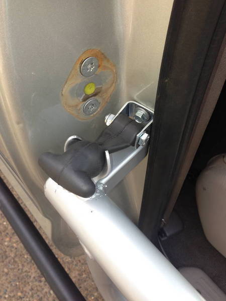

  4. Jul 11, 2013 at 8:48 AM
    sk8rjess
    sk8rjess IG: @whoishack
    Jul 5, 2009
    #19286
    2,303
    Cody
    Nashville, TN
    02 4x4 sr5
    some duct tape and zip ties
    that's a different approach, but you said you didn't have to "cut" into the body. wouldn't drilling be considered cutting? sweet though! curious how much pushing that rubber would withstand
  5. Jul 11, 2013 at 9:22 AM
    Southern01Taco
    Southern01Taco Well-Known Member
    Jul 20, 2010
    #40457
    1,957
    Sean
    Holden, La
    01 V6 4x4 Xtra Cab SR5
    I take it that you unbolt the rubber latch when you change doors? Also to make things a little easier on you, you might want to consider putting some quick pins in the hinges so that you don't have to realign the door when you swap back. You just need another set of hinges and some pins with a hole in the bottom with R-clips. The way I have my half doors setup, I can change them in about 10-15 mins., maybe quicker than that. I need to time myself one day. Check out my build thread, I think I posted a picture or two of my hinges.
  6. Jul 11, 2013 at 9:33 AM
    Littlebro 5
    Jan 15, 2011
    #49292
    737
    Tyler
    Wilsonville or
    yeah just take the self taping bolt out and plug the hole.
    yes the pins would work nice and fast, the bolts that go into the door (not the cab) are self centering so as long as you leave the hinges on the truck you will not need to center your door. and with the doors bolting on they are solid.

  8. Jul 11, 2013 at 9:48 AM
    sick 3.4 tacoma
    sick 3.4 tacoma Well-Known Member
    Aug 16, 2010
    #41803
    429
    Eric
    portland Oregon
    2003 double cab 4x4
    elite bumper, xrc8 winch, 12in sub, cb, flowmaster, deck plate mod, 3in lift.
    as for no cutting and such you can just mount the door latch for the tube doors to the stock latch so you dont damage the body thats what i did for my rear doors and i plan on doing for the front doors
