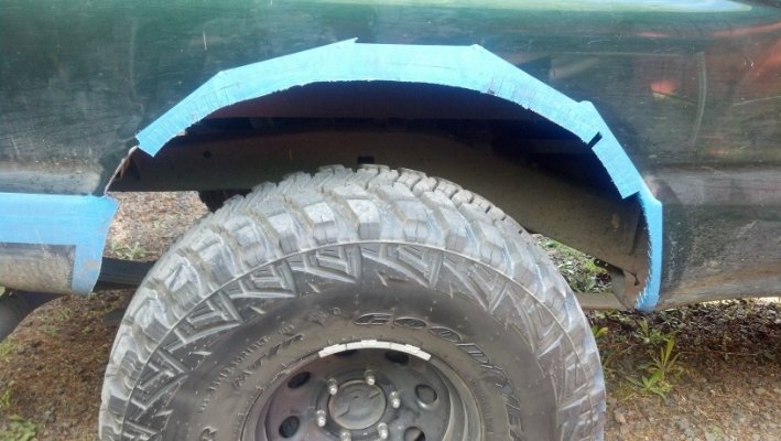

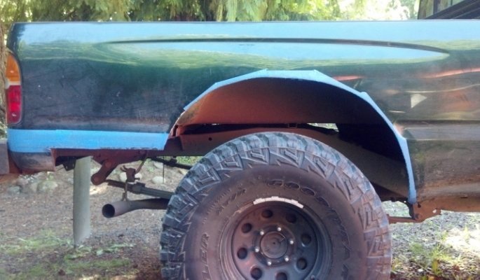

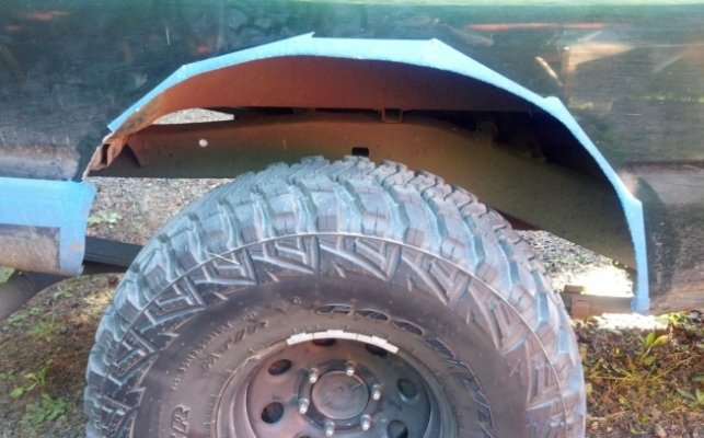

    whats the secret to keeping an even consistent arc while you cut?
    or ill ask, how did you measure and mark it so it is even cuts? like if I want to cut 1 3/4" how do i make sure it is 1 3/4" all the way around
  3. Jul 12, 2013 at 8:53 PM
    Blackdawg
    Blackdawg Dr. Frankenstein
    Dec 31, 2010
    #48500
    81,618
    Monte
    Wyoming/St. Louis
    The Trifecta of Taco's
    Make a line in a perfect arc. Take a tap to cover the 2-3" of the fender. Then with a pen and a dowel or something to attach then pen to it about 2". On the other end of the dowel or ruler have something to catch the lip of the fender. Then just trace the fender. Will be an exact replica of the fender lines 2" or however deep you want on the tape.
    Cut to the line. Done.

    that made no sense. i gotta see a picture or something

    Hey it works great. What I'm gonna use.

    wow man that tool is way higher tech then what i did
    just finished the gas tank side, ill post when its light out.
    2" was the max I`m right against the fuel door recess
