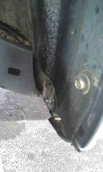

    The shocks in the rear are aftermarket and the fronts are factory as far as I can tell. My leaf springs almost lay flat on my overloads and my bumpstops are very good friends with my frame! There is a distinct clean spot on the bump pad thing on the frame from where the bump stop hits it so much haha.

    And your low backspace is???
    On an IFS Taco, ride height, high, low, sagging or new has absolutely nothing to do with tire rubbing with in the suspension travel, again nothing. The suspension travel has not changed, only the point where rubbing may or may not be encountered.
    As far as power, half an inch change in tire radius can be thought of as about the same as the difference between a new tire and the same tire bald.

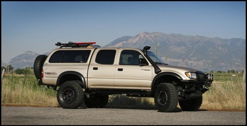

    Decided it was a good day for a bath and wax.

    Adams truck always looks so clean. what I would give for that clean of atruck

    It's less than 3.5". Like I said, it did not rub on stock wheels but my ride height with stock suspension and my MT wheels cause rubbing issues on level ground. If I were lifted or even just not sagged I would NOT have these issues on level ground but rubbing would still be an issue when offroad.

    You'll be fine. Won't notice I bet.
    Less BS cause rubbing in the fenders more. Not pinch weld..I know this well..ha
