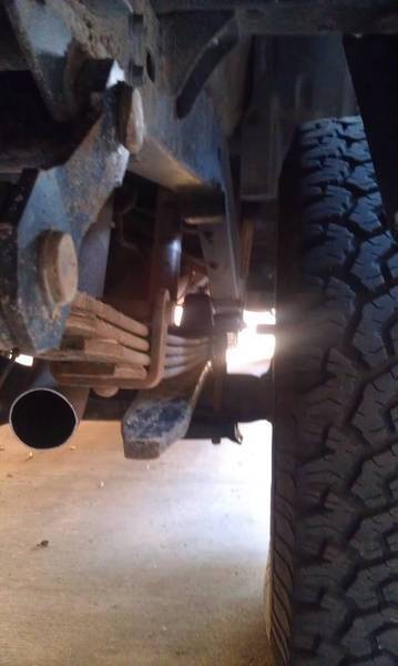

    Also starting to think about an AAL/shackles for my Wheeler's 5 packs.

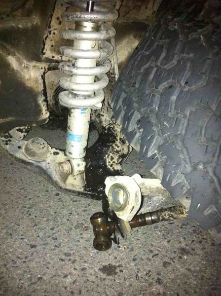

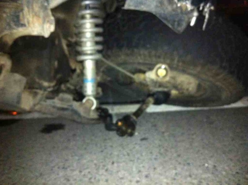

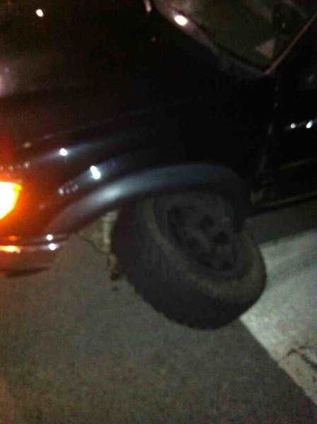

    Either upper or lower ball joint let go causing one to separate. Thank god I had just gotten off the highway. Long story short some poon saved me from wrecking it on the high way

    Fuck dude, glad you're okay.
    Seeing all these happen lately prompted me to change my original (180k) lower balls. My uppers are good now, complements of all pro.

    I am more than capable of doing it myself but this one is on Toyota. My upper is stock 120k miles. Lower is 5000k napa ones. Big quality difference

    ^Wow. When I saw the thumbnail of this picture, I thought you had the best IFS flex I've ever seen! Clicked on the link, another ball joint failure, no good.

    Yeah, I should of taken a picture of how nicely the rear was flexed out with the front like that....

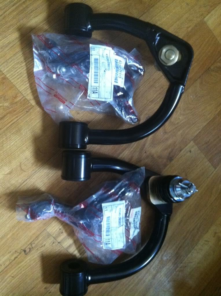

    Wow am I glad these are now here and ready to be installed

    replace them when the boots rip or when they become loose. Also always use locktite and a torque wrench when installing the LBJ.

    Makes me wants to go install all new ball joints

    If you have play in your steering its a possible sign too

    Ya mine is too that and my ball joints went out, I'm not looking forward to the bill :(
