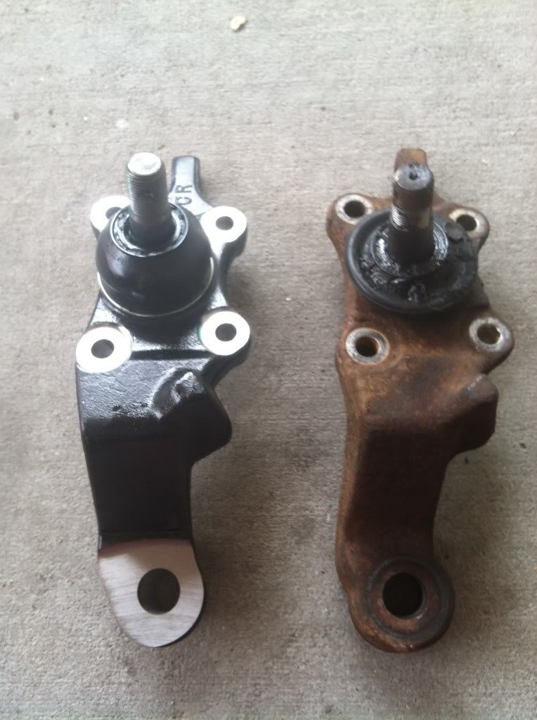

    I'm worried that once I get the old one out, I won't be able to get the spindle and the new ball joint back together because of how stiff my springs are.

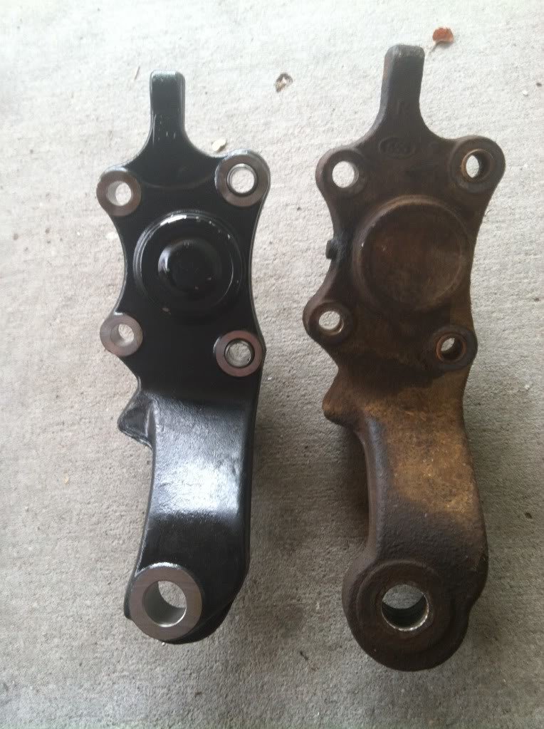

    Do you have basic sockets, pliers, and a large-ish hammer?
    Then absolutely, you can do it :cool:
    After tire is off, it's just the 4 lbj bolts attaching it to the spindle, the one big lbj bolt/castle nut attaching it to the lca, and the bolt/castle nut attaching it to the tie rod.
    The tricky bit is popping the two big bolts out of place once the nuts are off (especially the tre bolt). The one attachin the lbj to the lca is pretty easy: just re-thread the castle nut on, upside down, until the end is flush with the end of the bolt (to protect the threads) and beat with the hammer. It should pop loose.. For the second bolt attaching the lbj to the tire-rod, you can't just wack the bolt since things will just flop around... Find something solid that will sit on the ground and support the lbj while you hammer the tie-rod end bolt. (don't forget to re-thread the old castle nut on part way) I usually use a piece of 1/4" stock for this.
    Re-install is even easier.

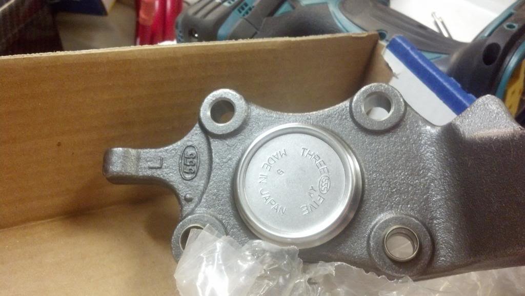

    Every thread I've read, and Jace's advice, is to get the Moog's from rockauto.
    I also see posters swear only by OEM.
    If I don't beat the piss out of them, should Moogs be good enough for me? For roughly 1/3rd the price I'd lean towards them. Plus I highly trust and respect Jace's opinion.

    I Went With Moogs, Seem Good.
