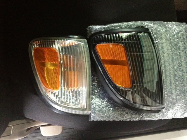

    Tried to install some black corners I got off ebay and boy are they a POS. The bulb sockets didn't even fit in the lamp assembly, kept falling out.

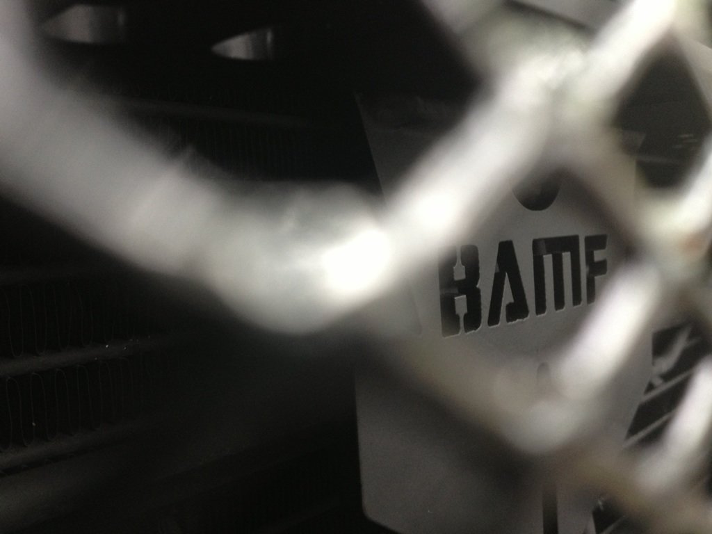

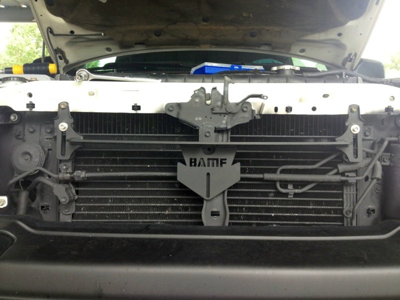

    Anyway... finally mounted the BAMF light bar getting ready to wire up my Blitzpro's in the next week or two.

    For those ebay ones, get some thin rubber band an wrap one around each of the bulb sockets. Worked fine for my ebay clear corners, it made them fit tightly.

    Good idea. But for some other reason the little peg thing on the bottom, backside of the assembly wouldn't snap in to keep it in place either. I guess I'll try give it another shot tomorrow.

    Yeah, thats the trouble I had with them, so I dug through the 100 pack of rubber bands and wrapped one around the socket in front of the rubber gasket. That made those tabs hold tightly, Just don't have a rubber band too thick so that you bust them off trying to get it in there.
    I have not had any water entry in my corner lights either.

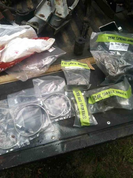

    Picked up some front & rear 5125's and unbolt flip kits, shock re location crossmember, couple sets of leaf packs etc..

    Was a little bummed I had no luck with fitment and such the first time but I went back out there and your rubberband idea worked! Also finished up a few adjustments on my light bar.

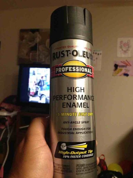

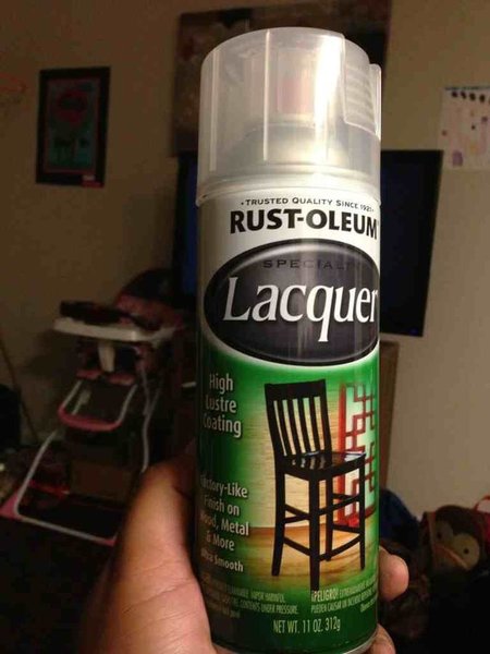

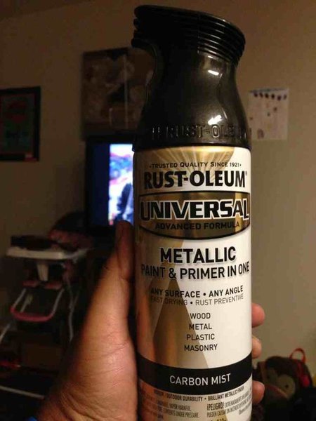

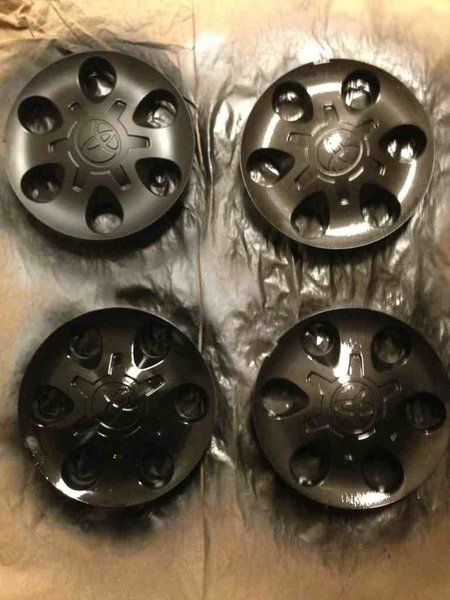

    Painted center caps of my stock wheels. I'm debating on colors...
    Top left = Flat black
    Bottom left = Flat black w/ clear
    Top right = Carbon Mist
    Bottom right = Carbon Mist w/ clear

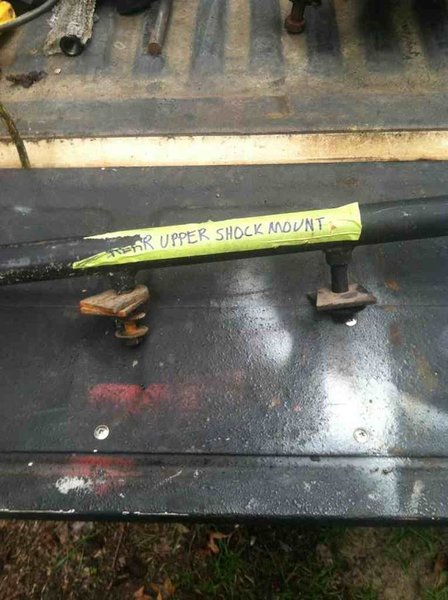

    Got any pics of the crossmember? I'm boxing my frame and building my crossmember tomorrow so I can put my 5125's on and finish my chevy 63 swap. I know how I want to build mine but I'm still looking at other designs too

    This is what I got with all the junk I picked up today but ill probably cut some plate and weld it to the frame and box the frame around the crossmember..
    Doesn't show it all but there are two bends (one on either side) but there's nothing to it really.. Straight tube with shock tabs would be just fine..
    Above the 5125 to the far right is the bend in it..

    I got some 1.75" tubing that I'm going to put two bends in to get as much height as possible. How much travel are your 5125's? Mine are 12". I want to mount mine using the mounts like you have on the cross member rather than using tabs but we'll see...

    They are 10".. Didn't even expect to be getting any rear stuff just front leafs and shocks, mounts etc.. But my crossmember is probably 1 1/4 maybe 1 1/2" tubing but if I built my own I'd use 1 3/4 as well since that's what I'm using for sliders, bumpers tube doors bedrack etc. the crossmember is from TG that I have as is everything.. Except to two random sets of leaf springs I have that I don't know what they're from but one set looks like 63's so I may get lucky haha

    haha thanks, glad to help.:)
    If it ever gives you trouble though, I just realized I may have put it behind that rubber gasket and used it as a spacer. It should be fine though.
