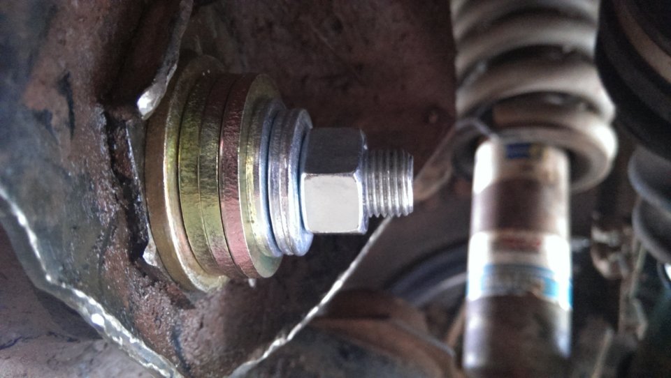

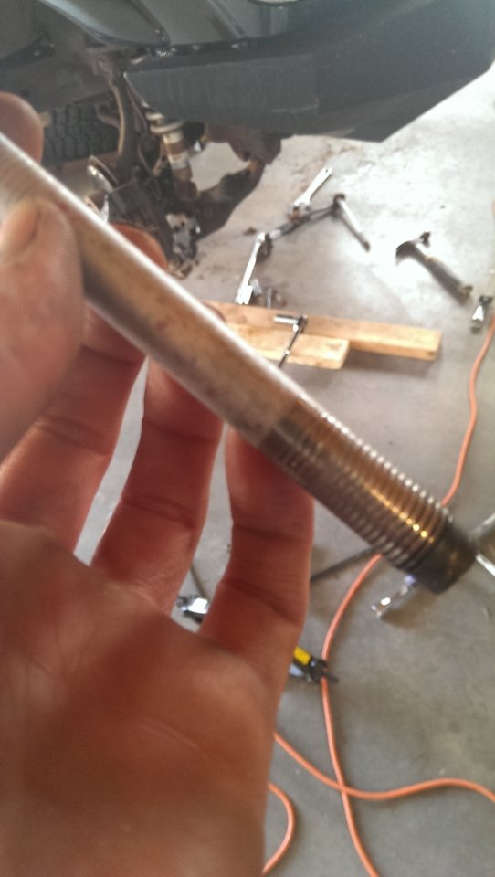

    -Got an alignment
    -Was notified that my passenger side cam adjuster bolts were stripped (long story involving a shitty alignment experience in the past), quote $520 for parts plus labor+Alignment
    -Left town for a week
    -While out of town, bought Cam's for ~$100, didn't order bolts (oops)
    -Tried to PB Blaster, hammer, pull, press out the old cams but they're seized beyond belief.
    -Didn't have time to wait for more parts, saw-zall out the old, press out the remainder and install 'new' before driving 500 miles the next morning.
    -Got some 1/2"x20x5" bolts, 7/8 - 9/16 - 1/2" washers and rigged them up to provide enough clamping force to hold that damn LCA in place.
    -Got another alignment that could only be 'close' according to the techs (it was 5pm on Friday, i didn't push for perfect)
    -Ordering a new LCA+bolts then cutting out the old and installing the new then... ANOTHER ALIGNMENT! Dealing with a slight pull and shake until then.
    And while doing this I pulled the Drivers side hub+UCA and dropped it off at a local shop to get the old bearing pressed out and the new OEM Toyota bearing+all associated parts installed.
    All without 1/2 the tools i usually have in my garage at home and no second set of hands. Phew. That was a long two days.
