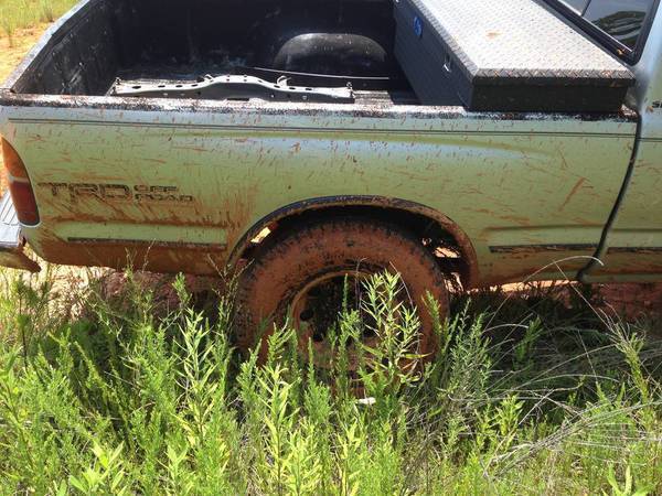

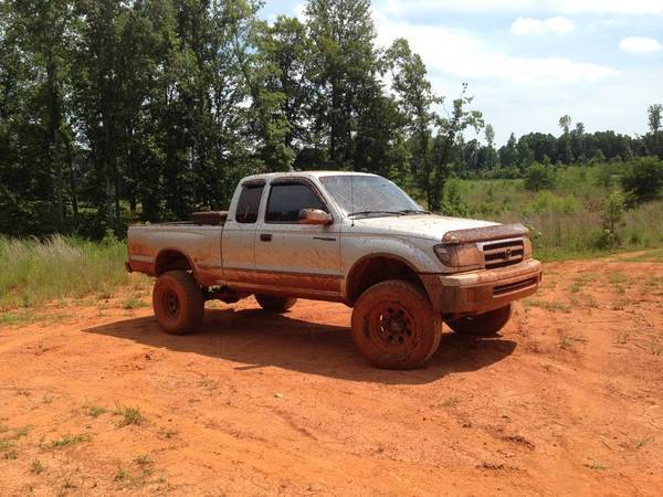

    Played around a little bit today. Wanted to cycle the rear suspension just to double check everything I've been building. How close is too close to overextending a shock? At full droop my shock is at 29" eye to eye and full extension on the shock itself is 29.95". Anyways here are some pictures:
    Full droop. 1/2" off the ground in these
    Full stuff

    I'm not running them but I was planning on it so I did all my hw. Hardest part is tubbing the front which isn't really that bad. Then you'll have to trim the fenderwells too. Most open them up 1 3/4". Also gears are needed. Haven't read up on your build in a while so I'm not sure what you're running but most run 4.88 or 5.29. 4.88 is closest to stock but 5.29 gives you room to step up to 37's later if you want to.
