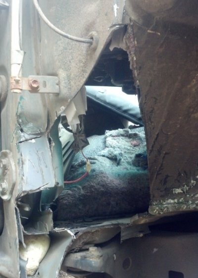

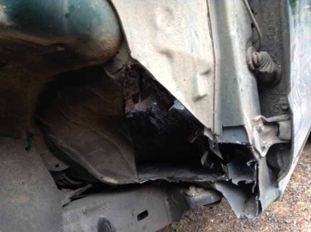

    Yup. Hit a jersey wall.

    Go to get alignment- replace whole front end
    Debadged and painted, plasti-dip bumper , Sock monkey decals, tool box, K&N cold air intake, flag holder/fishing pole holder, Satoshi, magnaflow 40 series, spidertrax wheel spacers, map lights, led reverse lights, led dash assembly lights, roof top LED bar
    Glad to hear the Tacoma will make it through!
    :p Glad you made it out alive!:thumbsup:

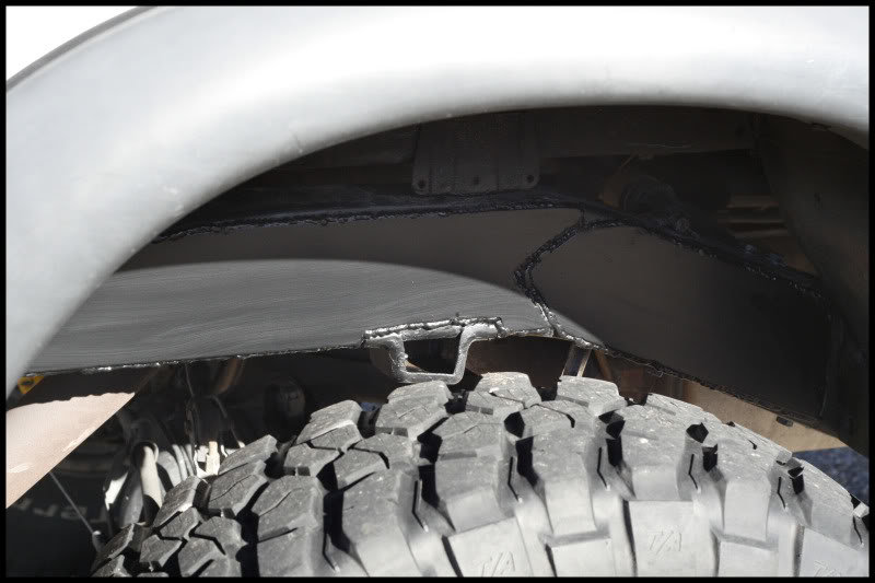

    tubbed for 35`s on Friday, but i was out the door for a camping trip so no photos tell now.
    drivers side:
    d1e8729b514015dadc6ed55511d21bf6_zps44c1_de334dd493e94045d07cbb0c61b546fad9f884ed.jpg

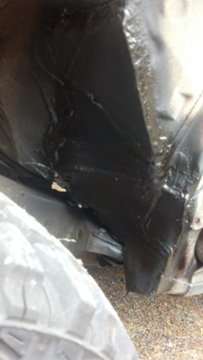

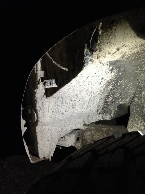

    passengers:
    ae6d8489-43e0-468e-b05c-b9409560b3a5_zps_d0e698af2132138b3ecc3b9100f7f32789ce9aeb.jpg
    187189c2b1e914b94d68d843297a6a83_zpsc229_1d2ea343f3f04daa88a509f006b693cfd7beec64.jpg
    apparently i didn't take a passenger side photo so please excuse the mud from today.

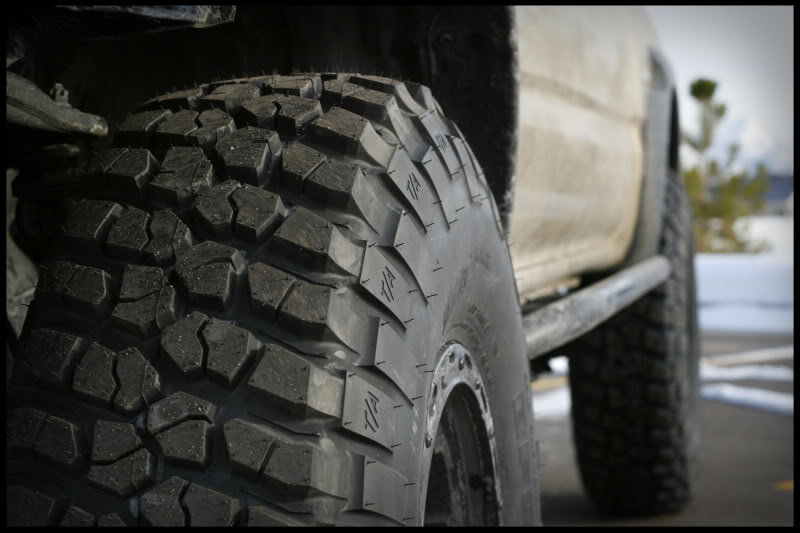

    Here's an example of a Siped BFG KM2. This was the day I bought the tires at Discount Tire and had them siped. As you can see the siping is almost completely invisible.
    But they did open up slightly over time. The photoshopped pic that was posted earlier is more like "grooving" which is done with a hot cutting knife to remove wider sections of tread. That works well on tires with LARGE tread blocks like super swampers. On a tire like KM2's it can cause chunking where chunks of the tread blocks tear away when offroad. Siping is much smaller cuts and it for better traction on wet/icy road conditions more than it is to reduce hydroplaning.
    This pic is several thousand miles later on the same tires. If you look closely you can see the siped edges in the tread.
