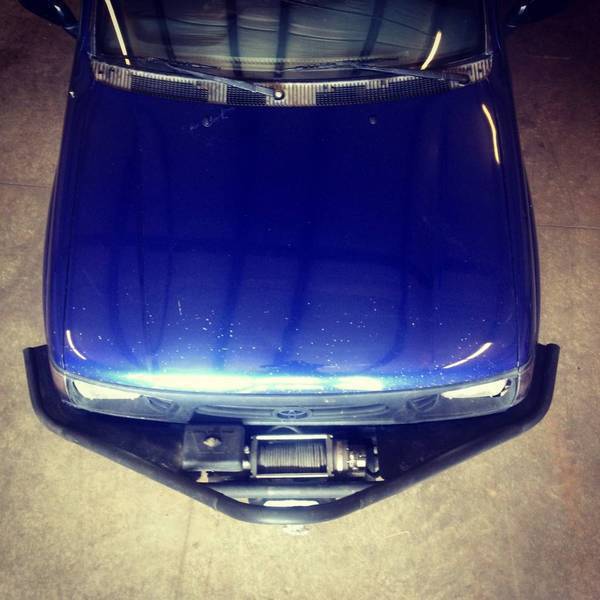

    made fill in plates for my trail gear bumper! got before an after pics on my build thread

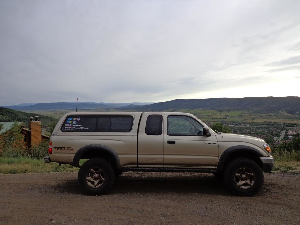

    Turned my Wheeler's 5 packs into 6 packs.

    That is a very nice colour. :)

    Yeah the old man tan, I mean, Mystic Gold Metallic is kinda growing on me. The origianl MGM I guess you could say.

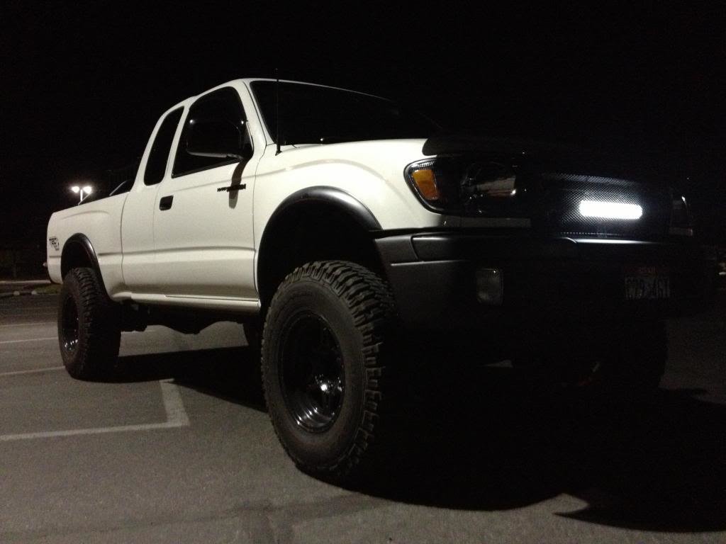

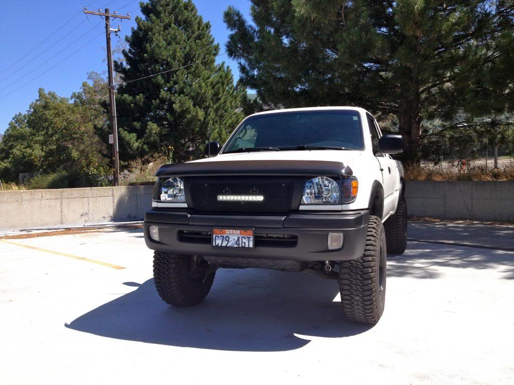

    Finally mounted and wired up the Blitzpro 15S that I won quite a while ago :)

    truck is looking sweet, man

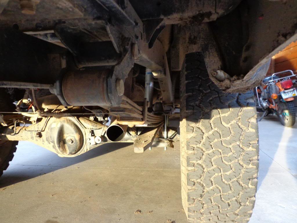

    Question for anyone who has their exhaust hacked after axle: Do you need to relocate the hanger? Or is the pipe welded onto the muffler sufficient to carry its own weight?

    I didn't do anything with a hanger and mine is just fine "hanging" there. It doesn't move.

    I'm just about to do this, I have my templates cut out. I'm curious though, did you weld flush with the top or down a bit?

    Is that the Wheeler's AAL specifically for adding to their 5-pack?
    Does it go on the bottom (above the overload)?
    Also, it doesn't look like you've used a BPV relocate bracket. Were you able to adjust the threaded rod enough instead?

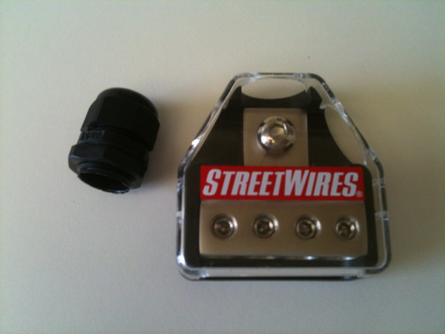

    got a couple more things for the amp install.

    its down a bit. about half way an tacked it on while its on the truck so you know it will fit then take off an wheel an grind haha

    Yes its the wheelers AAL designed specifically for their leaf pack.
    Unless I did it wrong, leafs should go from longest to shortest, so yes, the AAL would be just above the overload.
    And BPV relocate is next on the list. I adjusted the threaded rod all the way up, which worked fine for the 5 packs by themselves (with all the weight I carry) but is probably not high enough now.
