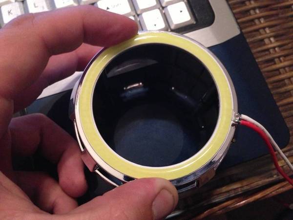

    So I'm entertaining the idea of flush mounting the xb led's and don't know what to do with the tab for the leads. It would be nice if I could move the solder points to the back of the ring and trim the tab off but I don't think that will work. Every write up I've found doesn't show this. Anybody know of any good pictures of write ups that might help?

    Can you dremel a small slot I'm the shroud and maybe bend the tab a little, this is their new xb rings cause mine didnt have the tab

    I can try bending it but this is the tightest that I can bend wires back on themselves so it would have to be one hell of a slot.

    Hmm color it with a sharpie maybe ?

    maybe get some heat shrink tubing and run them on the bottom of the shroud. wouldn't look as clean as inside the shroud but better than seeing white and red wires

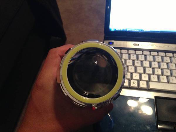

    Heat shrink is a good idea. The pair of shrouds is only $15 so I got the dremel out.. I was going to cut the ridge off and flush mount them but I saw if I left the ridge and notched it I could run the wires back under the ring. Prolly get some black heat shrink and call it a day. Wont even notice if I black everything out too so I may go ahead and do that.

    Everything is looking good! Got mine today too, pumped to get everything together! What should I buy besides some JB weld and black paint for the BHLM? I paid extra for the re-sealer so I should already have that as well. Anything else I'm missing?

    nice. how u gonna secure them, I used clear silicone on mine. I need to put in my new halos. those things are incredibly bright.

    Not that I can think of. The kit is pretty complete! Did you get halos too? Have you started on them? I just need to pick up some jb weld for the halos but besides that everything is ready to go back together!
