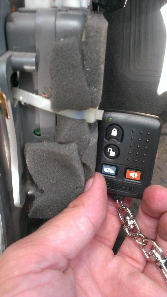

    For anyone who has the stock alarm, and has done the grey wire mod, and has changed out the batteries in the remote, AND still are disappointed with the range...
    I did this...
    And I can now unlock it from inside my house about 25 feet away...

    You could have used bluepearlsharks keyless entry antenna ext mod, i did and i can unlock mine from across the street. It's made locking and unlocking my truck so amazing and didnt cost a dime!

    I did. I have 4ft of wire going up my a-pillar but with a 12 year old remote things are bound to get a little slow.
    I just did it because it was $15 and I wanted a backup anyways! So now I have one and the range is better.
    Win win :D

    With a new remote, what did you do to program it? Or is there not any programming needed?
    I've tried changing the battery and it didn't work, made it worse. I put the old battery back in. The only time my alarm/ unlock key fob ever works is when I'm directly infront of the drivers door and I have to click it about 10 times. It works pretty well if the driver door is already opened, but that defeats the purpose of having it. I'm gonna do the antenna wire "extension" and try a new fob.

    No programming.
    Insert key in ignition, push green button on alarm brain (next to fob in picture), hold for 3 seconds, alarm light turns on, press lock on new fob and it's programmed. Turn off the ignition and then you've got a new fob.
    Took maybe... 1 minute to do.

    Trust me it works, there is nothing wrong with the fob, its the antenna thats run up under the dash and hidden by all kinds of shielding metal and electronics. Cut the tape on all the wires and find the grey wire with black stripe.Very last wire in the corner of the plug. It runs up the wad of wires about a foot and just ends. Pull the A-pillar and you can run a hanger or fish tape down it in the corner of the dash right to the wiring harness. Splice on 4ft of wire and pull up through the corner. Theres wires already running up the A-pillar so i just wrapped the new wire around those and stuffed the last bit up under the head liner.

    http://www.ebay.com/itm/120730235486?ssPageName=STRK:MEWNX:IT&_trksid=p3984.m1497.l2649
    Check the FCC on the back of your remote. I put that in ebay and it came up with this one but double check yours.
    Lol. I did that. Old remote doesn't unlock inside my house. New one does. No problems.
    For $15, skip coffee for a few days and try a new one. It's worth it. Just my .02.
    I have no idea.
    I don't know whether aftermarket "brains" have a programming button or not.
    I know it works with the stock one no problem.

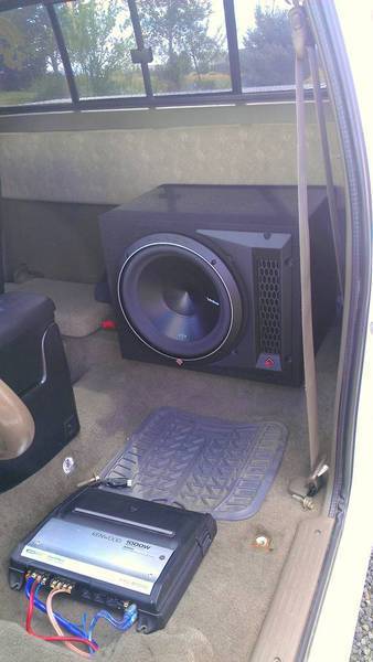

    The Yota is throwin out some bass now! :D
    The old system:
    MTX 10" w/ Audiobahn A4004T amp
    The NEW system: :cool:
    Rockford Fosgate P3-12" w/ Kenwood 1000w amp
    (Note: I need larger amp to power this P3 beast to its full potential)

    Ha ha! It IS quite large! But the sound is well worth the space lost back there! :D The 10" didn't put out even half what this 12" does!

    Is your sub taking up the back seat? i want to put a sub in mine but I kinda need all the room, i was trying to find a way to put the sub between the seats but havnt came up with a good idea yet
