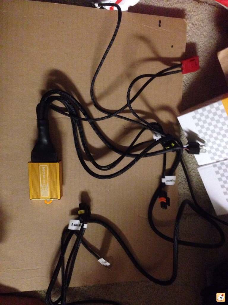

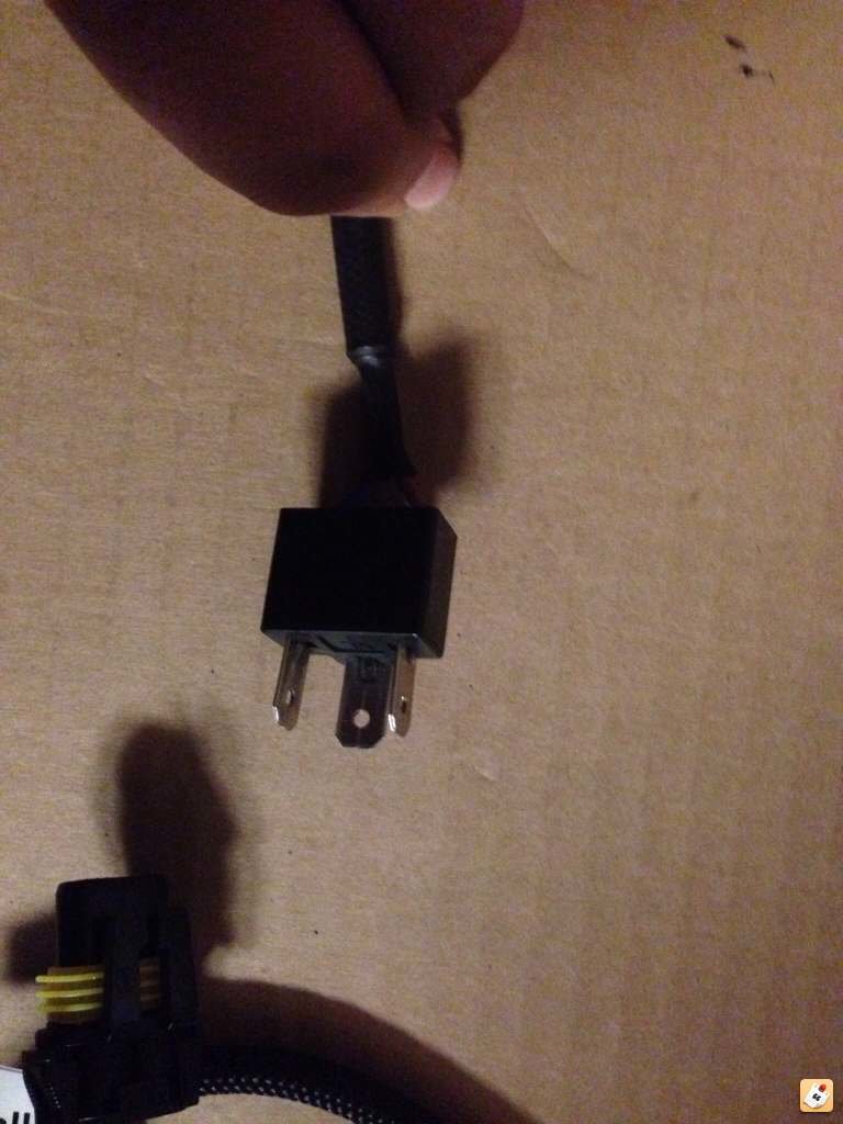

    Finally got the correct relay for my retros. Got everything ready to go, almost...
    1 question.
    Where do I plug this lone "male" connector?
    Here's a pick of the relay, hopefully this is the correct one. I was told its the 9003/ H4
    I'm guessing I plug the "male" plug into the driver side headlight plug, the same one that I used to connect to the old bulb on the driver side? If that is the case, will the passenger side connection not be used anymore?

    You only need one connection for hid's. So you use that dummy connector to make your computer think that both sides are being used. That what your bright lights icon works.

    Yep plug it into the driver side headlight plug. Passenger side will have nothing plugged into it. My high beam dash indicator doesn't work though. It will if I plug in a halogen bulb into the passenger side socket, but I don't do that. You can also use a resistor of sorts to get it to work but I haven't bothered.

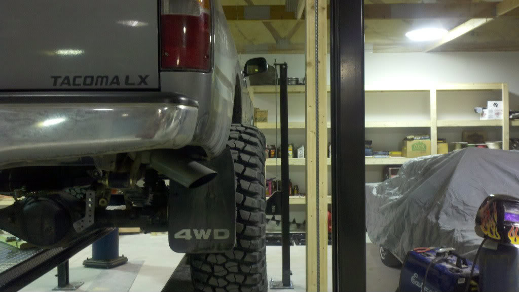

    I took my mud flaps off along time ago. looks way better without them and they rip off really easilly
    I never realized ur tires stuck out that much:eek:
    looks good though

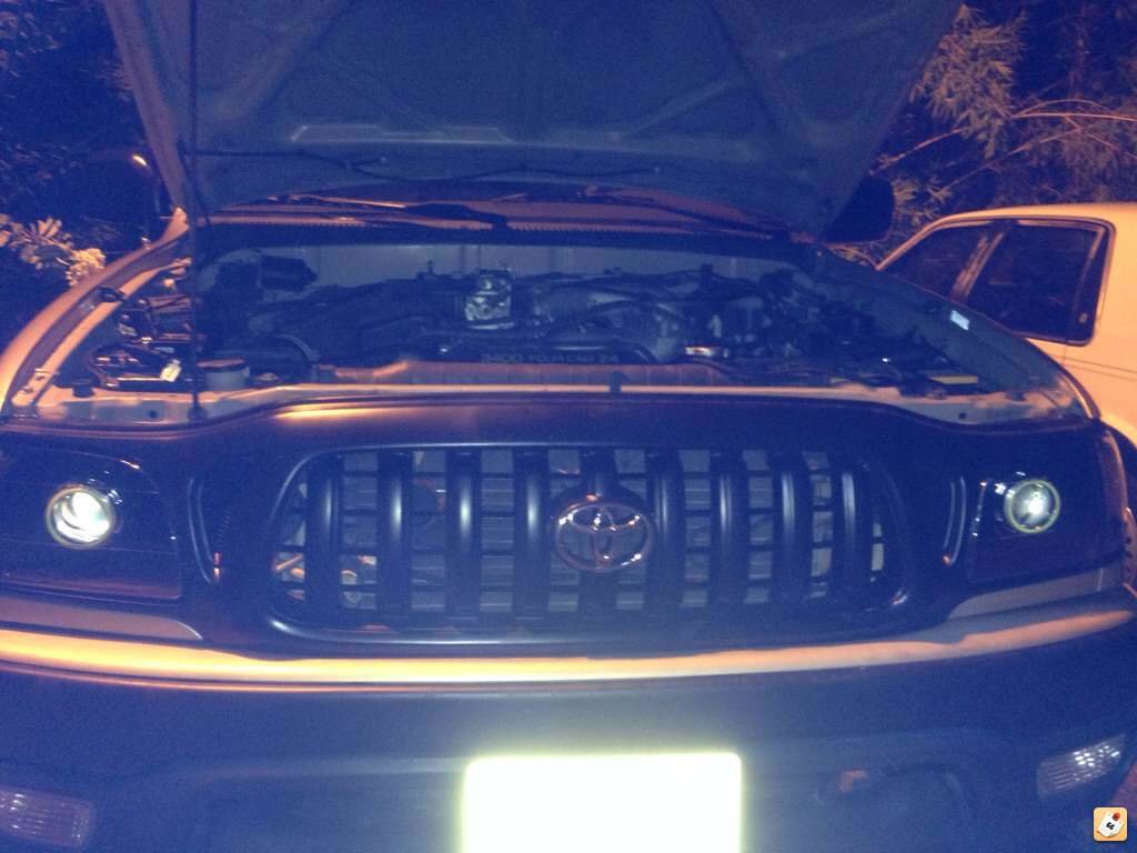

    Finally finished up the Morimoto mini install! Still gotta wire up the Halos but have everything there. Anyone know how to disable the Day Time Running Head lights? I don't want the projectors on every time I'm driving. That'll probably wear them out quick.
    Here's a pic...
    ty6e4upa_63c9334c751831aaa7170c163e9203776c35642b.jpgqapumune_10519b43a853207be636ab3adbedd4f2509df2e8.jpg

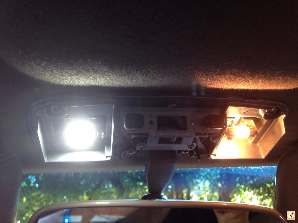

    Also, added some interior LEDs from JumpersLED's.
    ra9a6a8a_35998209b10e77c7dacb025458050ef524ac8d8a.jpgerezapur_47b5e0ec530df46ac2babf43e75c49eb6a9f5c62.jpg
