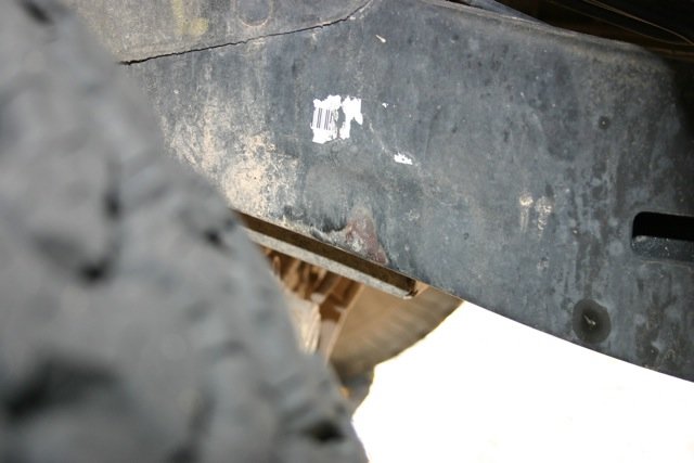

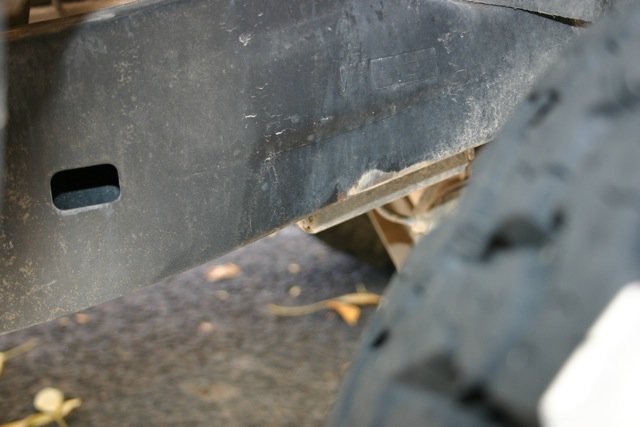

    If all you are worried about is how the inboard side of the tire sits relative to the frame, backspacing is the more straightforward number to care about. A 7" rim with 4.5" BS and an 8" rim with 4.5" BS will have the inboard bead of the tire sitting at the same distance from the frame.
    I'm not sure how you're getting your numbers. Offset is the measure of the mounting flange from the centerline. An 8" wide rim with 0 offset should have 4" BS since the mounting flange is right on the centerline. I may be misunderstanding the definition of centerline and offset.
    Here's where I'm rubbing, driver side:
    passenger side:
