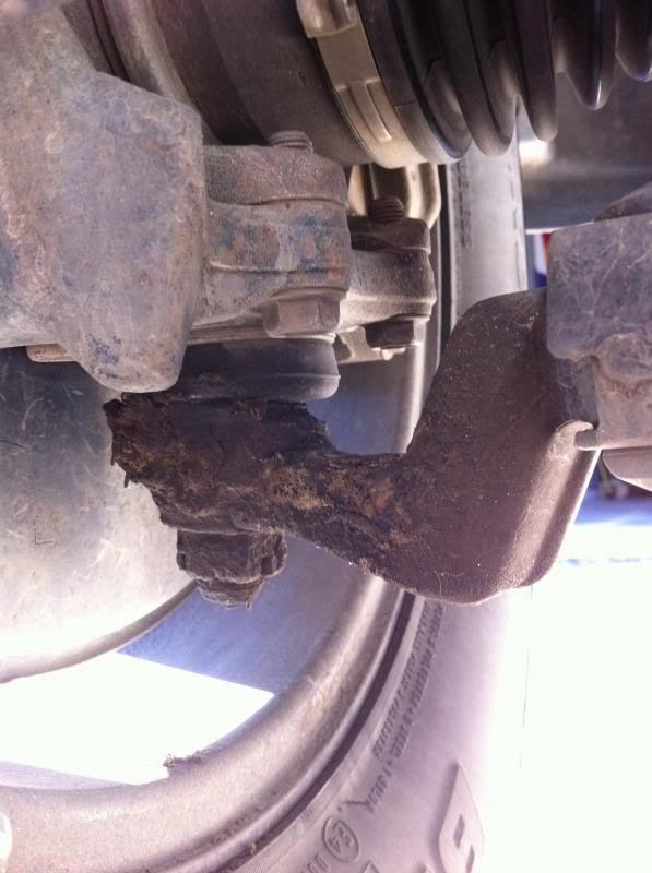

    On my driver's side, there's a lot of gunk build up around the ball joint. Is that bad/leaking? The passenger side was pretty clean and I could see a normal looking bead of grease around the joint.

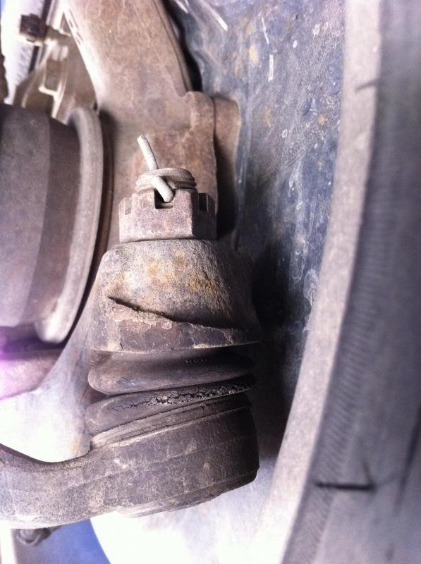

    Secondly, I noticed this boot is cracking on my passenger side thingamabobby. It's the piece that comes out of the steering gear and connects to the wheel assembly via a nut and cotter pin. Should I be worried about this thing? And could you tell me the real name of it? :)

    Pretty sure the boot for your LBJ is busted/cracked. I'd just check it periodically, add some grease and make sure there's no rust or debris in there that could wear out the ball joint faster.
    Other part is the tie rod end. If your alignment and steering feels fine, I wouldn't worry about it.

    Outer tierod

    I don't know if yours is long gone or if it was just newer models had this secondary boot to keep crap out of the LBJ

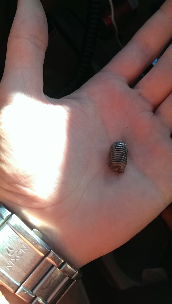

    I carry this with me:
    To remind me of this:
    Needless to say I check those bolts regularly now...

    Most if not all LBJ boots have a hole to release grease when theres too much pressure on the boot. Its not a big deal if you lose some grease

    Mine has those protective covers over the boots too. I think Toyota added them when they did the recall.
