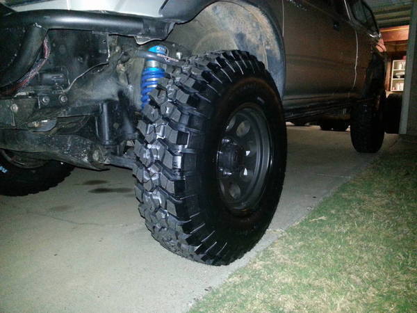

    Installed my new BFG 255/85-16 MT today.

    Jesus... What's the tread depth for those things when they're new?

    18/32nds for that tire size. Mine were 20/32nds new.

    Yeah, who knows. I was just going off of the site haha
    Wonder what mine were at brand new...
