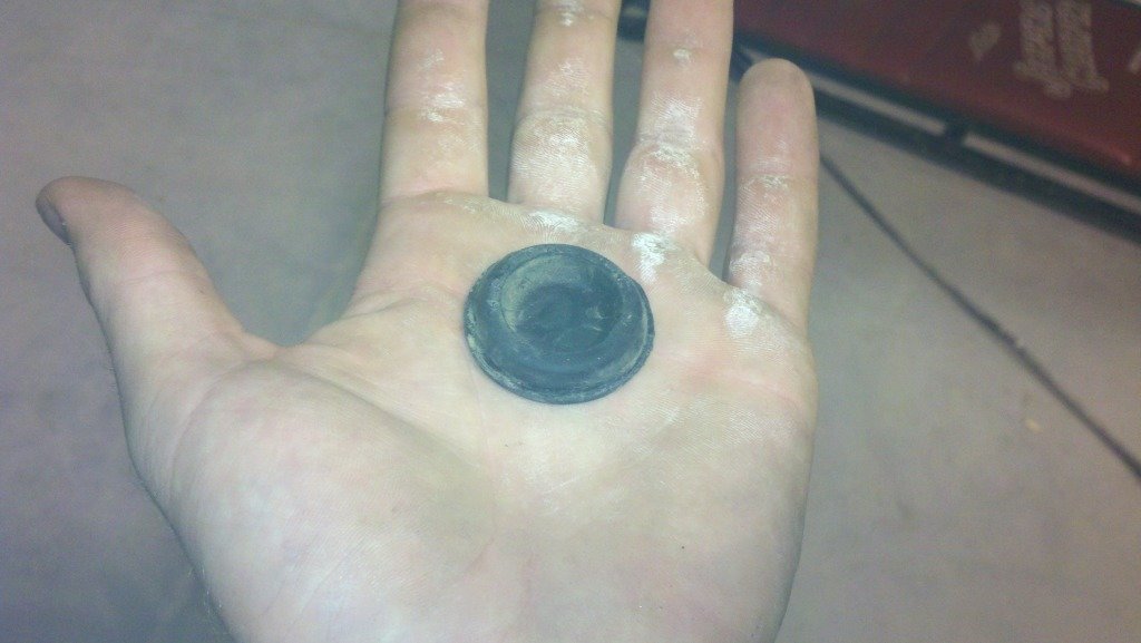

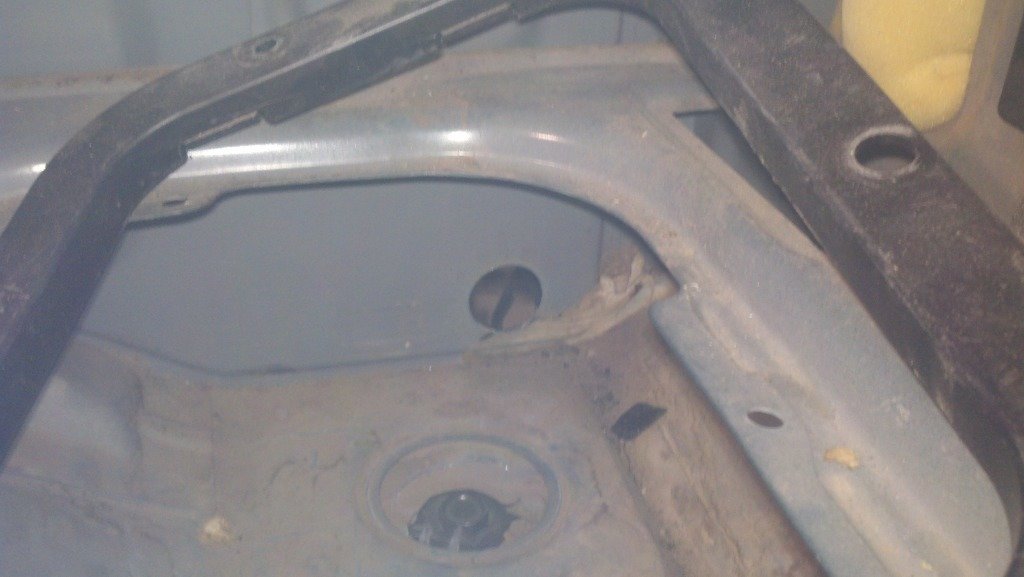

    And Brent I know there's one under the passenger side because my carpet was always wet, and when I was investigating, I found the grommet just hanging in the hole. Wasn't seated at all! Didn't look under the driver side, but I assume there would be one there as well. And you just told me. haha

    Oh sweet that's perfect!

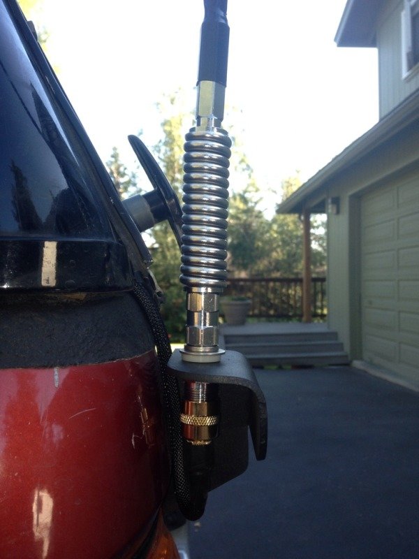

    Here's a pic of it mounted with a shell. It doesn't come anywhere close to hitting it.

    yea those ones..
    funny..hardly any grommet left on my passenger side one..all electrical wires..haha

    x2 on this! Don't listen to the manufactures that say to get medium duty or light duty springs. I'm running a 4' Firefly antenna which is supposed to be very lightweight on a heavy duty spring and it works great.

    id get a spring if you go anywhere at all with trees.
    and if its 5'..your screwed..haha

    Get one anyways I have a 4' just like yours and the spring has helped a ton!
