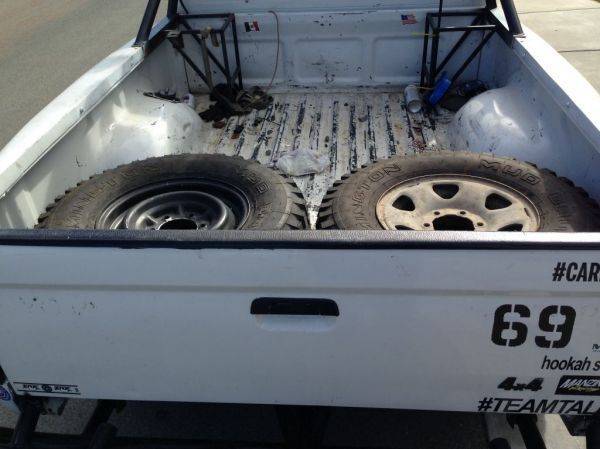

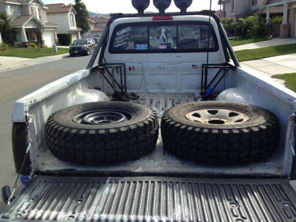

    Went out last night to mess with the new lights
    Also trying to figure out my spare tire situation, here's one idea I've had so far

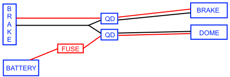

    Interesting conundrum. Yeah, I would start by pulling that tail light and seeing if those two wires (with fuse) go to the brake light or not.
    If they do, and it were me, I'd clip off the topper harness and wire wire it using Quick Disconnects (QD):
    That way the dome light is hot all the time and you can turn it on/off whenever. It's ok that they share a common ground, less wiring you have to run if you just pigtail them together. Need to pull the topper off? Two disconnects and ready to go. I had to do that just last week to run new weather stripping.
    There's a fuse on my canopy brake light as well. It was there behind the brake light when I bought the truck, so I just left it. Seems a little redundant since the brake lights are fused anyway. So maybe your wires go to the battery and not to the brakes after all. Only one way to find out!
    So many variables right now... :)
