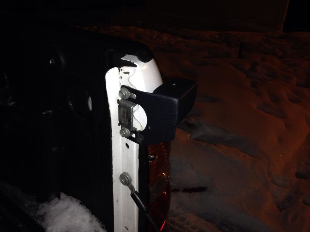

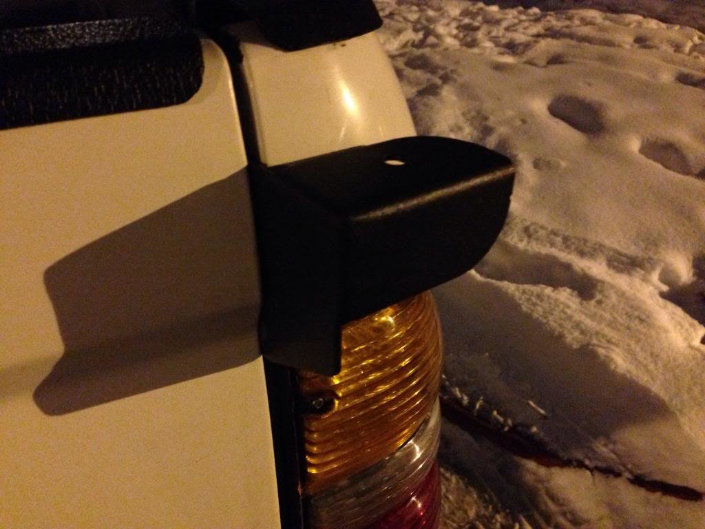

    Painted and mounted my BAMF cb mount!! :D

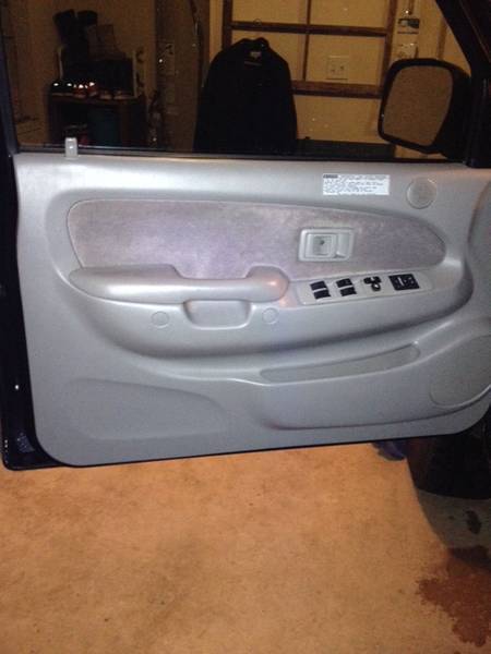

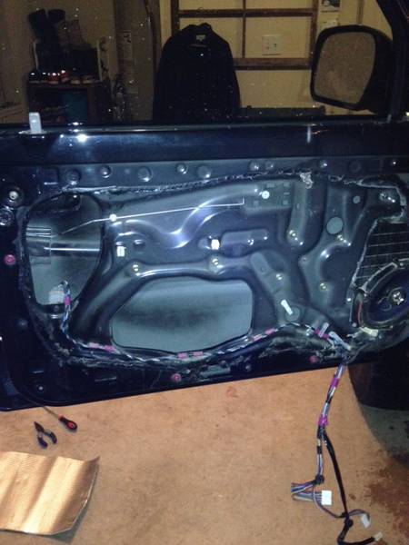

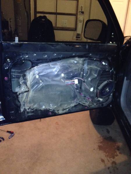

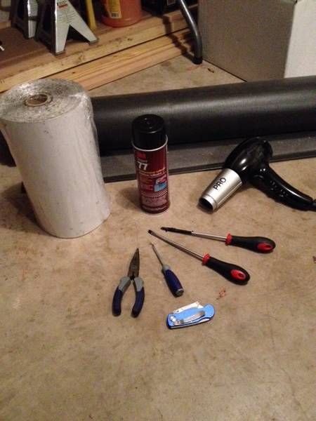

    All I got done tonight was the front doors. It went relatively quickly (about an hour and twenty minutes including clean-up). I will probably just do the back doors on Sunday afternoon, and wait yet another week to do the rest of the interior. Also, I may have to order another 13.5sq ft roll of V-Comp. Not sure just yet. Here are some pics:
    All the tools/supplies I used:
    With the door panel off:
    Took the plastic dust liner off and wiped it down/dried it off:

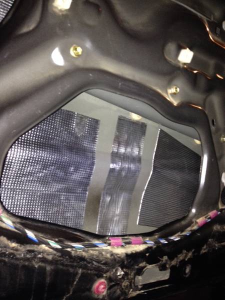

    Cut some of the B-Quiet Extreme into tiles for the outer door skins:

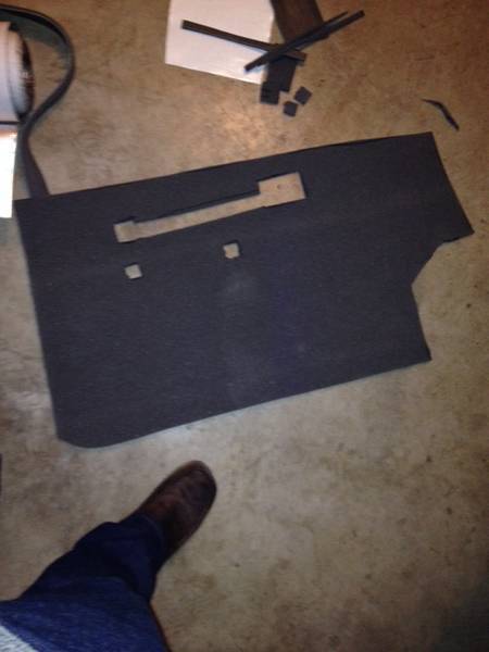

    Got my V-Comp sound barrier cut out for the inner door:

    And the door panel back on:
    I haven't driven it as of yet, and don't expect just a night and day difference as far as road noise goes, but I did sit in it and listen to some music. I will definitely have to make some adjustments to my levels because the front door speakers come through noticeably louder! So this may bode well for when I get the whole thing done!

    It'll make a big difference.
    It's probably too late now but you should put a 6x6" piece of that sound dampening material (V-comp) directly behind your speaker, on the outer skin.
    It cuts down on the back wave created by the speaker and really tightens up the mid ranges.

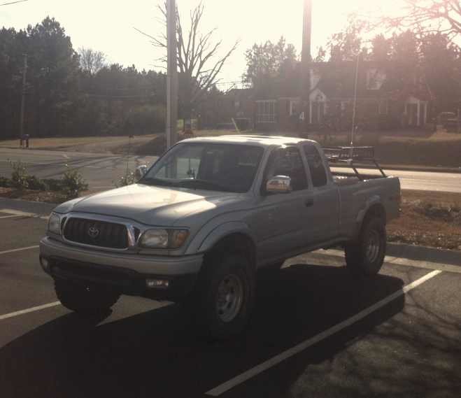

    Installed my cb antenna on the rack. Still not sure if I like the location and might paint the bracket black to blend in a little. Should be able to mount the cb and run the coax for it later this week.

    Nice, did you just use spray adhesive to stick the v-comp ? I'm on my phone so the pictures didn't load
