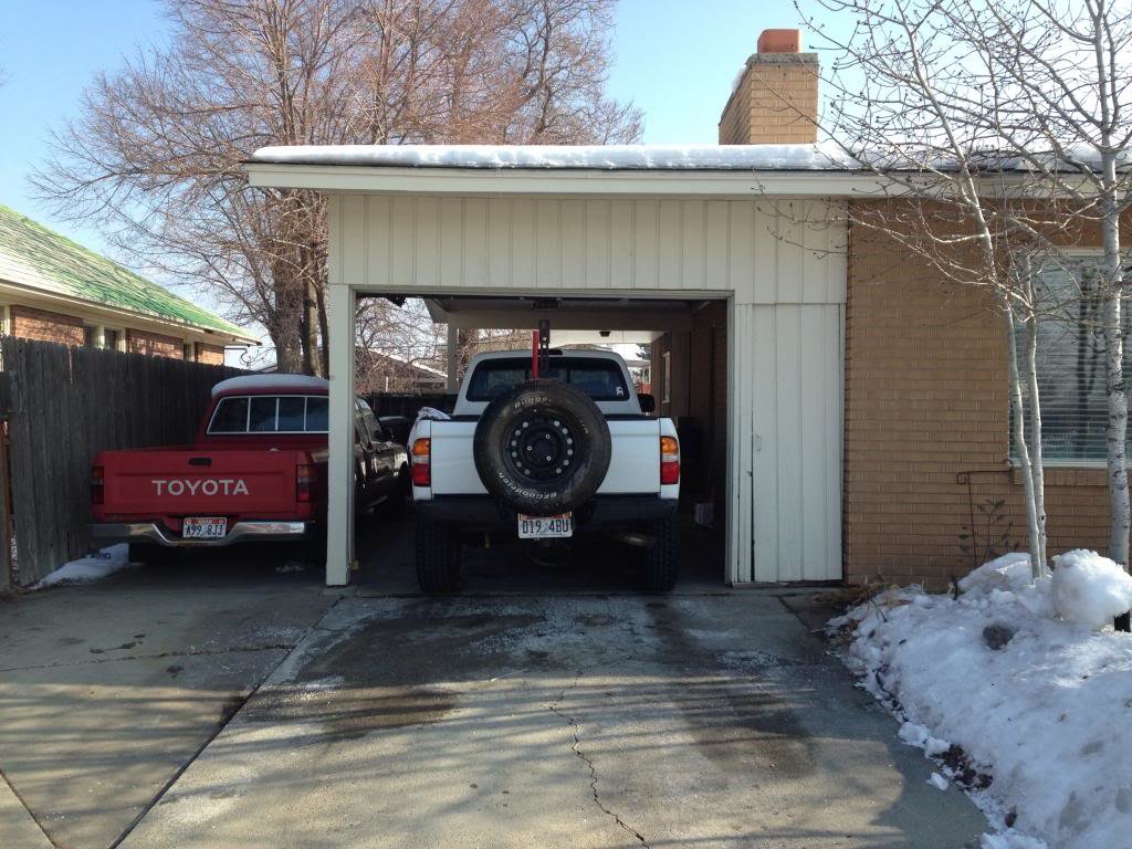

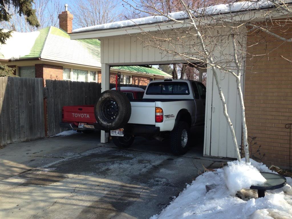

    Got my tire carrier all buttoned up!!

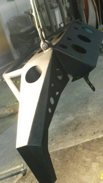

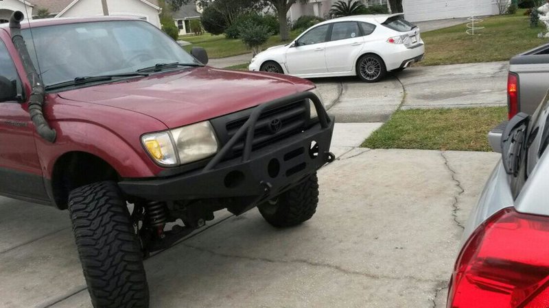

    Finished welding and painting my relentless bumper

    Looks awesome. Can't even start on mine since I didn't get the end plates yet!! Frustrated :mad:
    Tempted to just try and cut some out with a cut off wheel. I want to get this thing done before my break is over.
    How much did you end up cutting off the frame? 3" exactly? How precise does it need to be? And caps flush with the end of the frame or sticking out half way?

    I did 3" exactly on the top of the frame but I didnt follow any line so I might have had a little less cut off at the bottom. I noticed I cut more off the pass side so I have to space my bumper off the frame with some washers to make the bumper sit even. Also I might have put the plates in a little out of square because the bumper angles back a little and leaves an increasingly bigger gap between the fender leading back to the wheel. And I did the plates flush with the frame. All in all take your time and dont rush. Its gonna take you 4-6 hours to get it all tacked up if youre working alone

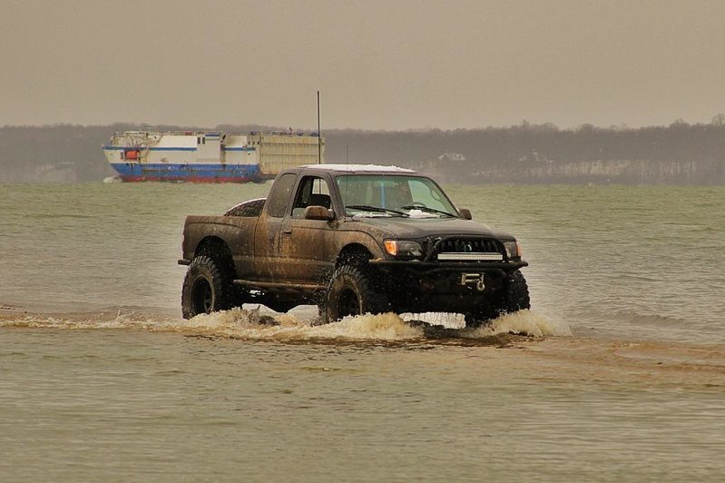

    Hey PC, Is this your truck?
    Trying to get the specs on the wheels. If it is, I found your build thread. just need to confirm

    Looks good. I would have mounted on passenger side to offset the weight of the fuel tank.

    Thanks bro, i was digging around and realized it wasnt PC's......Thanks man

    No problem! Cody's truck is by far one of my favorites on here

    Haha thanks man, it's centered,

    Crazy from the other pic it looks like its on drivers. Ok well never mind.
    LOOKS GOOD:eek:
