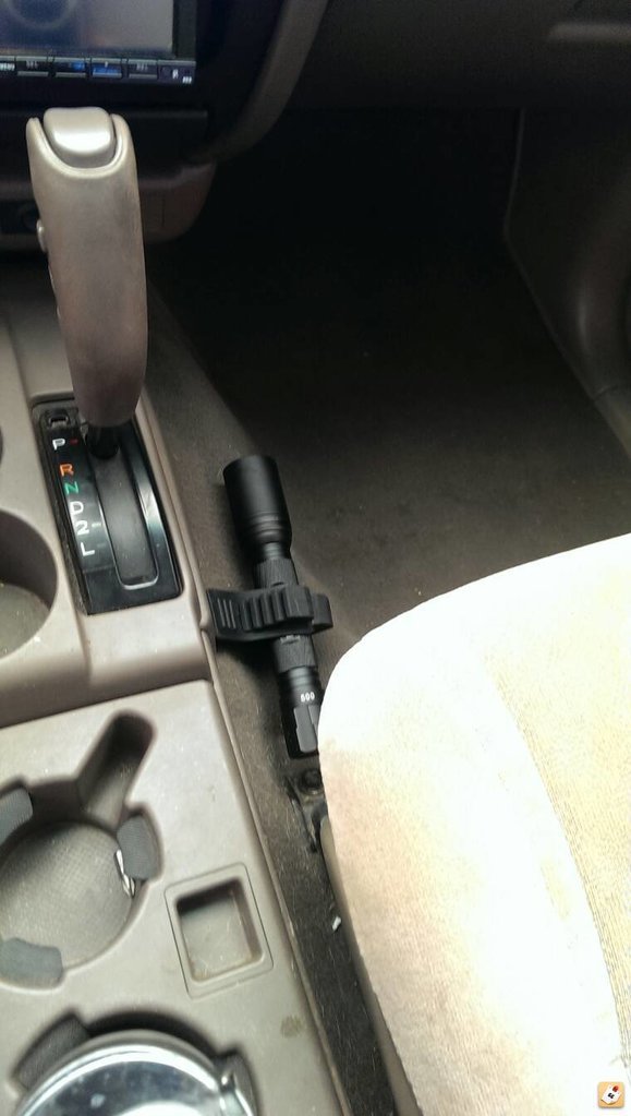

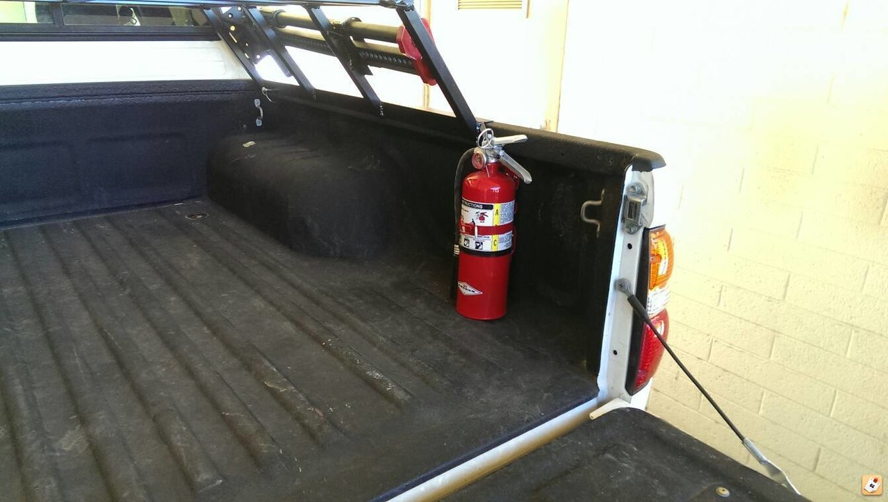

    Peep the build
    new pioneer speakers, Mounted a fire extinguisher in the bed and a flashlight with a quick fist in the cab3uqe6yby_3ddf9dc72a8728fed6016af829d427d7869f27da.jpgahe6a2ej_debc9ee067163a5ab41d54d4851eee2ed7a2b604.jpg

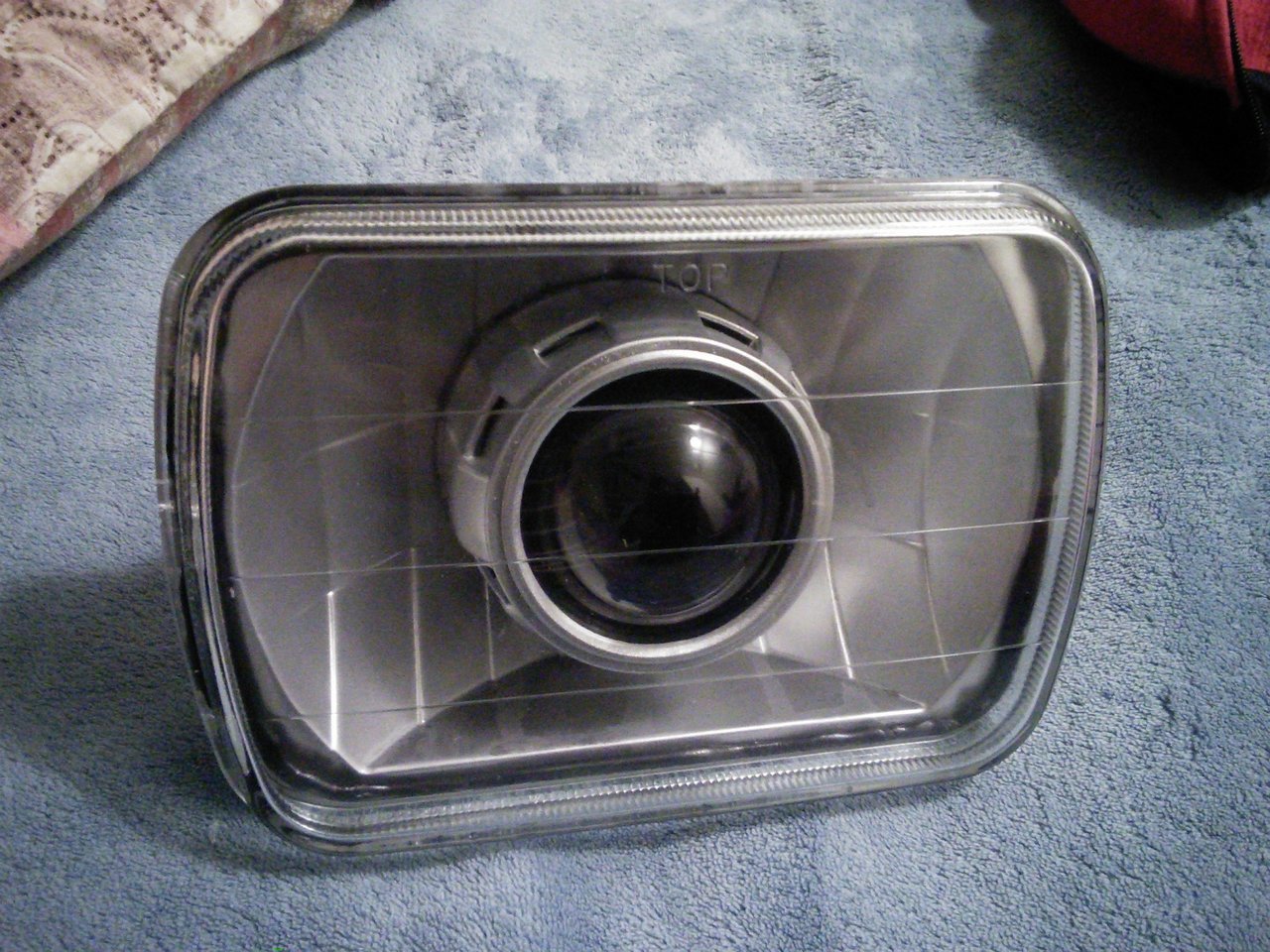

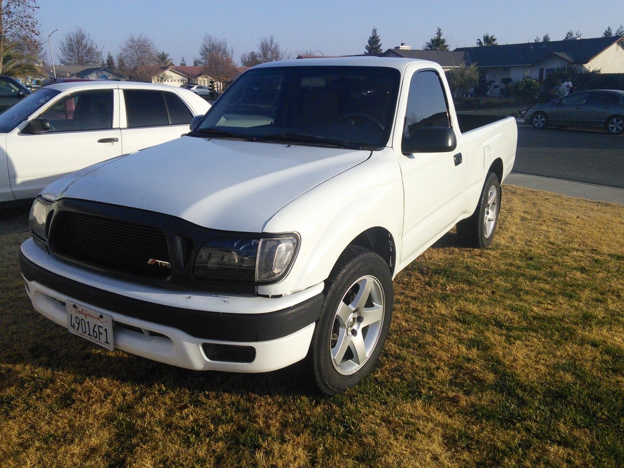

    Dodge charger stocks, Falken Zeix tires, plastidiped billet grill, TRS Morimoto Mini's with Gatling Gun 2.0 shrouds. alpine subs and amp, kicker door speakers, sticky antenna.
    Dads new retrofit, and then mine :)

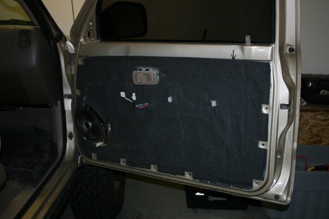

    take the sail panel off.
    Remove armrest screws.
    Remove door handle screw.
    Slide to unlatch the door handle.
    Pop the electric window/lock panel at the leading edge, slide forward to remove. Unhook the 2 wiring harnesses (if you have pl/pw)
    Pop the 9 panel fasteners. (2 towards the dash, 4 along the bottom, 3 along the outer edge of the door) Fastener locations are where the little squares are cut out from the sound proofing material:
    Tilt door panel ~30 degrees up from the lock tab and, at the same time, angle the door handle and finagle the door panel off.

    Saved me a lot of typing time! This is exactly the way to do it. You won't break any clips if you are somewhat careful.
