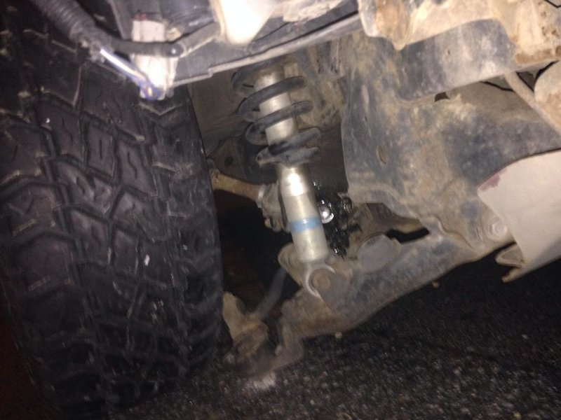

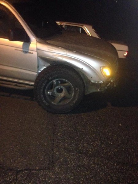

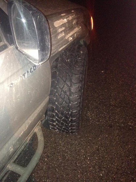

    i have thought about selling my taco today... then decide i have to think of it my abusive lover and ill keep coming back to her cuz shes sexy. got my already custom fender even more custom. any advice would be amazing in figuring out why this has happened 2 times in the past 4 months!!!!!!!!!!!!!
    4 bolts holding my lower ball point to my wheel assembly have all sheered off TWICE now, which ends up ripping the shit out of my cv axle and crushing my fender. both times it has happened on the same side
  12. Jan 12, 2014 at 5:36 AM
    cdj1
    cdj1 Well-Known Member
    Apr 16, 2013
    #102185
    1,302
    Clint
    Muuurville, TN
    97 Tacoma
    King Extended travel coilovers, 5100 Shocks, Daystar shackles,OME Leaf Springs,255/85/16, front diff drop, RAT skid plates, 4.56 gears, LSD in rear, Aussie locker in the front, Front Range Offroad twin sticks, trail gear/ Bash Fab rear bumper, elite off road front bumper and sliders, warn m8000 winch, in cab winch control
    Are they OEM ball joints and did you loctite the bolts in? Most of what I have read here is they loosen up, one falls out, the rest shear.

    Need to use lockrite. 45ft/lb per bolt.
    Usually takes two to fall out then shears two. I still only have three in my driver side on Frankenstein from when my sheared. Haven't had time to fix it
