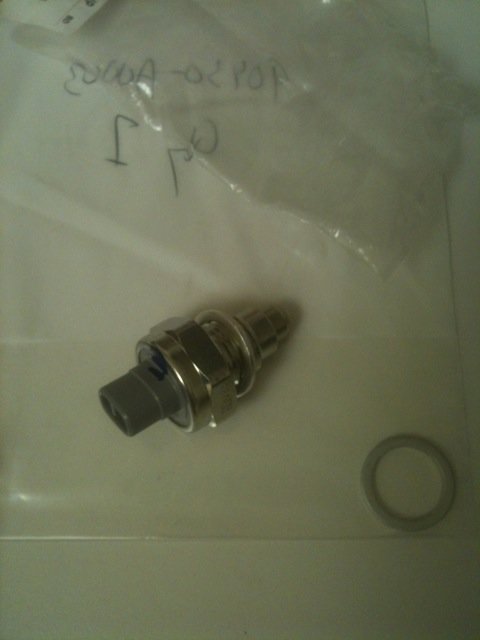

    Got a new back-up switch so I can see my awesome LED back-up lights again:

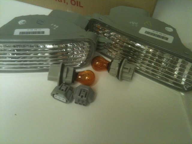

    And some parts to start my blinker relocation:

    I thought you were relocating them into your corner lights? Why the extra set of OEM turn signal lenses?

    Probably should've asked around here if anyone had extras they wanted to part with. They are getting cut up to use the bulb assembly mounts.
    Still have to track down the electrical connectors for the harness plug. Re-thinking purchasing an extra set of corner lenses so I can make sure it'll work before cutting up the ones on the truck.
    Edit: What Brent said except I'm going to put them where the stock parking bulb/harness mounts and completely remove the current parking lights. The turn signals are dual-filament. Not sure why they didn't come with them wired to handle both parking and turn signals from the get-go.

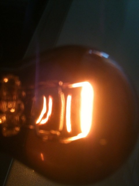

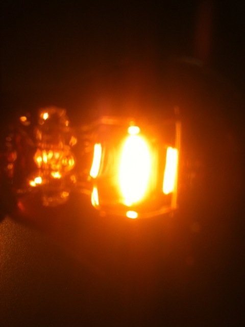

    Turn signal filament:
    Parking light filament:

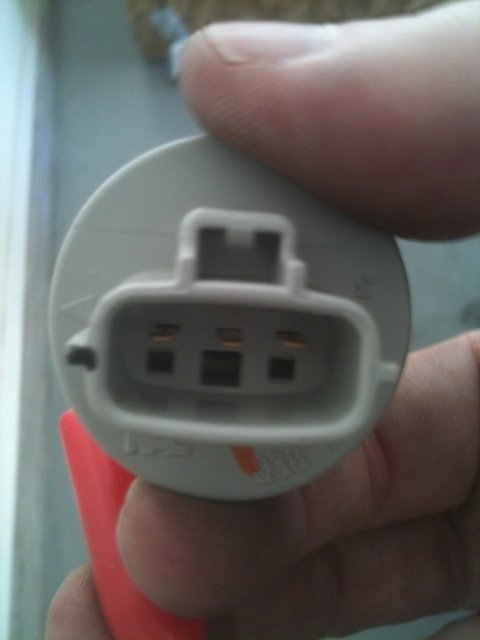

    Connections go Ground, Turn Signal, Parking, Left to Right:
    My only concern right now is having enough breathing room around the bulb. That's why I'm re-thinking ordering a new set of corner lenses so I can test it all out before ruining my only corners.

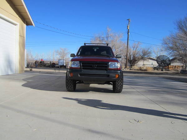

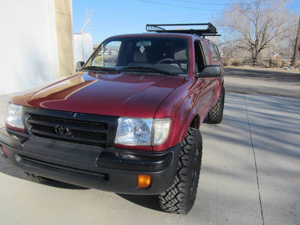

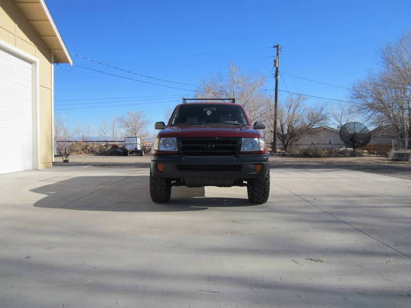

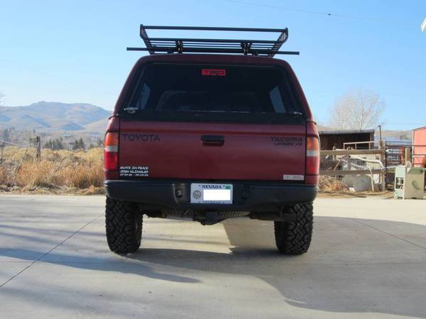

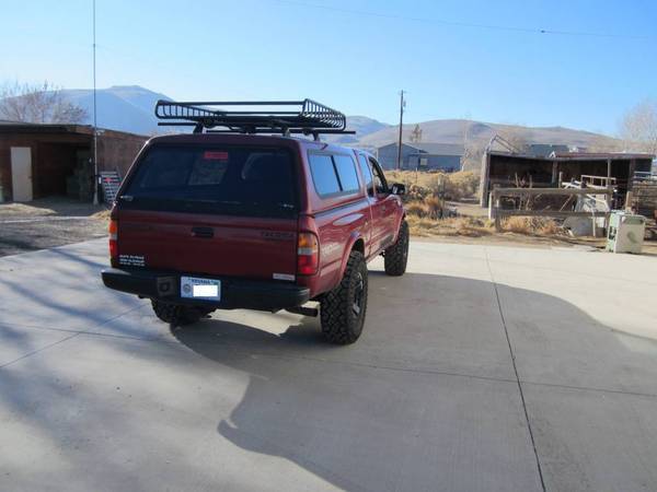

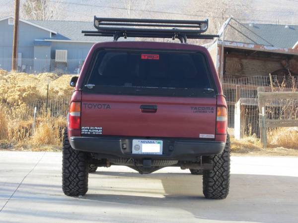

    Good news, got my 1.5" Spidertrax Spacers on today, made a huge difference in stance and got rid of the frame rub. Bad news is my suspension is pretty much toast and I'm gonna need that OME setup before I can afford it. Here are a few pics.
    Before:
    After:
    Before:
    After:
    A couple different angles:
