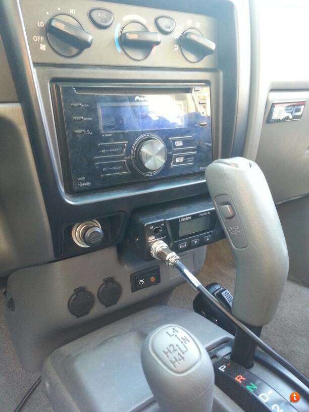

  3. Jan 17, 2014 at 2:42 PM
    MatthewMay1
    MatthewMay1 I'm an amateur professional.
    Nov 21, 2011
    #67486
    11,107
    Matthew
    Lone Star Republic
    Supercharged '01 TRD
    This is how fqr my cb sticks out with the 90° adapter in the back. No modifications to air duct. Also snapped a photo of what u cut behind the radio. tysyqade_f91535fa440403d000608e987b77e81877f54e82.jpgytevuqur_3955d3e98d3a2a2209aeaa161100555bfb8f8390.jpgsuqa4u6a_4c43fb3a808404d889b654cb50bd92b3887bc8bd.jpg

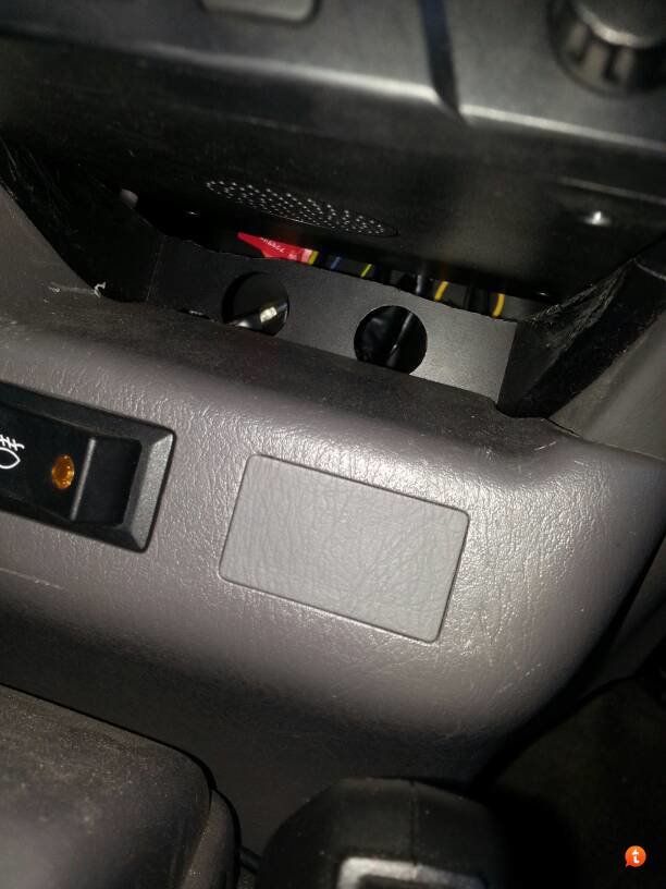

    Kennyperez
    Kennyperez Well-Known Member
    Apr 17, 2012
    #77104
    608
    Kenny
    Yucaipa
    Tundra
    This is where I have my switches.. I now have two in there one for my 50" one for my dust light

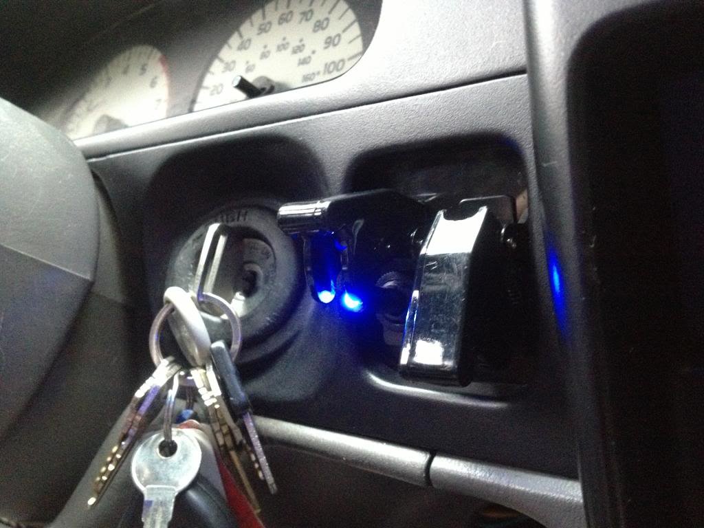

  9. Jan 17, 2014 at 4:31 PM
    cynicalrider
    cynicalrider #NFG
    Jul 25, 2012
    #83399
    17,147
    Jersey
    01 SR5 TRD 4x4, '23 Bronco Wildtrak, 2017 HSQV FE350
    Drop bracket lift and booger welds
    Learned something new today. :cool:
    Also clock location switches ftw:
    When I get a winch I will wire the switches to the center console.

  11. Jan 17, 2014 at 4:42 PM
    Cohbsteq
    Cohbsteq Hood Rat
    Oct 27, 2013
    #115350
    4,316
    Jacob
    SL,UT
    02 Supercharged 4x4
    Pretty much stock with some crap welded to it.
    So how are you guys mounting your CB in that spot?? I'm genna cut mine tomorrow but what kind of bracket system are you guys using??
  12. Jan 17, 2014 at 4:44 PM
    PcBuilder14
    PcBuilder14 Well-Known Member
    Jun 19, 2011
    #58522
    23,312
    Brent
    Nor Cal
    2018 Tacoma TRD Off Road 4x4
    Here's what I cut on the back, I still need to try to push some stuff back to get it to fit a little more flush. No bracket needed.

  14. Jan 17, 2014 at 4:48 PM
    PcBuilder14
    Jun 19, 2011
    #58522
    23,312
    Brent
    Nor Cal
    Pretty much haha works better if you have a 90 degree elbow for the coax plug so you can push it back farther.

  15. Jan 17, 2014 at 4:51 PM
    Cohbsteq
    Cohbsteq Hood Rat
    Oct 27, 2013
    #115350
    4,316
    Jacob
    SL,UT
    02 Supercharged 4x4
    Haha alright! How are you getting that middle section of the dash out? Anything I should know or is it just some screws?
  16. Jan 17, 2014 at 4:56 PM
    PcBuilder14
    Jun 19, 2011
    #58522
    23,312
    Brent
    Nor Cal
    Screws. Many said it was easy, but my screws were in there good. But I was able to get it out eventually. The. Just cut the back off and you should be good to go. Many people have heated up the a/c duct to push it back some to make the cb set in flush.
  17. Jan 17, 2014 at 5:00 PM
    PcBuilder14
    Jun 19, 2011
    #58522
    23,312
    Brent
    Nor Cal
    Yeah, many people have used stuff to secure it as well. Mine has done pretty well and not moved around at all so far unless I physically pull on the radio.
  18. Jan 17, 2014 at 5:07 PM
    taco47001
    taco47001 Newborn
    May 11, 2012
    #78644
    1,907
    Aurora, IN
    LX470
    Zips ties. Use a heat gun to soften the air duct behind the console and flatten it just a tad so the coax 90 can slide a tinge further in…results in flush mount.
  19. Jan 17, 2014 at 5:08 PM
    PcBuilder14
    Jun 19, 2011
    #58522
    23,312
    Brent
    Nor Cal
    What did you use to push the ducting back after heating it? I need to do this at some point.
  20. Jan 17, 2014 at 5:09 PM
    taco47001
    taco47001 Newborn
    May 11, 2012
    #78644
    1,907
    Aurora, IN
    LX470
    I used the handle end of my east wing hammer.
