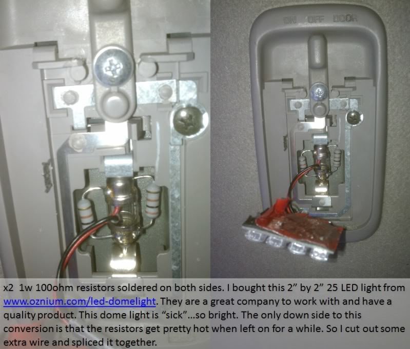

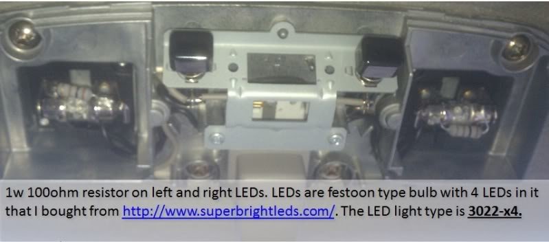

  13. Jan 21, 2014 at 10:45 AM
    PcBuilder14
    PcBuilder14 Well-Known Member
    Jun 19, 2011
    #58522
    23,312
    Brent
    Nor Cal
    2018 Tacoma TRD Off Road 4x4
    You must wrap/solder resister on the connections like so for them to work like the stock bulbs.

    The wiring isn't messed up haha you just have to add the resistors.
