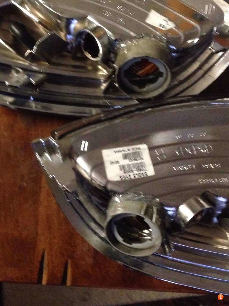

    Did the blinker relocation mod, put it in the running lights housing. Got tired of driving around and having to hear the blinker flicker 10 times per second every time I made a turn.
    If you don't have a drill this can be done. I have very few tools at my apartment and didn't feel like driving to my storage unit. Anyway I used my big hand held recip. saw to cut the mounts off the old blinkers. Then I used a hammer and nail to slowly make somewhat of a circle on the back of the new blinker housing. Epoxy'd it up and it's all set. Works as it should!
