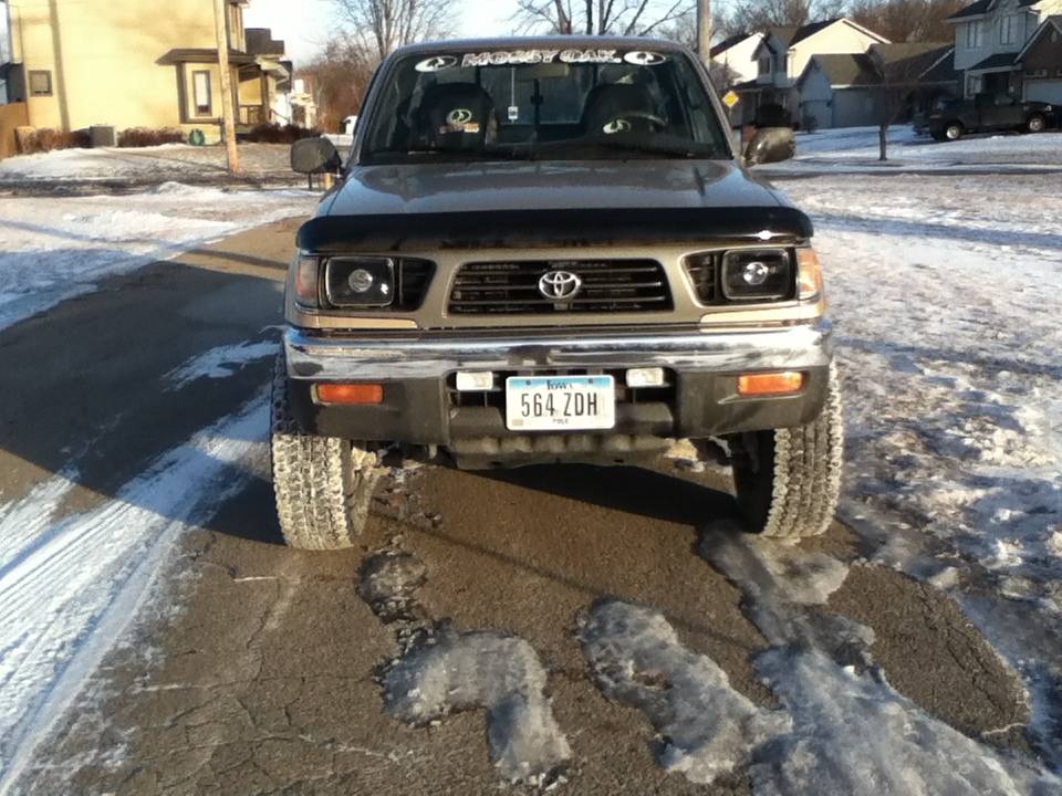

    Had those on my 96 1st gen. They were honestly very bad... A black housing with an ebay projector.

    My buddy got some similar to those for Christmas. Not real projectors, the sides are open

    That doesn't matter. The side of mine are open to. It's the shroud that makes it look enclosed.

    But his have no shrouds. Just plastic pieces that go from the housing to the "projector"

    I know, I've had those lights. But shrouds aren't needed. They're for looks more or less. I was just explaining that the sides being open doesn't matter. It's the quality of the projector.

    Oh ok. I figured they were closed so the beam gets pushed through the projector and not dispursed

    The other issue with those projectors is the fact that the bulbs still move to dictate the high and low beams.
    Where true projectors use a cutoff shield.

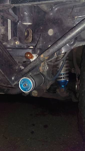

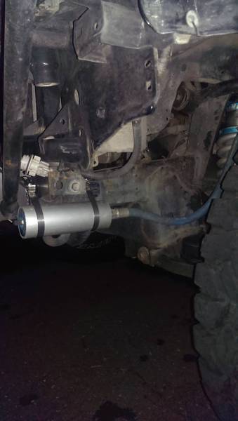

    Finally mounted my resi's there not the ideal spot but the hoses are so long its really my only option for now, also working on the blinker to corner light relocation eventually :)

    Run them to the crossmember. That's what I did with my old fox's i had with extended lines. Tucked nicely under the skid

    that was my initial plan but the hoses are a tad too short to get enough resi up there to get a good mount on it, do you mind me asking what length and weight springs you ran when you had MT, i got some used 13" 600# coils thinking they would be enough but theres a good amount of preload and not getting the 2.5" of lift im looking for
