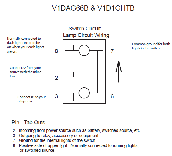

    now when you say to power all your switches, does that just mean if you have a switch with an led indicator on it?
  10. Jan 29, 2014 at 8:17 PM
    PcBuilder14
    PcBuilder14 Well-Known Member
    Jun 19, 2011
    #58522
    23,312
    Brent
    Nor Cal
    2018 Tacoma TRD Off Road 4x4
    Yes.
  11. Jan 29, 2014 at 8:23 PM
    4banger4x4
    4banger4x4 Probably should'nt have done that.
    Apr 24, 2012
    #77528
    2,540
    Eric
    Whorelando, Fl
    bingo i finally understand something about this thing
  12. Jan 29, 2014 at 8:32 PM
    PcBuilder14
    Jun 19, 2011
    #58522
    23,312
    Brent
    Nor Cal
    Haha yeah
    Here's a more in depth explanation.
    The number 8 tab will be ran to a wire to the dash light circuit
    The number 2 tab will run to the 15amp fused wire you were asking about
    The number 3 tab will run to the smaller wire of the two colored wires on the relay box
    The number 7 tab will be grounded.
