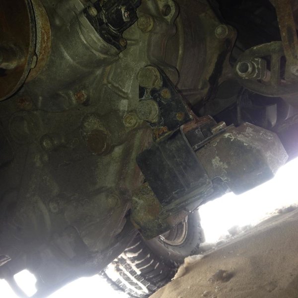

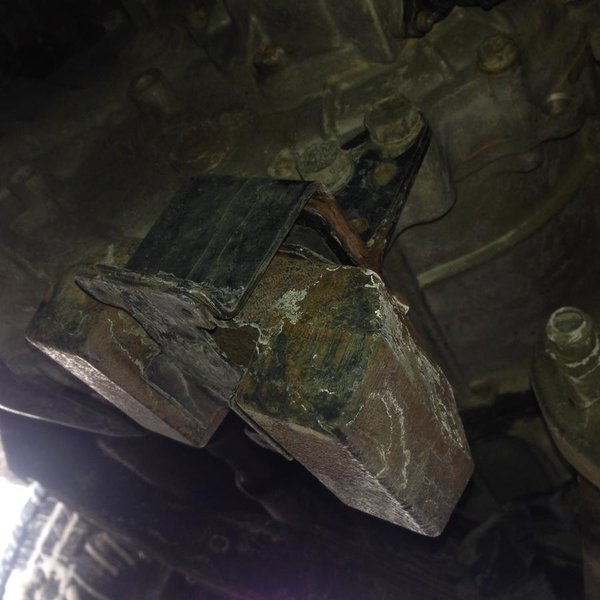

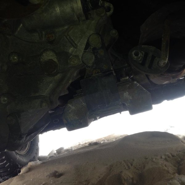

    Can anyone tell me what this thing is hanging off the passenger side of what I believe is the transfer case... It is just a piece of metal mounted down off the side with nothing really attached to it, at first I thought it was a magnet but it feels pretty lightweight...:eek:
    Also, are all of the grease fittings on the drive shaft the same size? I have been unsuccessful in removing and replacing the very rearmost zerk all the way at the end of the driveshaft... I think it was a 7mm socket that fit over the other zerks and I was able to replace those if needed, but that back one.. the 7mm is too big, and the 6 mm is too small, maybe the back one is screwed in too far and the socket wont grab the bottom of the zerk?

    I have that thing as well. No idea what it is haha. I posted about it a few years ago and nobody had a clue.

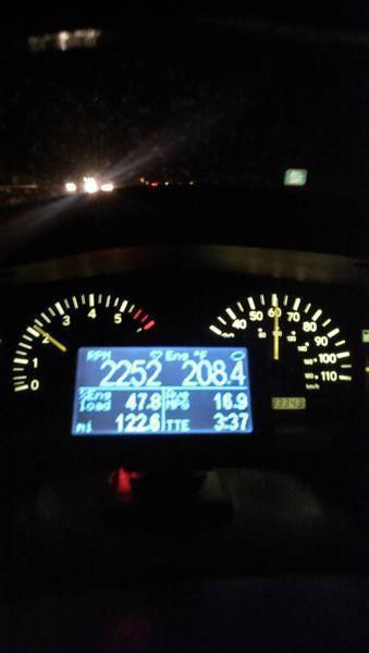

    Mine runs 204-208.4 all day. I saw 210 once but then it dropped immediately.

    Mine runs consistently at 199.4 once it is warmed up. Uphill, A/C on hi.

    mine runs in the 190's
    even had it pegged around 3k in 4Low, trudging through a foot of snow, for quite some time
    never hit 200 or above

    Is there write up to this sacred jiggle valve mod, I've hit 212 for about 30 seconds It runs 203-208

    Big thing is make sure the jiggle valve is vertical (12 o'clock position). If not it can create an air pocket behind the tstat and cause it to open at a deferent temp than it should.
